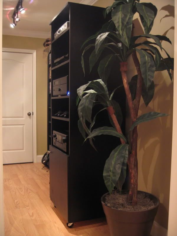

Hey guys, my rack is in no way "original" just a mish mash of other ideas shown here. Thank you to all who posted here before me, there were some great ideas. The Rack is on a pull out slide, and on a lazy susan, so it pulls out and rotates to access the back. The shelves on the side of the rack just lift out and that frees the rack to rotate. The drawer in the bottom houses the iPod dock, and Harmony remote charger and rf extender. Just got a PS3 for Christmas, so that will be replacing my old dvd player. That will still leave a blank shelf for future expansion. Thanks again everyone!
Clever idea on being able to pull the rack far enough to swivel.

Originally Posted by MatrixDweller View Post
PS3's are like mini space heaters. They vent from the from and sides to the back. Do you have any additional fans in your rack?
I have 120MM Computer Fans cooling my rack. There is one on each shelf plus two above the door drawing the warm air out. All but one of the fans is wired to the same power source, which is plugged into the switched outlet on the back of the Denon amp. When the amp comes on, all but one of the fans powers up. The other fan, the one that rests on the shelf with the Tivo is wired to it own power source, and is plugged in and is on constantly. I was worried that the Tivo never powers down, and would alway be producing some heat. This set up seems to be working great. The PS3 gets only slightly warm to the touch, even after playing for hours. The Denon receiver is the major heat maker, and there is no top to the shelf, so with a fan blowing across that and the top fans exhausting the air out of the closet, there is very little temperature rise in the closet even with the door closed. There is a little air gap at the bottom of the closet door to help draw in cool air from the tile floor. If I had to do over again, I would spend a little bit more on fans that were a bit quieter, I got a great deal on fans from Frys, but the do hum a bit. Although from my living room, even with the volume muted, you can just barely hear the fans blowing.
