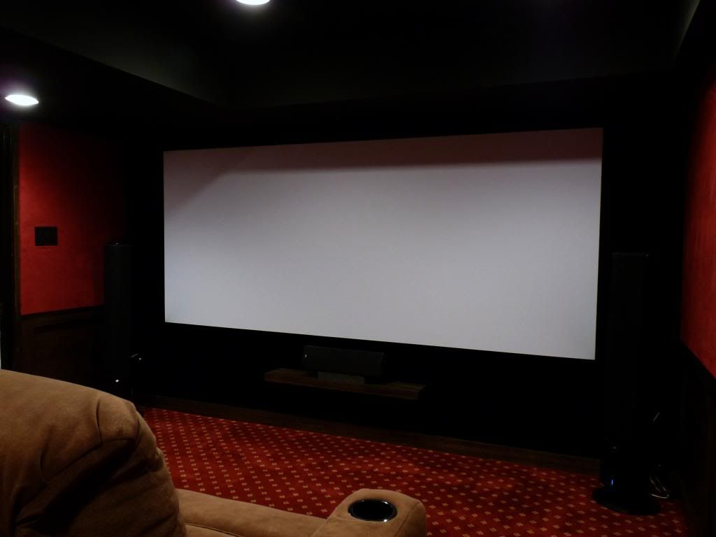

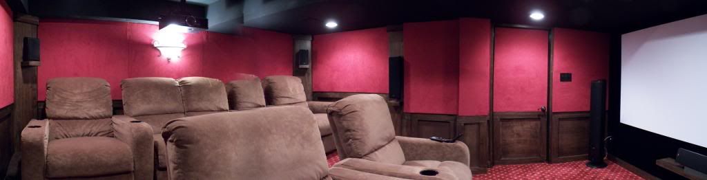

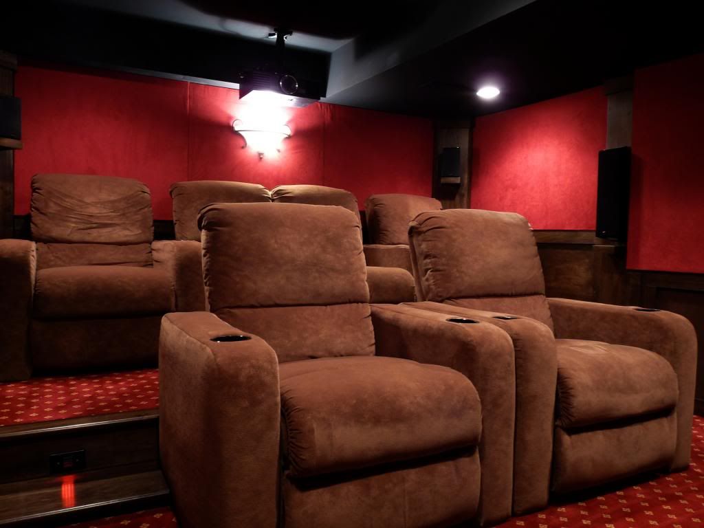

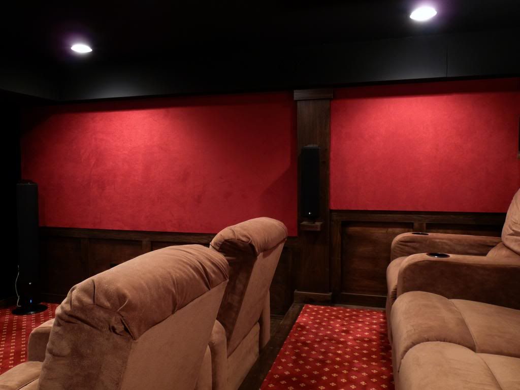

This thread gave me a lot of inspiration that I could have a serviceable theater in my small space so I want to give back now that it is complete.
Stats:
  • Room dimensions are 12’ 1” x 15’ 3” drywall to dry wall (at the widest point).
  • With treatments it is 11’ 10.5” left to right and 14’ 10.5” from back wall to screen or 15’ 1.75” to screen wall (the screen is off the front wall some 3 inches or so).
  • Screen size is 120” diagonal, 2.35:1
  • First row eyes reclined is 9’ give or take an inch or two depending on occupant height.
  • Second row eyes reclined about 14’ 4” give or take
  • Riser depth 6’
  • Riser height 9.75” (I intend to raise the chairs another 1-2 inches as short people have an obstructed view if the front seats aren’t reclined slightly (ideal height for the riser would have been 12” if I had the ceiling height to accommodate it.
Ideally I’d like another foot of riser depth and 2-3 inches of riser height and if I had the money the relocation of the main HVAC lines outside the theater. Riser to soffit height is only 5’ 7”. If I were to build a new theater in the future I’d make sure I had a space at least 13’ x 20’ to accommodate two rows and a false front wall.
Overall I’m pleased with the results given the limitations I had to work with.

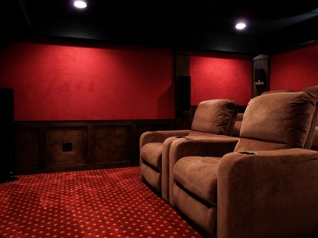

My 14x14 room:
Seat backs are approximately 3ft from the wall. Viewing distance is 11ft. The Suede acoustic panels are covering windows.
The screen is a 148in 2.35:1 Dalite 2.8 HP. Speakers are Klipsch THX ultras (7), PB13 Ultra, and an MBM12 behind seats

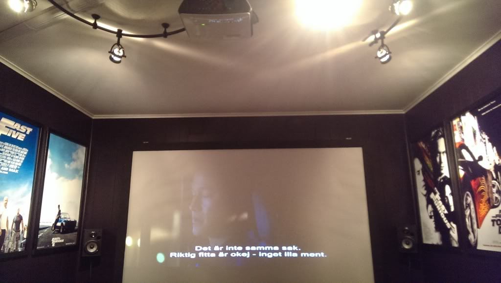

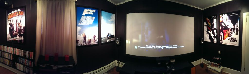

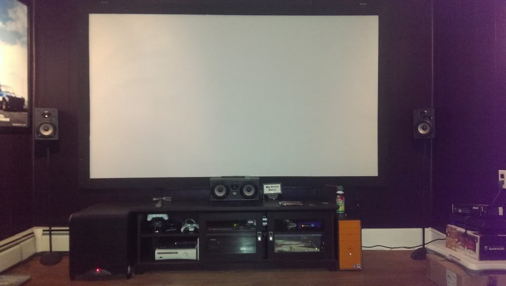

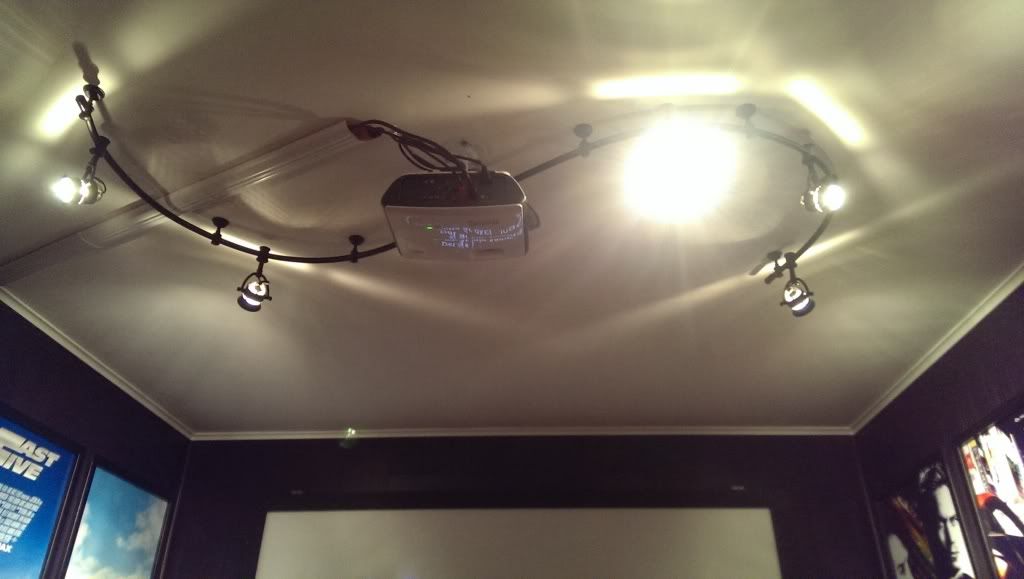

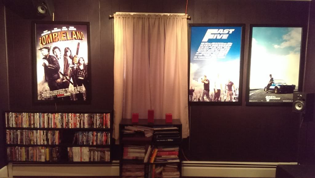

Figured this would be a good spot for my first post. Have been a long time lurker of this forum and have learned so much in the process. My room definitely fits the requirements as small at only 13' deep and 11.5' wide.    As I wouldn't call my space a complete "build"... it is a complete DIY room that the wife and I enjoy very much.  I kept the budget as small as possible and used previous A/V equipment and waited until a projector was on sale that fit the bill. I also built all of the movie poster frames and the dvd rack. This being the only spare bedroom (999sq ft 2 bedroom house) it had to be completely reversible.
Equipment list:
Ben Q w710st projector
110" DIY BOC screen
Pioneer Vsx -516 reciever (older but still has digital audio inputs..so i made it work)
Sony ss-b1000 book shelf speakers for surround and center channel
Klipsch Synergy 12" sub
Phillips DVP-5982 DVD upconvert player
Sony PS3
XBOX 360
HTPC (well kinda) Dell Inspiron 537 .. has some upgrades, mainly used for surfing net and streaming movies
Logitech K400 wireless keyboard
Phillips Presigo SRU 8008 Universal Remote... also old...but has learned every key I've tried to program... despite being 5 years older than most of the devices it now controls.  It even controls my $40 Lutron Maestro dimmer.
All new  cables were purchased from Monoprice.com thanks to a lot of recommendations from this site.  Was very happy with the quality, price and fast shipping.

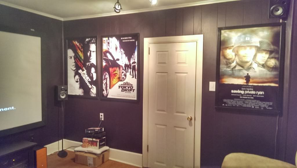

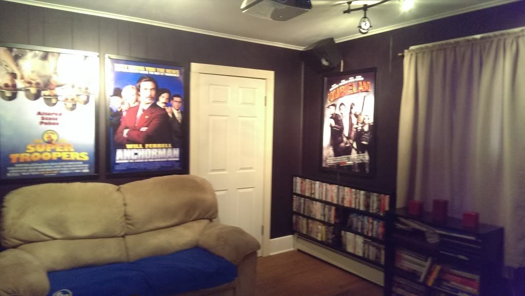

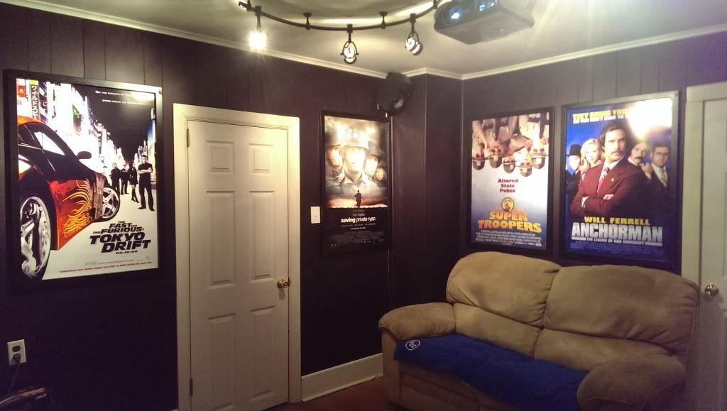

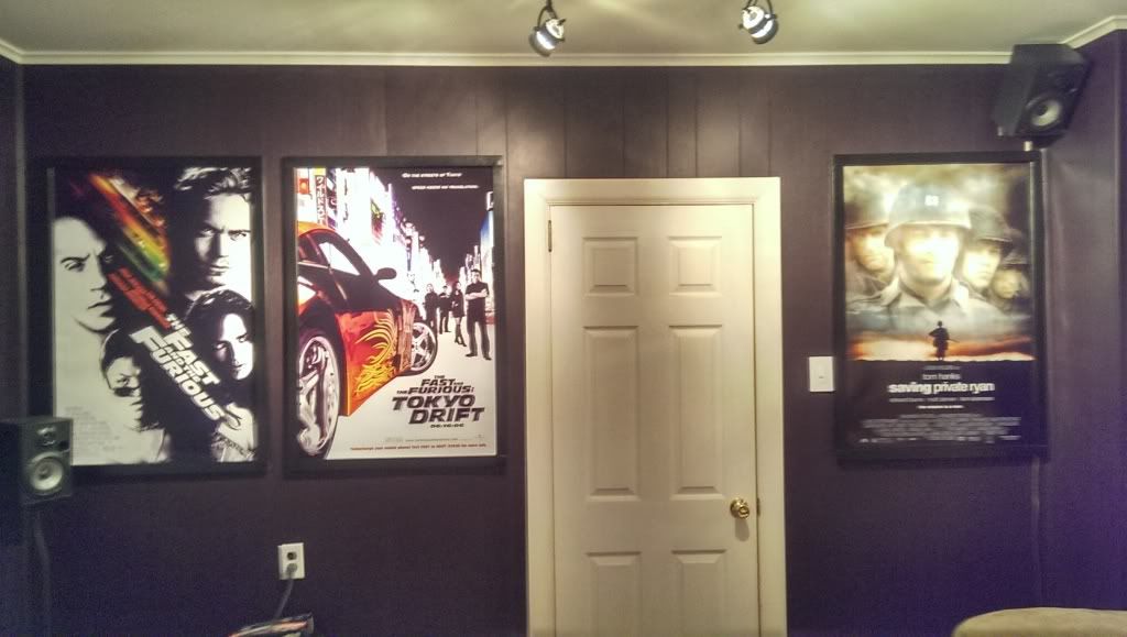

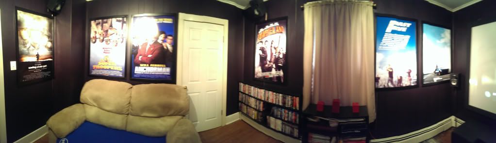

Pics below are as it is now.  Still have a little touch up but its pretty much finished.  Would like to add some tower speakers to my setup sometime though.
BTW sorry for the picture quality..it was taken with my HTC one and the camera has been acting up.  If i get a change I'll grab a few pics with our actual camera.

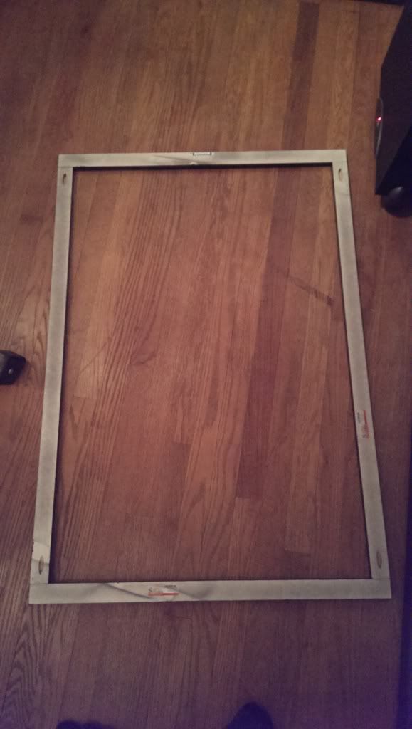

Simple poster frames ...cost less than $5 ea to make

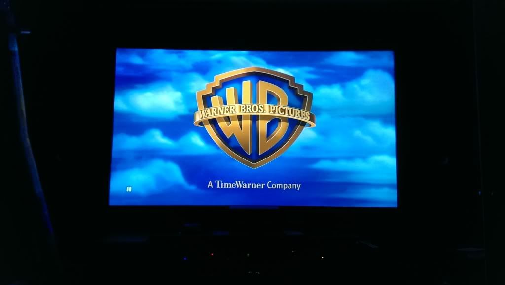

Picture quality is very good given the cost of projecter and BOC screen

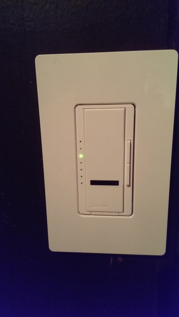

The Lutron Dimmer that controls the lighting. Funny thing is...it says nowhere in the directions that it can be programmed by another remote.  Figured it was since its IR...but strange it wasn't mentioned anywhere.

Good work, looks great.
Verge2 is offline
post #295 of 332 Old 03-13-2014, 08:00 PM
04silvy's Avatar
Join Date: Feb 2014
Posts: 2
Thanks! It works great for what it is. Still would like to add/replace seating. Might just try to find a microfiber HT recliner that matches our double recliner loveseat and call it good for now. I hope someday i can build a HT room from scratch. It's just not feasible at my current house. I added another pic of the screen (to show picture quality) with the lights dim as well. Hopefully my post will show back up when the mods approve it

This isn't what I ended up with, but this is what I had planned in an 11x11 room. I was going to put in a 92" screen where this 50" plasma is. That's what the blue tape is.
