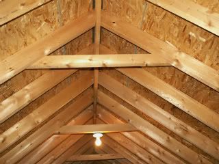

OK, here are a couple of more pix
more roofline (btw, that's not where the screen is going)
Floor to apex is just shy of 10'...9'10", and the current cross is about 8'8"
the joists
So I'm trying to get an idea, from anyone who's tackled it, about the best way to insulate this space before drywall...and what might be a good finished height for my room; it's approx. 12' wide and the finished space for the HT will be about 18' long.
Kneewalls are just shy of 5'...4'11". BTW, this is what did me in for my first attempt
Thanks for any help,
CD

If that was my space:
Lower the screen and mount the center speaker over the top.
From a seated position it looks like the screen bottom edge will be at eye level. Try to get the eyes up to 1/3 from the bottom of the screen. That give you a little more leeway on screen size.
Also the corners won't be pinched by the ceiling and there will be less reflection off the ceiling which will improve contrast.
If you are planning two rows of seating having the center elevated will make it easier to hear the dialog in the back row where it won't be blocked by the front row.
Also raise the sides speakers even with the sides of the screen as much as possible.

The insulation of the room should be pretty straight forward. Fiberglass batts stapled into the roof rafter bays, and then you have two options for the space begining at the kneewalls. You can either inslulate the knee walls themselves, which is the easier option, or you can continue the insulation in the rafters all the way down to the floor. While it is more time consuming, I would recommend doing it that way because your HVAC ductwork would then be inside the insulated envelope and be more energy efficient. Use kraft faced batts and make sure you where long sleeves and a respirator.

My room is very similiar. It is 20 ft. wide with a 4'6'' knee wall. 35 ft. long. Try to keep you height as high as possible. Mine is 8'6'' and the flat part of the ceiling is 13 ft.
I handled the window in my room by getting a company that does black out window for autos and had him completely black out my window. I added electrical tape around the edges and then ordered acoustical panels for the complete screen wall which also covered the window.
I also made acoustical panels for my first reflection points with OC 703 and GOM. The acoustics in my room are pretty good and I feel the room shape and dimensions help vs. having parrallel walls and floor ceilings.

When insulating the roof I believe you need to use baffles to hold insulation away from the sheathing to allow air flow.
Then you can use standard kraft paper faced insulation for the thicknes of the roofing timbers.
Cheers,
Mark
Do you only need the baffles where the vents are located in the sofit?

Yeah, this is what tripped me up from just rushing right in the first time; I read all this stuff about needing to ventilate, so you don't trap moisture in your ceiling and rot all the lumber...and about how if you face the reflective paper the wrong way, or use the wrong insulation type, you can melt the shingles on the outside roof.
As I've said, I don't know jack about home DIY, so this stuff I read scared me to death and that's why I'm trying to elicit any advice that I can. So where do these baffles go? Is it at the bottom of the "joist-channel", like where the insulation would come down to the knee-wall?

I don't want a little sliver of a ceiling, but I don't want to feel like the room is caving in on me either. The higher it is I think the better the room looks, but the HVAC guys have already told me a higher ceiling will mean a much harder time heating and cooling the space; especially considering it's an attic. I'm also concerned about the acoustics, although I don't know if the same mathematics apply to this shape. As always, any suggestions or opinions are welcome.
Dago, your room looks like a good compromise. How wide are you and what is your "cross-beam" height?
CD
My room is 15Wx21Lx9H. My floor joices are 2x12 on 12" center and the ceiling joices are approximatley 9' wide on 16" center. I decided to make the kneewalls 5' which is code for my area. Anytime I do something to my house, I think of resell. By staying in code, I could count this room as a fifth bedroom by just adding a closet. I was going to put a full blown stage with a riser, but now I am leaning more toward a simple, but comfortable movie watching and game playing room. I may decide to implement a small stage, but nothing right now is definitive. I am also putting a full bathroom next to the bonus room. When I built my house 2 years ago, I had the builder frame the flooring, install a/c line, stub the plumbing, and add an electrical tap. So, for me it is pretty much plug and play. The builder wanted $14,000 just to frame the room and $52,000 to finish it. I have about $1,200.00 in it as we speak, and I have all the wood to finish framing the bonus room and bathroom.

OK, like everyone else, I've been sick for a spell, and on top of all that work has been busier than he!! I've made a decision that unfortunately, I'm probably realistically looking at a Fall completion. The plus side is I do get a little bit of breathing room on how fast I need to try and tackle the room, but I don't want to fall into the old procrastination trap. So I want to at least start on one or two of the preliminary, boring things.
Here are my contenders: I need to insulate; I've considered getting an estimate on having someone do it...or is that just an idiotic waste of money? I need HVAC work. The estimates I've gotten so far deal with 2 different scenarios...either just the duct work and the area would run off of the 2nd floor's controller, or creating a new, 3rd zone. Obviously a zone to itself would be best, but also bigger $$$. Any thoughts?
And I want to run a dedicated circuit up to the HT level. Main box is in the garage, HT walk-up attic is 2 floors up. I am also wondering if I shouldn't bolster up my subfloor? Right now it looks like I am a single layer of MDF or particleboard over my floor joists; should I be looking to do a second layer with GG?
So these are the projects I see needing to be done (along with making sure all my HT A/V cabling is in place), before I can start "finishing" the room by rocking, mudding, painting, placing, decorating, etc. Should they go in any particular order? Again, I'm a self-professed DIY dummy, so I'm wondering like should HVAC come before insulation, or the other way around? Do I need to bolster the subfloor and should I do that before anything? And when do I address the riser again, before or after drywall?
Thanks again guys,
CD
CD
Install the baffles in every joist cavity the entire length of the joist. (I have seen some installers leave a 6-10" gap in between each baffle to save a little money and use fewer baffles.) Some people think the baffle is there to allow for ventilation for attic space, but in your type of application where you are filling the ceiling joists with insulation it is used to keep condensation and moisture from being trapped between the fiberglass batts and the roof decking. Insulating the roof would be quite easy, and you do not need to spend the extra money that an installer would charge you.
First step would be to staple install the baffles in your joist space. Some have self adhesive tape that you just peel and stick, others you staple into place. Start at the top of the ridge and work your way down. If you are only insulating to the knee wall, you only need to bring the baffles that far down. If you intend to insulate all the way to the exterior wall, then take the baffles all the way down to the base.
Next, push the batt insulation up into place, cut to fit with an utility knife, and staple the kraft paper face to the joists (paper faces the inside of the room and you would drywall against it.
It really is that easy. Just make sure you where long sleeves, gloves, a dust mask and eye protection because you don't want the fiberglass particles getting in your nose or eyes or on you because they irritate like all get out.
As for the HVAC, a zone to the HT would definitely make the space more comfortable and help control your heating and cooling costs since you could install a programable t-stat and ensure it is not runing to the room when it is not in use, but you need to weigh the cost vs. benefit. If the budget allows, I personally would do it, but if the budget is tight, you will be just fine without the separate zone.
I think a dedicated circuit is a must for a theater room. A good electrician can fish a main line down through the rest of the house with little or no damage to the finished areas of the house.
The floors wouldn't be MDF. Probably OSB which is a structural sheathing. Ideally it should be a minimum 3/4" for a floor, so if it is less than that, definitely add another layer. If keeping sound out of the rest of the house, and keeping outside sound out of the theater are your concern, then definitely add another layer of OSB with Green Glue between the layers.
I would get any HVAC and or electrical work done first, then tackle the insulation and subfloor, then move on to drywall, etc. If you want the riser isolated from the wall, install it after the drywall is complete.
Chris
My Build Thread
