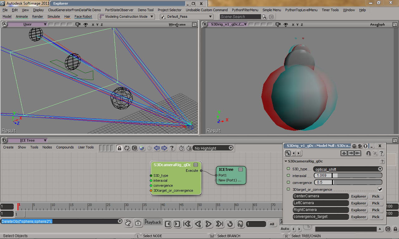

The toe In method is both left eye and right eye cameras are pointed at a single focal point.
Off axis method is separating the left right eye cameras.
1. The cameras should be separated 1/20 the distance to the screen.
2. Negative parallax should not exceed eye separation.
link
Off axis has extended frustum. Mr.Orman, are you suggesting that the extended frustum should not be cut off when viewing the screen?
