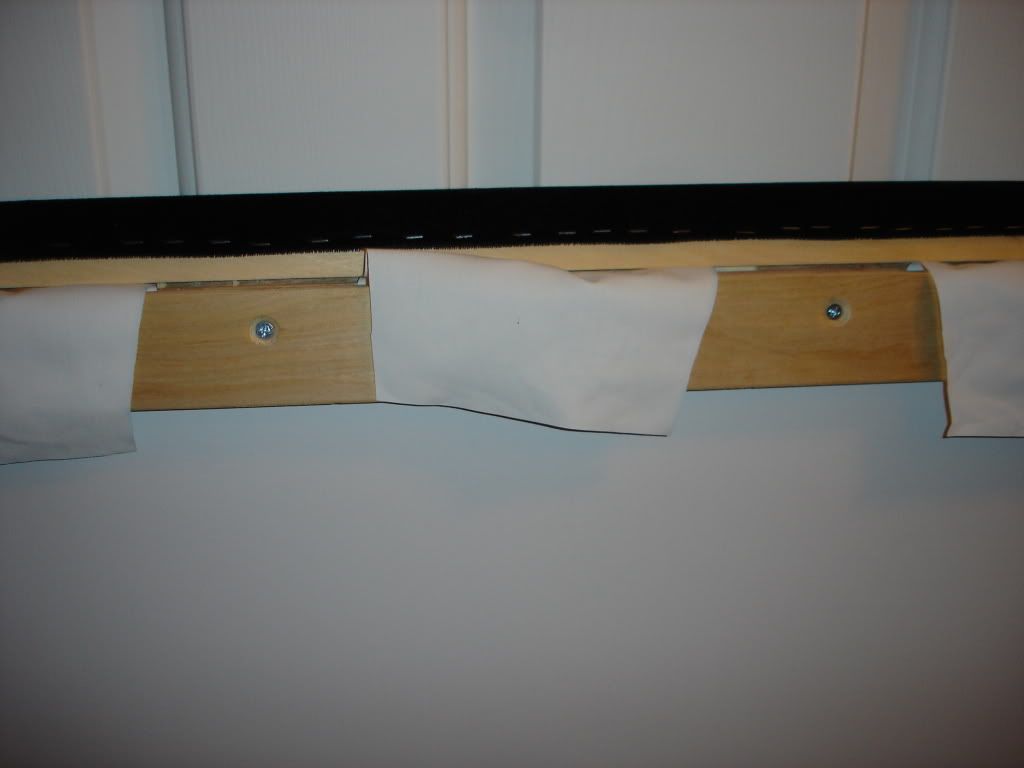

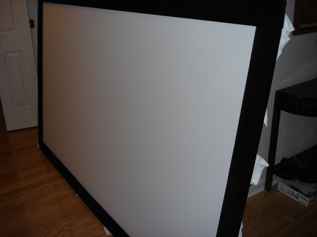

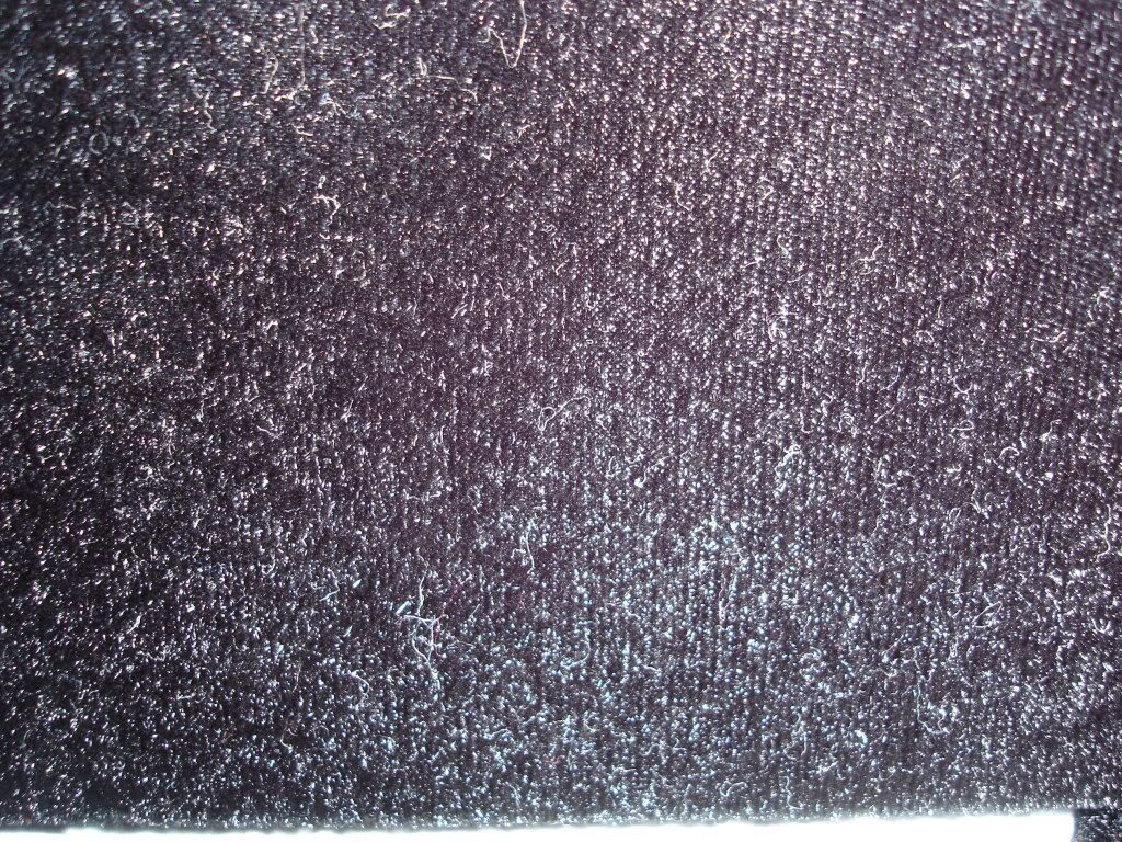

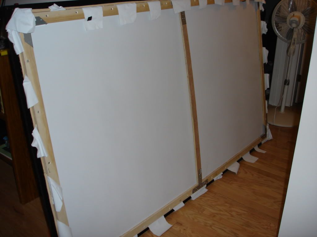

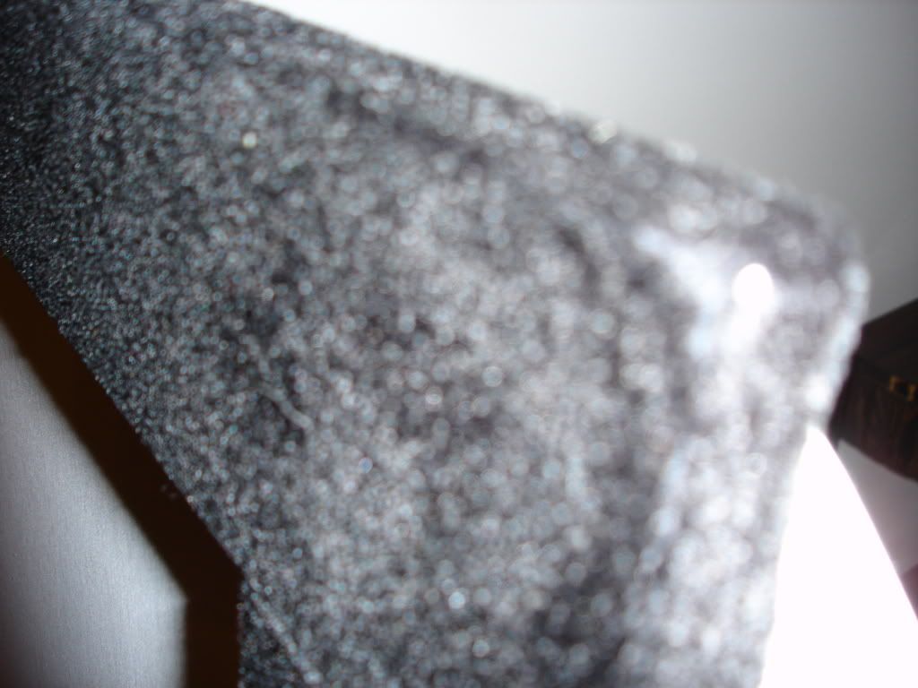

Here are the pics I promised
Panasonic TH-42PH9UK

Originally Posted by KramerTC View Post
terminatorbob,
A couple of questions..
I believe the frame with the black border is two pieces on the horizontal..is that right? Do you have any sag because of it?
How's the quality of the cloth of the black border? Is it black velvet or something else?
Oh and to answer your questions.
No I don't have any sag. after a few months of use the screen is still tight as a drum. It even sounds like one if you tap on it.
The quality of the cloth is ok. Its nothing fancy. Yes I believe it is velvet.

Originally Posted by 42Plasmaman View Post
terminatorbob, do you have a pic of the rear corner peice ?
He mentions something about interlocking peices and I'm curious if the corners are some how locked or are they held/secured together with the metal brackets.
Its metal brackets. You can see them in the picture above of the backside.

Mine arrived today. I have only had time to check the contents. The frame appears to be well constructed and the velvet is also very nice. The actual frame is much wider than my current 16:9 (54x96) frame and heavier. The framing was nicely wrapped in three separate plastic packages. The corner brackets were attached to the two end pieces and those corner brackets were also wrapped to protect the other pieces. The screen material is also rolled and tightly wrapped in plastic. I have not opened it yet. The box arrived damaged, but I blame that on UPS. Fortunately, I live in Atlanta and the screen was shipped from TN. It arrived the day after it was shipped. I'll get it assembled this evening and post some additional thoughts and pictures. I would have taken pictures of the wrapped pieces but didn't think of it until too late. Take my word for it though, the individual pieces were properly wrapped and protected.
It is going to be heavier than my current Dazian AT screen and my diy frame. That screen is secured to the false screen wall with keyhole hangers that are available next to the picture hangers at Home Depot. I hope I can use the same method with this screen.

Done! My number one comment/suggestion to anyone buying this screen: Read the directions twice. Pay close attention to the part that says don't overtighten or press too hard. I've stripped the heads on a couple of screws. I used my big bad Hitachi cordless drill and probably should have used a screwdriver for the screen tension adjustment. My old Dazian At screen seems to be similar in brightness, but light can penetrate that screen and I'm pretty sure light won't penetrate this screen. I hope that brightens my DLP image. The bad thing about my Dazian screen was I couldn't use a center support brace because you could see it through the fabric!
