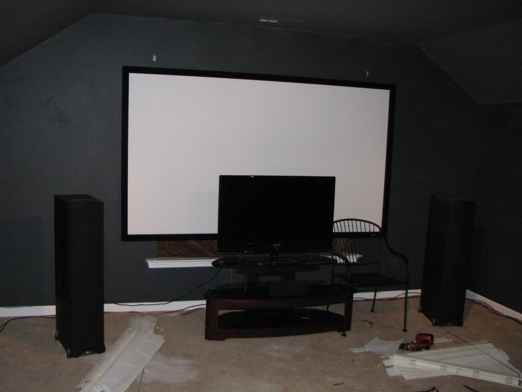

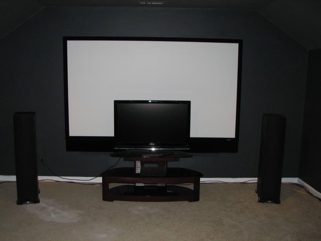

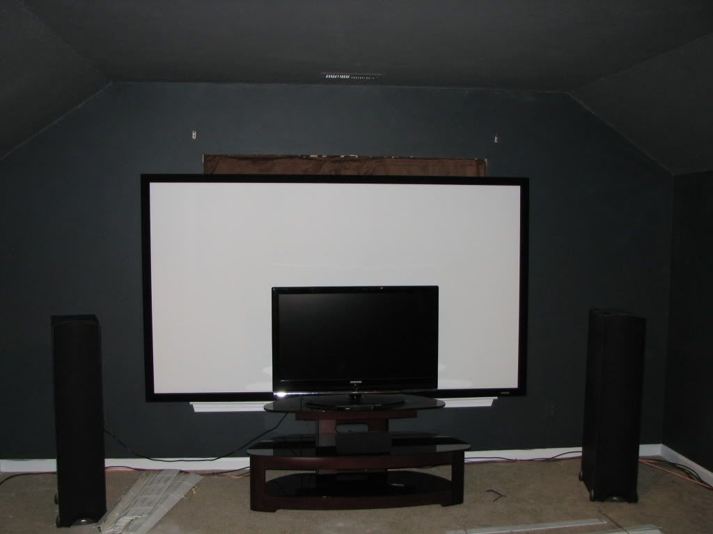

I just wanted to give an update of how I solved this issue. I ended up taking blackout cloth and Velcro and completely blocking out the light from the window. Then, I purchased a Carada 106" 1.78 screen from a member on the site. I hung the screen just at the top of the window frame. This left a 6 1/2" gap between the window I bought black velvet cloth from Hobby Lobby and had a piece of 8'x8"x1" custom cut to my dimensions. Using a staple gun, I wrapped the wood with velvet and wedged it on the ledge under the screen. Below are a few images.
Screen Resting on Ledge:
Screen Hung:
Blackout Board Inserted:
