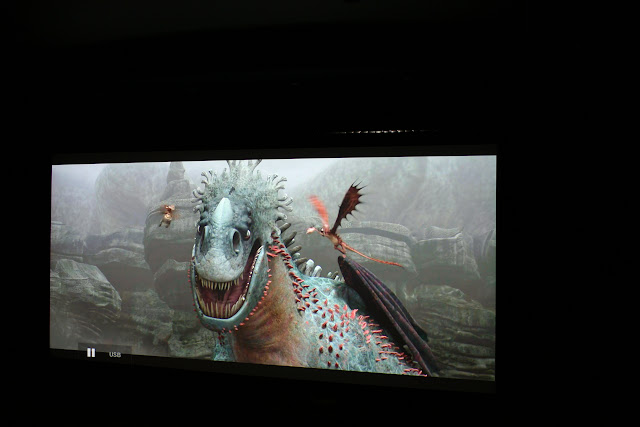

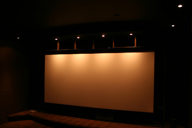

I was planning on building a DIY frame for Seymour DIY AT material - but ran across a review of Jamestown Home Theater screens a while ago, and thought "why couldn't I use that inexpensive frame, and replace the material with Seymour AT fabric?". So I contacted Chris Seymour (Seymour A/V) and James Millard (Jamestown HT) to discuss it, and they said it should work.
So I purchased 13' of the Seymour CenterStage XD material, and hired James to build me a custom 136"x64" viewable frame (no material). The material arrived Thursday, and the frame arrived today, so I set about putting it together. Not quite done, but close - still need to paint the center supports with flat black, restretch the fabric, trim the excess "tab" material, and hang the screen. This far took me about 3 1/2 hours today, not hurrying.
The pictures are probably pretty self explanatory - let me know if you have any questions. I'll add some screen shots once the fabric is restretched, and the screen is hung.
Flash shows reflection from center supports; will paint them flat black. No noticeable reflection while watching a few movie clips on it.
Edit: removed prices to protect the innocent (me)

Thanks for posting, Brad.
I have a couple questions. Obviously the weave is quite fine, so I can't see in the pictures - but, is the material "tilted" as Seymour describes it, to help ensure you get no moire? Does this change the way you tension the fabric? And of course, I have to ask - can I get a few pictures of the tensioning process? I think I read once a good description of how you need to work in the direction of the weave, to keep the material from puckering, but I would really like to see it in action.
Fred
Yes, I did tilt it to the degree that I could, given the screen size and material size - I think it ended up about 11-12 degrees? I don't think changes how to tension it - not that I know of.
What I've done so far is just a preliminary tensioning, as much as I needed to do to cut the material to size and cut the tabs. I'll see if I can make some better pics of the tensioning process when I get to that (during the week, since leaving for a weekend getaway).

Got the screen hung - still haven't painted the vertical braces, but its working great nonetheless.
Here's a few pics, check my build thread for more screen shots:

Just curious if you ever painted the supports or if once in use you decided it wasn't necessary.
alittletank is offline
post #29 of 79 Old 01-11-2012, 02:20 PM - Thread Starter
Brad Horstkotte's Avatar
Location: Torrance, CA
Posts: 5,199
Liked: 68
Yes, I did find that I could see reflection off them sometimes on scenes with a white background, so I took them out and sprayed with a black flat spray can that I had on hand, and then put them back. Now they are never visible.
