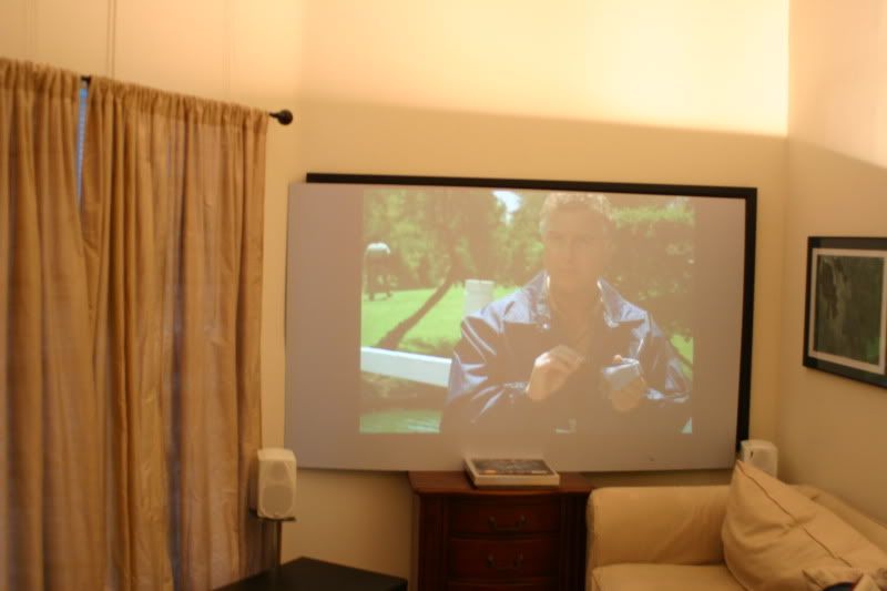

Hi guys, sorry I never updated, but I did end up going with the DNP Supernova 23-23 material. I am really happy except for a couple of things.
One is that there are horizontal shadows present in bright scenes. maybe 2,3 inches tall, and 4 or 5 present. I have a picture I can post later to display it. I am currently talking with dnp to try and resolve it. They recomended moving my projector down and seeing if that helps....which I havent had time to do, but they said they will make it right.
Another thing is that the glue they use for the velvet border between the screen and aluminum frame is visible. When light hits it, its like a higher gain portion of the screen. Its not a huge deal as I never focus on the borders. But it appears to be present for all their screens as the sample has it too.
Other than those, it is a beautiful bright screen that handles light very well. The off axis viewing is superb. The BD has a blue/purple tint as u move side to side. This has consistent color all the way around without much light loss.
The screen handles light from above better than at a horizontal angle...but it handles that pretty decent.
Ill get some pictures when I get back to my place as im out of town right now.

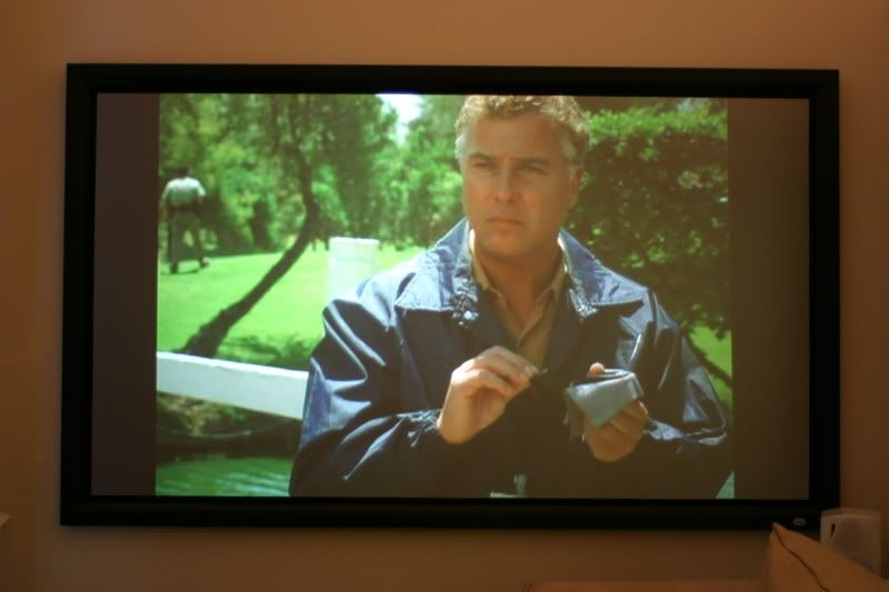

Hi there
I'm currently using a DNP Supernova Core 100" with the 23-23 material but I'll send it back soon. I have the same issues with horizontal shadows which are up to 6 inches high going from one side to the other. This is very annoying if the camera moves vertically. Here are some pics:
German hifi-forum
My main issue is the screen structure. I'm sitting 9 feet away and its clearly visible to me. HD material looks nearly like SD as if you were projecting on sand, sharpness suffers greatly. Now I'm considering buying a 0.8 DNP or a BD.
Greetings from Germany

Yup, looks like the same thing I am experiencing. I wonder if its a bad batch...when did you buy yours?
I did notice some reduced sharpness, but I don't think its so bad that I have to return it. It could be because I am sitting a little further back though (12 feet).
ParanoidDroid is offline

Mine is about 6 months old according to my dealer. He already used it once on an exhibition.
It is really bad while browsing with huge white spaces. Plus, when I turn my head slightly right and left I see something similar to the rainbow effekt on DLP projectors. No, I see it constantly in white spaces but while turning my head it is really annoying
r4Yn is offline

I had an environment with lots of ambient light and the DNP was amazing in allowing us to keep the lights on and use the projector.
The location and directionality of your ambient light can make a huge difference in how well the DNP works. Light coming from the same direction as your projector will harm the image. Light coming from above or the sides is rejected wonderfully.
I personally wasn't bothered by hot spotting effects, but everyone notices and finds different things objectionable, so if you can see one in person.
Some comparison pics between a DIY screen vs the DNP with the lights on (last pic is lights off)
and the cat picture with the lights off in my room

Liked: 29
Thanks for sharing the pics! Is that the 08-85 or the 23-23 material?
