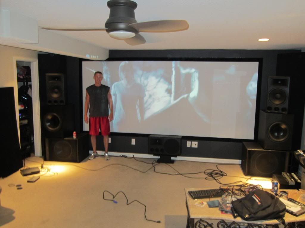

Have you considered doing an acoustically transparent screen and putting your speakers behind the screen? In your space that might work really well??!!?? You could use some of that significant depth of room and have the screen go nearly floor to ceiling.
In this context - some of the spandex materials are a very interesting idea. Some of the DIY guys have had great results with large sheets of spandex available to order online. You can make your screen as large as you want, and still have very good acoustic transmission properties on the cheap. This particular one gets good reviews from the DIY crowd... With the 60" height of the fabric you could do a 120" ish diagonal 16x9 screen and/or an enormous scope screen.
http://spandexworld.com/c3/catalog/product/6409
I would check in with avsforum member carp to learn about how he did his screen. It's the KC favorite in our crowd of enthusiasts. The actors on his screen are larger than life in scope mode. I copied a picture of carp below. He is probably 6'1 or so. So you can see how big it is. Of course it looks awesome with the lights off. This was a recent g2g day where I brought my captivators over and we let the submersives and caps face off in his room....It was a wild day.
http://www.avsforum.com/t/1407184/carps-basement-hide-out/0_50#post_21948854
Actually yes, I've been thinking about going the Acoustically transparent route as well. Trouble is to cover most of the wall I'd be looking at a 165" diagonal screen (81 high and 144 wide in 16:9) which may be difficult to find a single piece of material. If I were to buy one - even lower end like Elite Acoustipro they are very expensive. I'd like to explore that more later but for now I'm going to do a basic 133" white screen to get started. I know once I start placing my speakers and subs (especially) I will probably NEED the space provided by the acoustic so that can be a Phase II perhaps. smile.gif I'm really just looking forward to getting this done and hosting a GTG at my place in the late summer/fall.
Carps room looks AWESOME! I'm sure you guys had a blast that day, wish I could have been there. I'd love to chat with him as well while I'm prepping my room now to make sure I don't miss anything.

This picture sort of looks like how my room is setup and has me thinking of how big i can go
