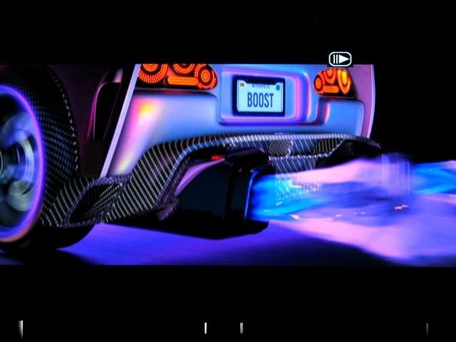

Final follow up on my Sony Pearl and Stewart Firehawk SST Lexus Model A Electriscreen home theater project. By the grace of God and the exceptional advice from numerous AVS forum members and Stewart, everything is FINALLY done; the screen is up, the projector has been ceiling mounted, the new Def Tec speakers and OPPO981 HD DVD player are all in place, the cables are managed/hidden and everything is working exceptionally well. As for the Stewart SST screen; NO ladder tracks, no defects and it, along with the picture it produces are gorgeous! Best investment we have ever made. The SST material works wonderfully well with the Sony Pearl and other 1080p short throw PJ's. No hot spotting, NO sparklies, NO screen door effect, just a VERY fine, even picture. If you would like to see how the theater turned out you can look here:
http://www.avsforum.com/avs-vb/showthread.php?t=838097
Here are three "Screen Shots" FYI:
If anyone is thinking about buying a Stewart SST (or other Stewart screen better suited to your theater space) screen to go with your Sony Pearl or 1080p PJ, all I can say is: "Go for it!" Yes the Stewart SST screen is more expensive than the competition but it is worth EVERY penny. It produces exceptional blacks and the contrast is tremendous. One more thing, the after purchase customer support from Stewart has been outstanding. They have provided extraordinary customer support, answering every technical and nooB question I have asked with the result that the finished project turned out perfect... thanks Mark and everyone at Stewart.
Jmouse007 is offline
