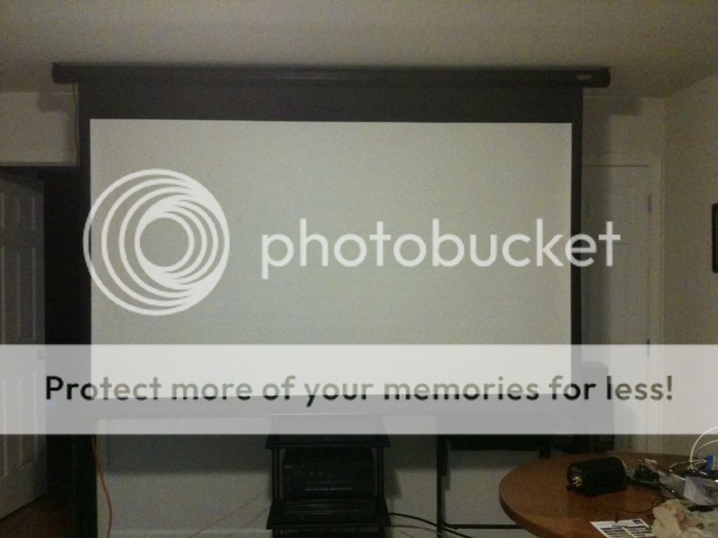

post #1130 of 2113 Old 12-30-2010, 07:05 AM
miatame's Avatar
Join Date: Oct 2010
Posts: 48
Got the screen up last night. Basically what I thought it would be like...lots of talking with my buddy about the best way to mount it, lots of time gaining access to the ceiling through the attic, lots of time finding the stud and then 5 minutes to actually screw the screen into the ceiling. It looks GREAT though. I got "lucky" and had studs running parallel with the screen so I didn't have to use the 1"x6" plank I bought. It would have looked funny.
Please keep in mind this is right after the install so the furniture is all over the place and cr@p everywhere. This is not how the room will look when it's done! Oh and keep in mind that's a 40" LCD TV....100" screens are huge! haha I love it!
Screen up:
Screen down:
miatame is offline

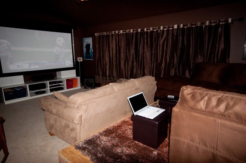

Well, I have to say that I've been pretty happy with my 100" Elite CineTension2 so far. We went with this set up because my boys (8 & 10) still watch a lot of Nick and Disney channels and I didn't want them running up the hours on the PJ on that crap. The white furniture was somewhat expensive and only a few years old, so we rearranged it. It does through off some light, but it's not distracting to me and the people we've had over so far.
My only problem with the screen has been trying to figure out how to get the 12v trigger to work. The manual says red is +12v and green is 0v, but I'm not sure what is what from the Epson 8350. So, if anyone has any insight on that, it would be appreciated.
Screen Up
Screen Down
jbrentd is offline
