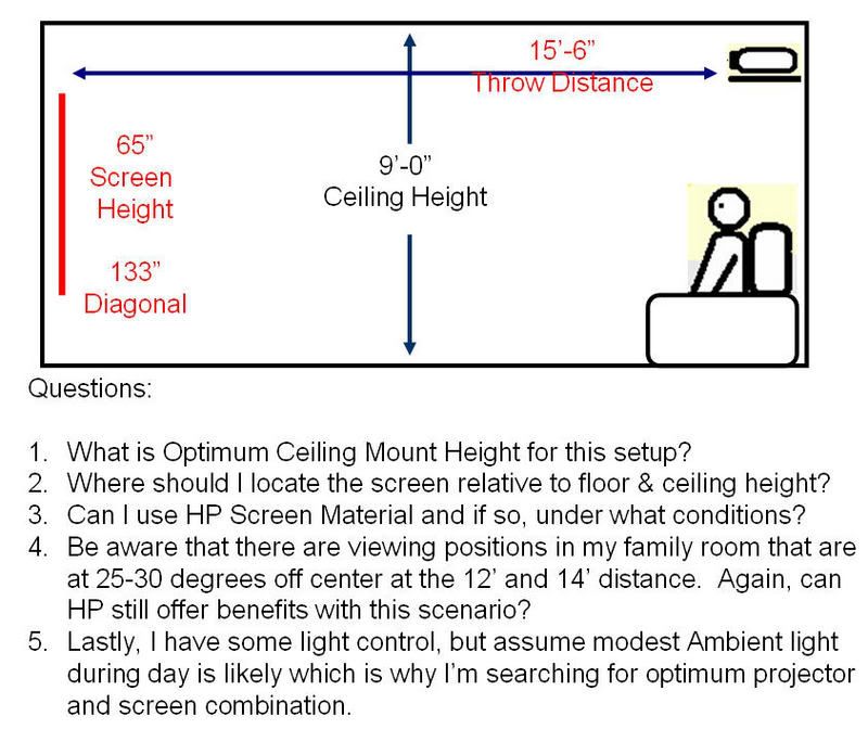

Folks over at the Projector Forum sent me here... I'm struggling to find a bright 720p or 1080p with good contrast that will work with HP and offer me flexibility for both daytime and evening viewing in my family room.
I've got 7 projectors on my short list for use in my family room as a night time cinema setup and possibly even a day time (with modest light control) for use as a potential regular TV viewing setup. ( Here's my short list: Epson ProCinema 1080, Mits HC6000, Mits HC1500, JVS RS1, Sharp Z3000, Sanyo Z5 & Optoma HD80).
I was told that the setup below wont work with HP and the Mits HC1500 because of the lack of Offset on the Mitsubishi...
I need some guidance on what you knowledgeable fine folks would recommend regarding screen / projector combo given my constraints - (see below).
Thanks!!! bradesp

1- For HP screen, near eye level; for other screens, depends on the PJ offset adjustment limits.
2- 1/3 below seated eye level and 2/3 above.
3- HP works best for eye-level PJ mounting and narrow (+/- 15 degree) seating arrangements.
4- Not for those seats. Your screen gain would be less than 1. (See graph in the first post of this thread.)
5- Ambient light is not a friend of front projection--less so with large screens. Install some blackout shades.
In your shoes, I would probably consider a ceiling mounted RS1 and a 123" 16x9 Vutec Silverstar screen.

3. Hp is fine at 30 degrees, especially at only 133" diag with an RS1. Mine is fine at 30 degrees on a 159" with moderate ambient light. The ideal spot is of course the center seat, it will be brighter there but it's still good on the edges. The only thing I'd suggest for your setup to improve things is to lower the projector down with an extension bar or lower shelf if that's how you're mounting it and raise the screen up a bit.
The tight angle requirement often stated for HP's is pretty overblown. By the time you're sitting on the edges it's like watching a standard gain screen.
HP screens are the most friendly of projection screens for ambient light. Unless the light is coming from behind near the projector it won't bother things too much, at least much less so than standard screens.
As I mentioned the only thing I'd change is to lower the projector closer to head level and raise the screen a bit.

Since there seems to be some dispute over what I have written above, let me describe what I see with my 100" HP screen from my primary seating position at 12 degrees error angle as opposed to what I see from a seat at 30 degrees. Then you can decide. At 12 degrees I see a bright picture with lots of "pop". At 30 degrees I see the same picture, just a lot dimmer. There is nothing else wrong with the picture (no sheen, no abnormal color or side-to-side brightness variation, nothing weird). It's just dim.
How dim? Well, if you believe the graph in the first post of this thread, at 12 degrees the screen gain is about 1.65. At 30 degrees the gain is about 0.65. This is a ratio of 2.5, so the brightness at my primary viewing position is 2.5 times the brightness at a 30 degree position. Some may consider this brightness variation "fine." Personally, if my primary viewing position were as dim as what I see at 30 degrees, I would be ready to spring for a new bulb. (PJ is Epson Home 1080 in Theater Black I mode.) YMMV.

I agree. From the diagram, your setup looks very similar to mine with my Firehawk screen. The HP was just too dim for my taste in that configuration. I lowered the projector well over 2 feet and it rocks.

I think I follow, but I'm not sure... Are you saying you are using an HP screen or a FireHawk screen? It sounds like you lowered your projector to hit the HP more "head on", but then you mention the FireHawk... BTW, which projector? And are you now using the HP with the lowered projector or the Firehawk?

I have a Sharp XV-Z20000 (1080p DLP single chip) projector shining on an HP 110" Cinema Contour screen. It's mounted at a level just above my head from the main viewing position. I've never formally measured the gain, but it has to be well over 2+. When I had the same projector shining on a Stewart Firehawk 109" screen, but mounted near the ceiling, it was far too dim to be satisfying, even when the lamp was new. The HP screen, when mounted in that same high position, was also too dim to get good gain, even when the lamp was new. When I dropped the Sharp down to just above eye level, with the HP, the screen lit up like a torch in the night sky. OK, a little hyperbole, but it was amazing. I have over 1800 hours on the Sharp's original lamp now (on its best settings) and it's still very watchable. The Sharp is not a very bright projector, even when the lamp is new (I keep saying that). I know one owner who changed out the lamp after about 700 hours because it had dimmed to under half its brightness and wasn't providing a bright enough image. I expect to get from 2500-3000 hours on that lamp before I'll have to replace it.
Better?

Thanks, MUCH clearer. OK, so here's a question. How do you and others navigate into your room without disrupting the displayed image since the projector is so low because of the angles necessary to use an HP screen? If I'm using this kind of setup in a family room (as opposed to a dedicated home theater) isn't this a bit impractical? At home my wife and kids routinely go to grab snacks or make potty breaks during a movie without pausing the DVD. Just curious.

Any time you have a projector that isn't ceiling mounted, you're going to have the occasional blockage. In my room, the "exit aisle" is along one wall, making it relatively easy to come and go with minimal disruption. Of course, there are only 2 of us in the house most of the time, so that eases those concerns. When I saw the HP image on a sample Da-Lite sent me, I knew I had to have it. I found a way to lower the projector and I have enjoyed it ever since. I realize, though, that my arrangement isn't going to work for everyone. I'd prefer a ceiling mount. That's what I had for several years. I have never regretted going with the HP, though - not for a minute. It's a much better screen than the Firehawk. No sparklies/shimmers, no hotspotting, no color shifting. I think a lot of people could make the HP work in their theaters, but if you have wide spaced seating (too severe off-angle viewing), you should look elsewhere.
