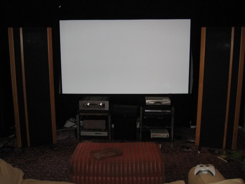

Millerwill: My system is a very similar setup so the High Gain looks like the screen to go with. Just got a quote from Jason and once I sell a pair of MLs Vista speakers I have for sale I will be moving over to this screen. My projector is about 3 feet above my head and I am about 16 feet back, middle of screen is about 1-2 feet up if I am sitting in middle of couch. I will be using a 16X9 92" screen...
