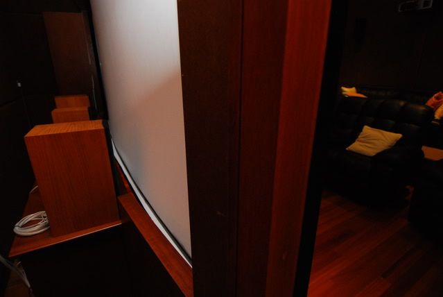

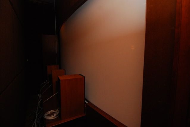

Ruben,
Were bringing fown the screen to stretch the material a bit more. That's what the bulge is

Hi Farhan,
What I am seeing doesn't look like the material is not tight. It looks as if you have a shelf protruding from the bottom back side of the center of the screen. Maybe a speaker shelf because it is only in the bottom middle of the screen?

You're on to something, though, with yourlilbro's. It's visible in the first two shots of the screen as well as the last shot with Downey on it.

Nope, it's the material.
I've checked.

Is it sagging slightly causing a distinct shadow?

Hi Farhan,
I just looked over your dedicated theater thread and I saw these pictures and found the problem. You didn't use the center supports that are required to tension the screen. If you don't use them, the sag will keep coming back since it is a curved screen.
When you get your ProCurv screen, you get two center supports/wall brackets and one stabilizer bar. The stabilizer bar should of been used for when the screen surface was being installed and remain on the screen until you fastened the screen to the wall brackets/center supports.
In the SmX ProCurv Assembly Guide, if you go to page 5 and 6 you will see the stabilizer bar in use as the frame is being assembled. Then if you go to page 25 and 26 you will see the wall brackets/center supports. Whether you are mounting your ProCurv to a wall or not, you need the support bars. Our ProLine flat fixed screens do not require support bars on screens up to 12 feet wide but the ProCurv does.
Once properly installed, the CineWeave HD screen surface will never sag because the strands in the weave are re-enforced with fiberglass.

Farhan,
I also want to add something. If you install the supplied center supports on the ProCurv screen now as the way it stands, it may stretch the sag out of it without needing to retention the screen surface.

Hmm, I will check if I left that one out.
Thanks Ruben
