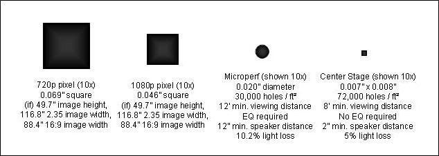

With regard to the woven fabric, your pixels would (at worst) be 6x larger than the holes in the fabric. This means that you could only lose a portion within the pixel, never any full pixels themselves and no loss in resolution.
If I got your screen dimensions right, your pixels versus the holes should look like this:
You really only get into trouble when you pack your pixel density unreasonably high. Tilting can alleviate any moire effect, but if you're trying to pack a 1080p image on to a very small screen (for a projection - say, <80" image width) you can see some artifacts start to occur.

Chris , it is 127 inch wide. Is your screen angular or reflective? What does the 15 deg angle do?

A 127" wide image would have pixels about 9% larger than I illustrated below. You would be that much further from any issues with the holes in the fabric.
The fabric is reflective, but with a wide viewing width of 160 degrees, would be considered a "scatter" type screen like is found with unity-gain screens.

Originally Posted by chriscmore View Post
Hi Ned -
A 15 degree tilt randomizes the hole structures with regard to the fixed panel display's pixels. By effectively randomizing the interaction of the two patterns, moire can be reduced or eliminated. Realistically, it's a very uncommon effect, and only a concern for high pixel density images. As projectors' pixel fill ratios continue to increase and their structure becoming more smooth (e.g. Smoothscreen), it is less and less of an issue. Still, an easy fix.
Cheer,
Chris
By being retro reflective that would reduce the gain since my projector is ceiling mount. I was hopping that it would be angular reflective since I'm coming from a high power.
