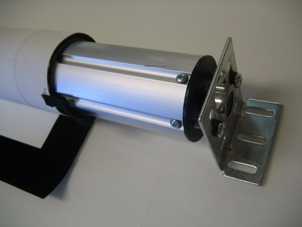

Pictures being worth a few words and all, here is a snapshot of what a caseless screen looks like. The first picture is of the motor side, which mounts in a custom rubber mount that keys inside an L-bracket that ships attached. The rubber mount must be keyed inside the L-bracket for robustness, but the L-bracket can be unbolted and rotated to any 90 degree side you want to bolt to the vertical or horizontal surface.
Note that this screen doesn't have all the tabs, the tensioning hardware or weight bar installed yet. The cables just roll up nicely with the roller bar, but I'll post more pictures of tensioning system seperately.
Here is the passive axis side. On this L-bracket is the keyed ball-bearing. It just slides off and on, being a cylindrical axle through the matching round hole.
The mounting screw locations can be +/- 1" due to the wide slots in the L-brackets. I'll post more detailed dimensions on the site soon, but if you plan on the mounting locations being the same width as the case, you'll be fine. The standard orientation is for the tabs, or ears, of the L-bracket to point out. If you need otherwise, please make sure you let me know; it's only an issue on the motor side.
Cheers,
Chris

post #77 of 3460 Old 08-28-2007, 10:47 PM
PhillipD's Avatar
Posts: 137
Thanks Chris,
That is exactly what I was looking for, the pics help very much. I think that would work for my application. Now just one other question, can a screen be made without the tab tensioning hardware? If so what it the preformance or wrinkeling effect without it as opposed to with it? Just thinking I may not need it if the material is heavy enough with the weight bar alone. That is if this is an option that is avaiable.
Thank you
