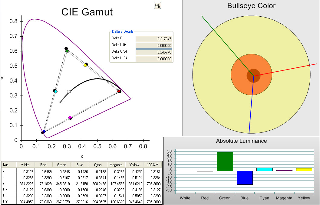

Attempt No2, this time without any help from the Lumagen.
I am rather puzzled by these numbers. Here's your result with the Lumagen's help.
CIE94 %L %S %H
R 0.9 -0.8% 2.7% -0.2%
G 9.6 10.4% 4.7% 1.5%
B 3.7 -11.4% 6.0% -0.9%
Y 2.2 1.6% 3.4% -0.9%
C 2.9 1.8% 7.6% -4.8%
M 1.2 0.3% 5.6% 1.0%
3.4 Ave.
And here's without the Lumagen.
CIE94 %L %S %H
R 1.2 -1.7% 2.6% -0.2%
G 9.0 -10.3% 7.4% 1.9%
B 2.3 -7.0% 3.4% -0.1%
Y 1.7 -0.7% 4.6% -0.1%
C 3.4 -1.6% 15.9% -3.4%
M 0.9 -1.0% 4.2% 0.5%
3.1 Ave.
You got marginally better without than with. Also, although the green dE error was about the same in either case, the luma was too high in the first case and too low in the second.
From these results it seems that the Lumagen wasn't helping.

The figured the Lumagen might help a bit, but it throws secondaries out quite a bit (JVC CMS can correct a lot of the issues) and I wasn't that happy with the image quality afterwards. I decided to try again without and I'm very happy with the results. The trick is to play with the saturation, hue and brightness controls for each colour, they all affect each other in strange ways like upping the brightness on the green reduces the saturation .

Lens Aperture -15
Lamp normal
CMS (Hue, Saturation, Brightness)
Red -2,-14, 29
Yellow -4, -30, 17
Green -5, -21, 30
Cyan, 7,-30, 27
Blue 0,-20,30
Magenta 2,-10,24

Originally Posted by Manni01 View Post
Hi everyone,
I think I have finally made progress! I've posted new data for my third attempt in my thread here, please comment about the results (here or there) http://www.avforums.com/forums/dlp-l...attempt-5.html
All the colors are spot on on x,y except cyan, and dE for al colors is 3.5 or under, except cyan at 7.5.
Picture quality is great, I'm sure it could be further improved, but I'm satisfied with the results.
JeffY has posted encourraging results as well, although he is also using a lumagen. EDIT (sorry I missed JeffY's post above).
These are the settings from your last calibration? ''Here are my settings (I'm aiming for about 12 fL with the iris at -15)
Contrast: -8
Brightness: 0
Color: -8
Tint: 0
(I recommend to set your gamma reference in the gamma menu before you work on the greyscale). I went for 2.3 which gave an average or just above 2.2.
Color temp:
Custom (at 6500K) with the following parameters:
Gain Red: 0
Gain Green: -5
Gain Blue: -66
Offset Red: 2
Offset Green: 0
Offset Blue: 1
I adjusted gamma with a reference of 2.3
Then in the CMS (advanced):
Sharpness 0
Red: H-4, S-18, H4
Yellow: H4, S-15, B30
Green: H-11, S-18, B30
Cyan: H-1, S-30, B30
Blue: H18, H24, B-12
Magenta: H-4, S0, B2
I get a very satisfactory dE for all colors (around or under 3.5) except cyan at 7.5. Ths is quite an improvement compared to before calibration (dE from 11 to 33!)"
