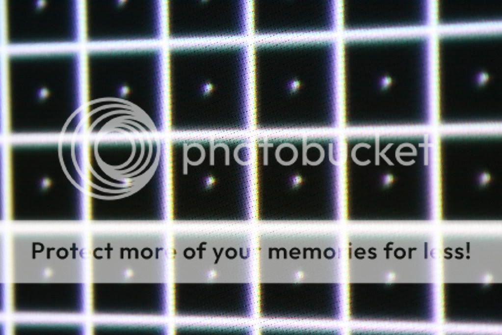

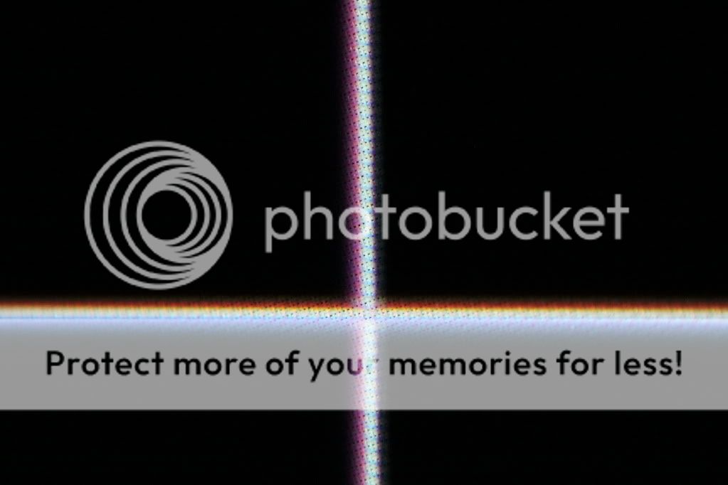

Ignore the rainbow colors you can see. That's just from some interaction between the DLP wheel and my camera. Pretty sharp. In person, I don't see any color other than black and white in that image. You can see a bit of a shadow in the vertical line, but that is due to some processing/sharpening that the projector is still doing. I've got sharpness on 3. Going to 2 might get rid of that. I forgot to try it.

Oh, but not so good here,
talon95 is offline

Mine looks the same as talons grid above.

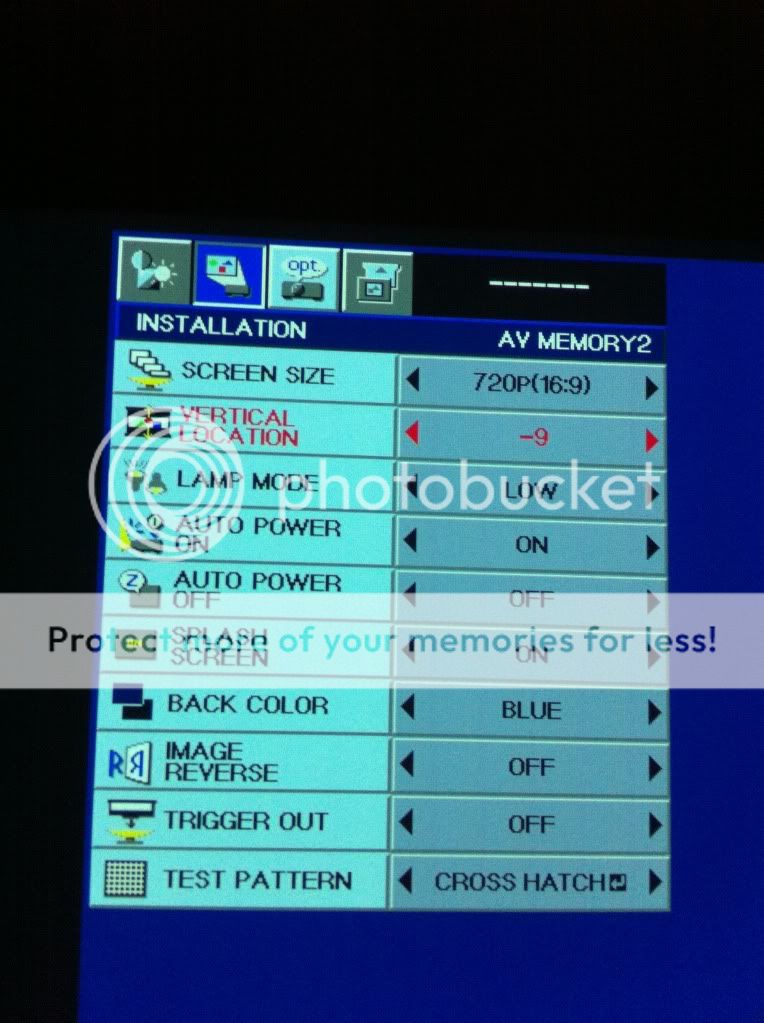

I was looking for a pattern in the menus (and service menu) but couldn't find it. Where is it?
I am pretty sure it is in the regular menu (not Service or ISF) .. 2nd to last tab. called "test pattern" i think? i don't have my unit in from of me but from what i remember if a source (blu ray player) is on or off , it affects whether or not the test pattern is greyed out or not (accessible).
I'll take a look when I get home tonight. I pretty sure that I'm not getting a really sharp pixel grid though. Not really bad, but not as good as I've seen (like my old Infocus X10). It's acceptable to me though. I knew it wasn't quite as good the first day I had the W6000, which was 2 or 3 months ago. Everything else works really well on this unit, so I didn't think it was significant enough to try swapping units.

Does it look this out of focus to the eye when you are up close? the camera exposure can cause a lot of flaring which will mash all the pixels together in the photo. When I took the W7000 photos, I set my Nikon SLR to manual exposure and adjust the shutter speed so it looks closer to what my eye is seeing.
The pixels by eye, are quite defined when I look up close. The original W7000 I demo'd had a lens issue and I could barely get the center of the screen in focus, and almost everything outside of center was out of focus. The replacement was much better, still not quite as perfect as my BenQ SP890 (same lens, same chassis) which is pixel perfect from edge to edge, top to bottom. We use it for PC demonstrations and this particular sample is excellent. I've seen enough projectors this year to see noticeable sample variances from the same manufacturer.

Yea, that was it (built in grid). It was greyed out until I killed the input signal. There's no doubt that the W7k that Zombie has has better focus based on the grid image. Definitely less streaking (for lack of a better term) coming off each pixel. Otherwise it's about impossible to know based on screenshots IMO. It's got to translate in to a somewhat sharper image. I'm not sure I would want it to be too much sharper though as it is already somewhat unforgiving of any video noise in the source.
Mine is better in person. I took those shots with my phone! But the thing I noticed is there is a lot less of that "streaking" off each pixel in your image. Ok, I'm going to have to fire up my X10 to see what the grid looks like on it. I've never bothered with that in the past.
talon95 is offline
On my Canon SLR, I did not use manual exposure or adjust shutter speed so that that could definitely contribute to how the screenshots look as it does but when I did look up close I could not see well defined pixels like in your screenshot. It looked blurred together with some grooves on the sides but I could definitely not see square pixels. To me, this would support why I could not get a clean, crisp image from a reference blu ray disc like KFP2 or SW Ep 3 no matter how carefully I tried to focus. I also turned off image processing like chroma and luma.
I feel like I am beating a dead horse here. I'll wait and see what BenQ comes back with. Appreciate you taking the time to chime in.
