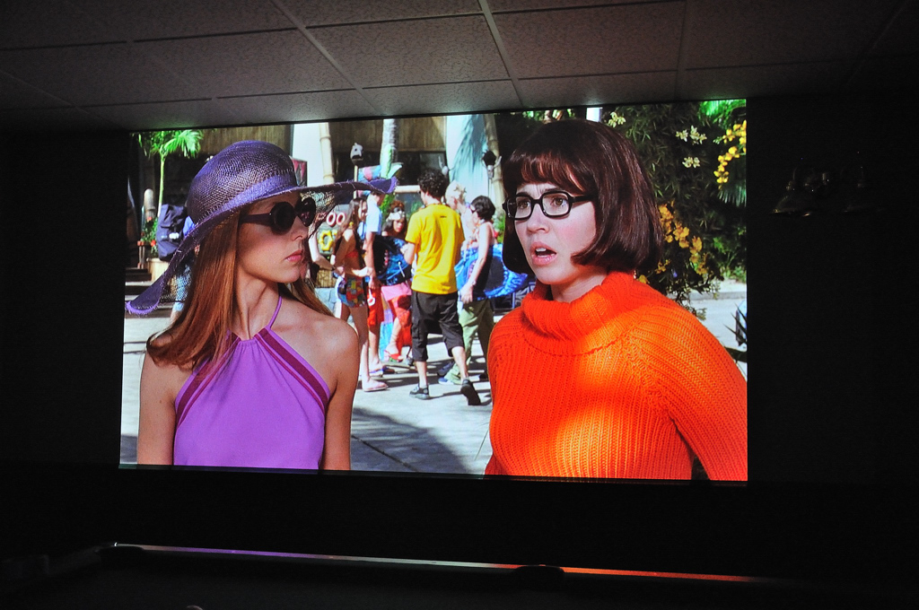

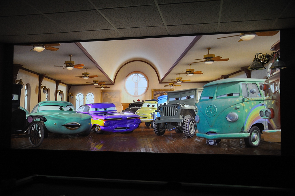

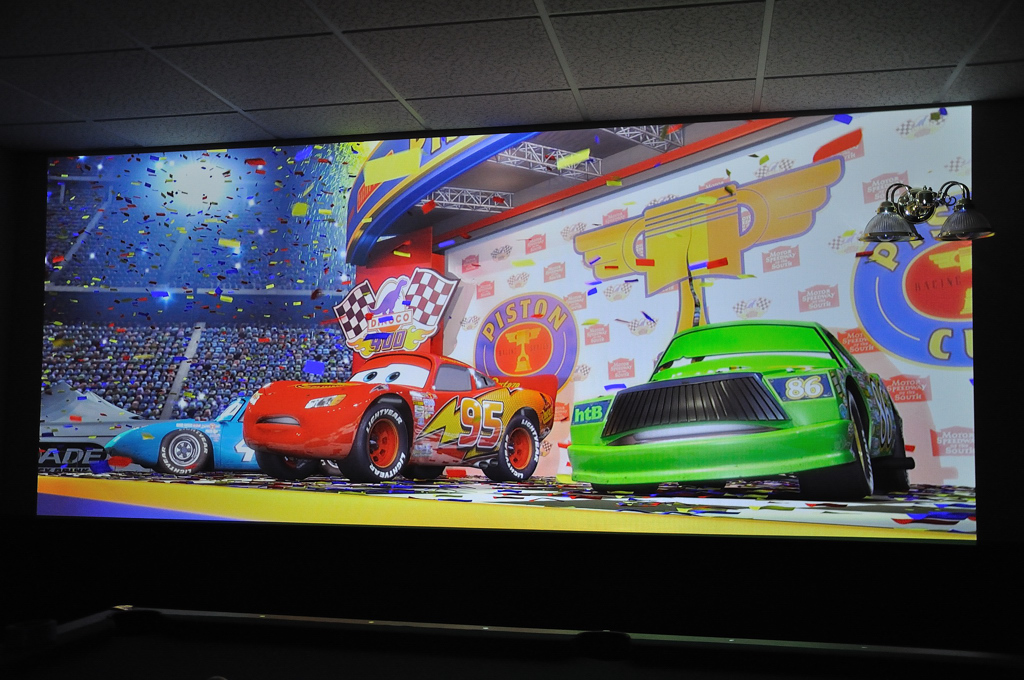

thank you guys for taking the time to discuss this interesting feature in the mitsubishi projectors. I've had the 5500 since July 08 and had no idea it could do this.
I have a large wall to work with and would attempt something similar as member avsnub in the 5500 thread did. I believe I have the space to replicate this setup:
2:35:1 (51" x 119.85")
With the masks installed, I believe he mentioned it would be 104.03" diagonal which is larger than my current 92" Dalite HP pull down.
It's a bit of work to install / take off the masks but I primarily use the projector for watching scope movies and would appreciate the full scope appearance on a large screen, especially without spending extra $$ on a lens.

claus - thank you very much for taking the time to document this. I hope this is useful to all mitsubishi owners (5500,6500,6800, etc)
I believe I will stay with the high power screen material for the reasons you mentioned, the screen will be larger and the projector likely further back that it was before. My only issue is that it's going to be ceiling mounted this time and think I will lose much of the HP benefit. Before I had it shelf mounted about 6-8 inches above the viewer's heads. I am looking for a source to purchase the dalite material directly so I can make a screen from scratch, please PM me if you know of any sources.
I have a question about the shutters. Are they necessary? I was under the impression that you were zooming the screen so that the black bars are off the screen, into the black velvet areas of the screen. I don't recall the original poster in the HC5500 thread discussing using the shutters.
If you use the shutters, is it a manual process each time to go back and forth between 2:35:1 and 16x9? Could this be automated with a harmony remote?
thanks again for your contributions to the avsforum!!

what kind of paint did you use for the two screens? Were you happy with the results? Can you point to the formula, if so? I have been looking into the diy section for a temporary painted screen for my HC6800, but have not been able to make my mind, yet.

mariokrt64 -- Those pictures of screens were from avsnub in the HC5500 thread, not from zombie10k. Therefore, you are asking the wrong person. I would suggest that you either look on the HC5500 thread or do a search for posts by avsnub.

I finally got a chance to test this out in my new space. I went a little overboard, the first three 2:39:1 shots are 58" high x 138" wide. Yes that is light fixture in the photo, I was trying to go for maximum size to offset changing over to 16:9. The light may have to go.
This is just a tan painted wall, but the results are amazing. I see why everyone gets so excited in the 2:35:1 forums, the huge size of the screen along with the missing black bars provides a great cinema sensation. The black bars are zoomed off the wall, the top bar is being projected onto the ceiling and the lower bar is on a dark green horizontal partition I have on the wall. Once I decide on an exact size, I'll replace the white ceiling tiles with black to reduce reflection.
All I had to do was change the aspect from 'auto' to 16:9 for the 16:9 content. The 16:9 screen is 58" x 105" wide. The projector is 17 FT from the wall with this setup. Claus, I will likely use HP material again, but it's surprisingly watchable at this size on a painted wall. I have a light controlled environment this time around.
I didn't see a real need for the shutter function, I don't think it masks the pillar bars on 16:9 any more than they already are as a result of the format change. I would still create a masking system as AVSNUB did to darken those pilars during 16:9 viewing.
The REON HQV processor is doing a fantastic job scaling the image, I have to agree with the others, I cannot see any kind of image loss with this setup, the 16:9 video is as crisp and sharp as it is in standard 16:9 mode. The option to go between scope and 16:9 with the push of a single button is a great feature of the Mitsubishi 5500/6500/6800 projectors. I only wish I knew about this 15 months ago when I bought it.
The camera is in the same location for all the shots so everyone can get a perspective of the size difference.
The only bad thing is, it's going to be hard to watch 16:9 video once you see how immersive scope is.

I know I should not judge by pics, but that is an amazing image for projecting on the wall, which gives me hope if I used the WA Laminate material.
The reason why I was going to choose the PTAE 4000 was because of the the ease of 2:35. I know that the Mitsubishi although not as sophisticated with all the 2:35, has that capability and I have finally decided based on months to years of research that this is the PJ for me.
Just a final question on motion blur before I pull the trigger. How does this PJ perform with motion?
