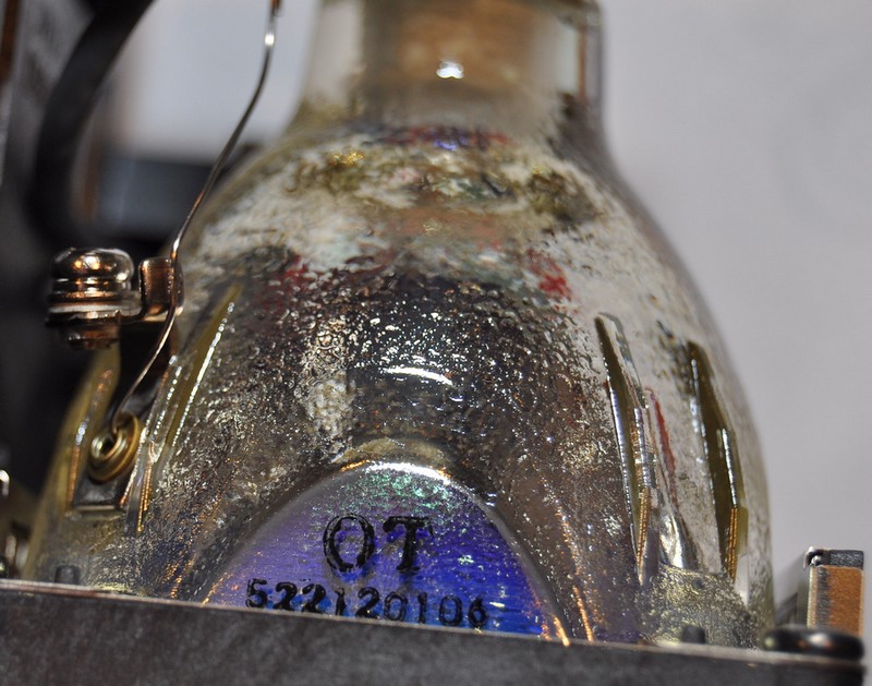

I have no knowledge about a new lamp design and that is why I said it's a newer lamp, which I believe to be true. They may have made subtle design changes and/or production/manufacturing improvements, or even sprinkled it with pixie dust , but hopefully the "7's" solve "5's" problems!
Is the number viewable by just taking off the back cover, or do you need to remove the lamp to see it? I was just wondering if it was easy/quick to check which lamp I have.

I believe the only change is the 5 to 7 in the number you see here. There is no substantial evidence that this is a newer or better lamp in any regard until enough time passes by to see if it lasts longer than the originals.

If this has already been posted sorry, could not take the time to read all of the replies. Seeing this is an issue with the RS50 was what we were looking for
We have a customer having this issue with his RS50. Rep had suggested cleaning the lamp window input.
Waiting for lamp to arrive so we can try this first.Attachment 217780
JVC RS Series low light output lamp window cleaning.pdf 388.005859375k . file
File Type: pdf JVC RS Series low light output lamp window cleaning.pdf (388.0 KB, 61 views)
