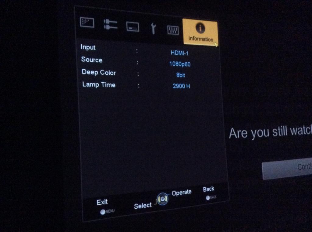

problem with my X3
I'm so frustrated with my X3. I purchased this June 2011. I had to replace my lamp 3 times. The first lamp was replaced free by JVC for premature failure. Now I turned on my PJ and the warning and standby indicators are lit solid and middle lamp indicator is flashing, so I purchased another lamp and installed it. After I plugged in the PJ, the standby light is on and then I power it up and after 1 minute the same indicator lights are on. So I reinstalled the lamp and same thing. I also did the remote lamp reset process (back, OK, hide, down button for 3 sec) and the indicator lights flash and then same result. The PJ will not work and the warning/standby lights are solid and lamp indicator continues to flash. Please help
sm1074 is offline
I'm in the same boat, but at least mine is working.
I also went through multiple short-life lamps, (and sure as hell didn't get a free one from JVC),
and just a couple months ago the front IR sensor stopped working.
Then yesterday the zoom got stuck and wouldn't move more than an inch in both directions.
I finally got it to move eventually, but now I'm scared to zoom it out again and get stuck there permanently.
These projectors are just pieces of ***** and I will NEVER buy JVC again.

Well it's been awhile since I've posted in this thread. Got a bum bulb like everyone else right outta the box back in 2010. Jtc stepped up for the second bulb that lasted a bit longer. Then I contacted mike at AV sales when the new bulbs with the flapper came out waaaaaaay back on 4/16/12 and got it shortly after.
So what am I blabbering about you may ask?
2900 hours from my #003 issued flapper jvc RS 40 bulb
I'm getting in a visual replace the bulb warning on the screen projected from the JVC. I'm sure the picture has gotten dimmer over the past two years bit I haven't noticed and all of my friends that come over always say how great the picture looks.
Fingers crossed that the next bulb delivers another two years of fun times, great movies, and some football as well

Wow, 2900 hours is amazing. My original bulb got really dim at ~600 hours, but JVC gave me a rev 3 replacement. I'm approaching 1000 hours now and it still looks great. So it seems like rev 3 / flapper really did address the issue :-)
JJ7 is online now
