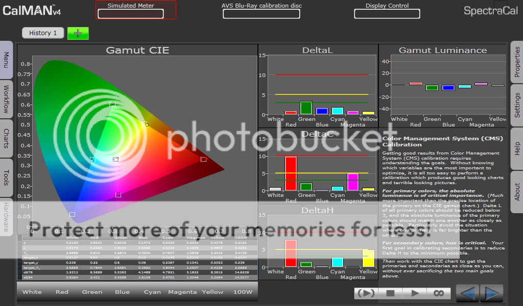

Below is the CIE for the Saturations in Film Mode, 6500K and Normal Gamma. As a side note, thanks Dan for your Epson calibration thread as I found it most useful after I got my 6500UB two years ago and ended up using your approach for calibration using the 75% saturation levels with great results. The RS40 looks more linear for the saturation levels than did the Epson.
Ron Jones
Thanks for doing these measurements! Yes, much more linear saturation than the Epson LCD projectors lately. This all make me wonder why all projector manufacturers don't have at least one preset that is targeted at a correct REC.709 gamut? Weird. This RS40 is looking very good for such limited CMS control. If you can recall, how do the blacks compare on this RS40 to your old 6500UB (with or without the dynamic iris engaged on the 6500UB). I'm very curious about this.

Many thanks to Buttabean for allowing me to check out his RS40. We had a great time today calibrating it.
It is really good out of the box. If Buttabean approves, I can post charts of what we did to it later.
I wouldn't have touched the greyscale. We did because the gamma was a little off. We dialed in a custom gamma of 2.3. The controls are much better than the RS20's. There was very little interaction between the levels. We got nice results.
Gamut was maybe not quite as good as Tom's sample but was the best I have seen as a preset.
I wonder very much if the calibration noticably improved the picture. That's a good thing. I did not have much time to really watch much but I am sure Buttabean will report if we made a difference.
What I saw looked really good. I think the RS40 is definitely sharper than my RS20. That was the biggest difference that I saw.
We also messed around with the FPD Benchmark disk and what the CMD did to motion. It was nice to see that the girl in the hammock scene no longer has the motion induced contouring issue. For that 1080i material, I think that the second DFI mode looked best. But, there was too much flicker for me with 1080p24 material. I think I would stick to plain old 24fps with no DFI or FI for movies.
Next time, I'll bring the RS20 and we can do a more thorough comparison.

Here is what we got for the RS40's gamut on Natural (Normal):
Affable Nitwit
Lawguy is offline
