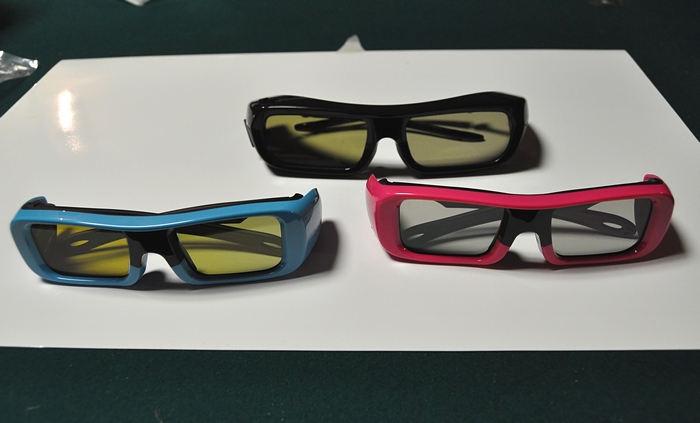

I picked up a pair of BR50 glasses to try out for a friend who has the HW30 and small kids who don't like adult sized glasses.
I ordered the polarizing lenses from Sony's parts website, $14.99 per set. They were supposed to be free but I ran out of patience with their customer service trying to get them to look up a KB article @ Sony which states they are supposed to be free.
The blue pair has the lenses installed, the pink pair doesn't have them in place. I'll check it out later tonight to go back to my M v A torture scene to see if these work as well on the HW30 as the new glasses.
btw, something happens when the shutters are activated, the color shift isn't anywhere near as bad as it looks by the yellowish/green tint you see in the photos with the glasses turned off.
I actully has a pair off the BR50 ( I like them best, light and fits my small head best ) who I tested against the PJ1, BR100, BR250 and Xpand 103
- there are allmost no difference between them ( performence/ ghosting/brightness ) that is both with the 90ES and the 30ES.

I will queue up this scene for you tonight and take photos to post. I use a Nikon D90 SLR on a tripod with manual exposure and an IR remote for firing the shutter to get clear images.
as a side note, I tested out the kids BR-50 glasses and they work identical to the new models that came with the projector.
also, I might have to rescind my original comments about 'no warmup times'. I was testing the glasses last night watching Monster V Aliens which is just overall torture for ghosting. it was so late, I feel asleep with the glasses on and the screen paused on a tough frame for ghosting. When I woke up 45 minutes later, the ghosting was almost gone entirely.
remember I have an HP screen which is very bright with a low hour lamp so I can see ghosting that generally hides on lower gain screens. I am going to validate my findings this weekend. It wasn't anywhere NEAR as drastic as the warm up necessary for the JVC, but definitely think I saw a difference from cold boot to 45 mins later.
