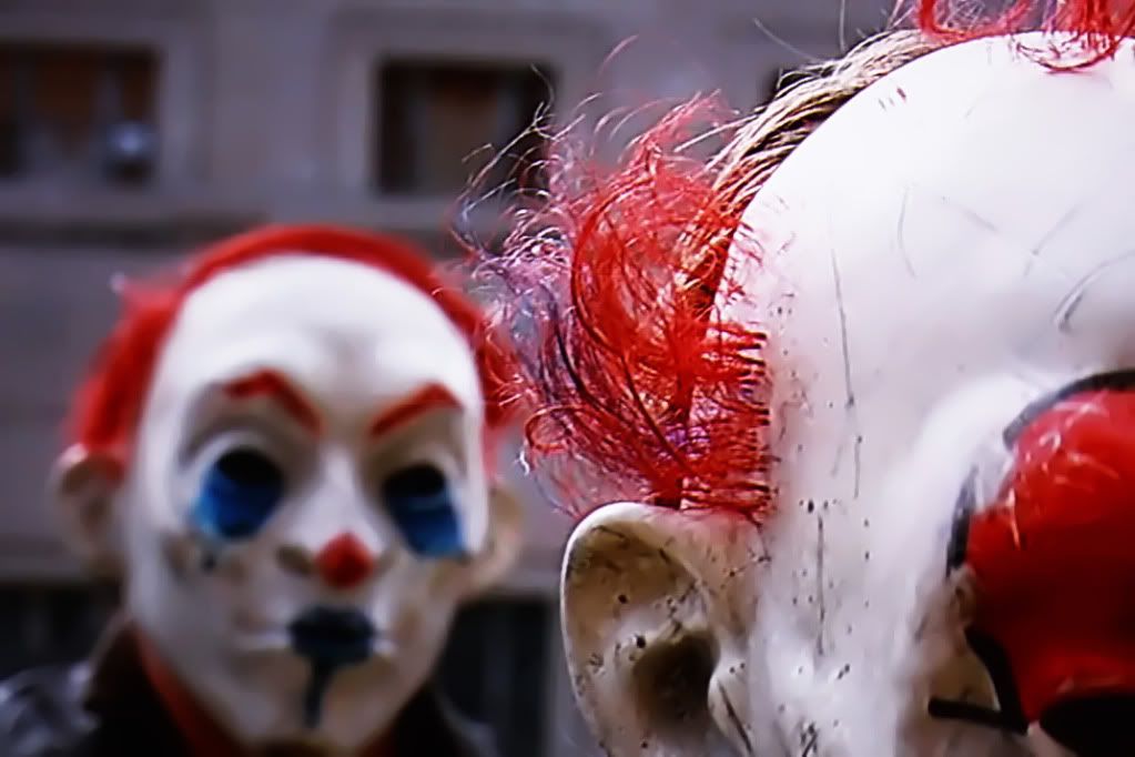

Some close up shots of the screen from the Dark Knight. Doesn't really do justice to seeing it in person but you may get an idea of the detail.

On the screenshot of the hd-350 vs the X70 I can clearly see the hd-350 has a more digital look to the picture. The X70 screenshot looks like there are no pixels and does have that analog feel to it which I like. Interesting indeed. It does sound weird that the X70 has both a sharper and smoother image at the same time...you would think that a smooth image would be less sharp, but Conan says it is close to DLP sharpness! Very nice!
