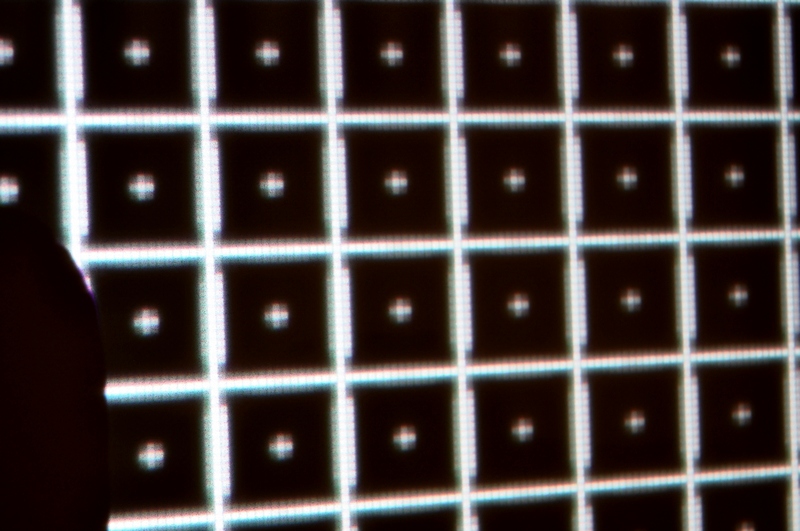

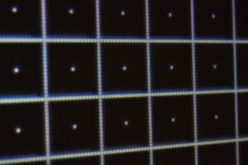

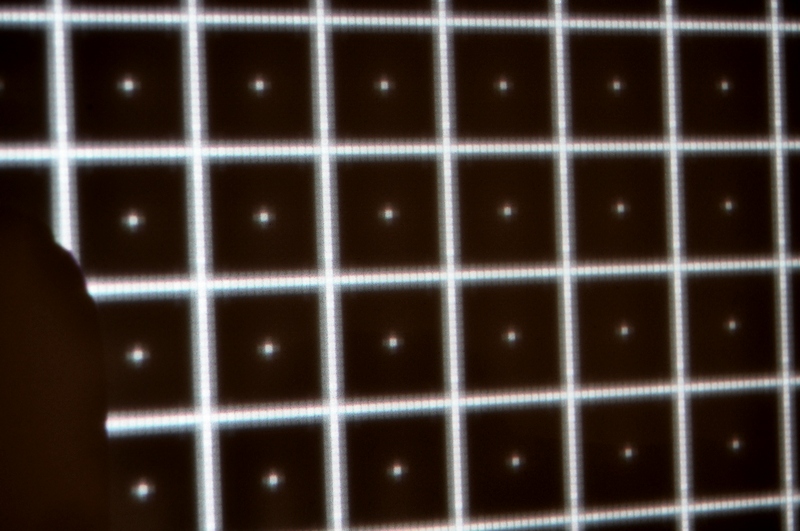

Originally Posted by greekwolf View Post
My apologies if this question has already been asked/answered.
Does the sharpness issue with hdmi also translate to the component input, as well? I wouldn't mind running the PS3/360 through component, until firmware addresses the hdmi situation.
I did some tests on this tonight before sending the W7000 back for the firmware update. The HDMI and Component are my Samsung 3D BD player and the VGA is my HTPC with Power DVD playing the AVS disk. I would say the Component input is worse than the HDMI based on the single pixel pattern test from the AVS HD test disk.
The VGA is nearly perfect.
HDMI
Component
VGA

Those VGA, component and HDMI shots are very interesting. I assume HDMI should look the best, right?
The HDMI should look the best with no pixel bleed. There is a slight bit on the VGA that I could have likely fixed with the analog clock/phase adjustments, but overall from seating distance, the VGA crushes the HDMI and Component image

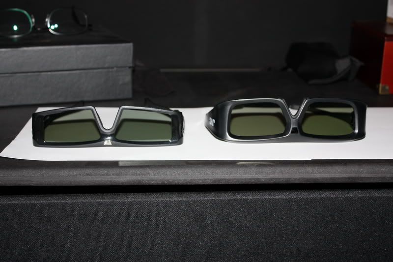

I have just received my W7000, and will only use it for 3D.
It came with 1.00-4 firmware, and 3D looks so good, so I'll wait and see, if the new firmware does anything on the 3D picture, before I decide if I'll send it in for a update.
The projector came with two pair of glasses, and I believe that they are different than the one zombie10k have, her are some pictures.
BenQ and the old JVC glasses.
There is a little bit of red tint with these, compared with the one pair of OPTOMA ZD 201 I have, but the BenQ's are more comfortable, if you use prescription glasses, as I do.

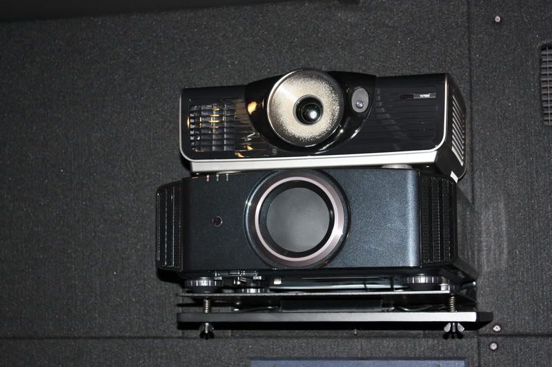

So far I'm very satisfied, the noise is louder than my JVC X3, that I use for 2D, but after a few minutes, I don't hear it anymore.
My two projectors.
