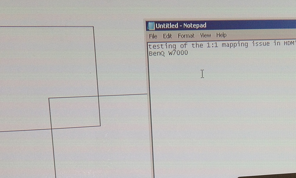

Edit: I just received the W7000 this morning, I wasn't expecting it until tomorrow. Things are looking good!!
I don't have a bluray player at work, only the same Thinkpad with HDMI out that I use to drive my BenQ SP890 at work. I had the W7000 right next the SP890 and I can thankfully say that my 1920x1080P desktop is crystal clear.. I did the single pixel box test in MSPaint and also some quick text in a notepad window.
It is a day/night difference than before I sent it back last week, at least in regard to a PC via HDMI @ 1080P. I won't be home until 10pm EST tonight, but won't go to sleep until I run it through the various tests and will post photos of the AVS HD single pixel tests via the BD player.
I only have my ipad camera at work, ignore the scan lines, they are a side effect of the ipad camera. I assure you guys the box is single pixel perfect and the text is crystal clear. I can't wait to try this out tonight.
zombie10k is online now

Wow! That is looking very promising. Can you ask them what the issue was?
