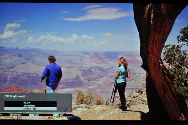

As I mentioned earlier, the brightness in Dynamic 3D is fantastic. Maybe some missed this post, but 1900 lumens in 3D is 2x what the others can put out in 3D mode.. that is something to talk about. The Contrast in dark scenes is better than the W7000. I would like to have seen the FI included, but the strong combo of brightness/color/contrast in 3D mode stands on it's own. The W7000 is still going to take the crown for complete ghost free 3D w/ FI, SBS, 3D console gaming, etc for those that are looking for more than just great 3D BD performance.
I'll post the 3D ghosting comparisons this evening and start updating the original post with 2D comparisons as the week goes on.

IMO, Art didn't spend enough time talking about the virtues of the 5010's 3D torch mode. This is a big deal when we are talking 2x the lumens in 3D than any of the other projectors. I love this mode.. it's the first time someone isn't going to think 3D is dim through the glasses. It's intense on my HP screen, you will squint coming from dark to bright scenes.. just how I like it.
black level performance in 3D on the 5010 is very good, as is overall contrast.

^^^ Zombie, how close is your 5010 (tree) photo to what you see by eye?
Reason I'm asking is because the 5010 photo looks a little overexposed and not sure if it is simply due to the increased brightness of the 5010 and perhaps your use of a fixed camera setting, or if it is somewhat less color saturated in real life. The detail does not seem as good as the JVC in those photos and I'm not entirely sure why. Look at the foreground/left boulders for example.
it's a little overexposed, I'll go back and re-take the photos if I have time later. I think the camera might have moved a hair when putting the glasses in front of the camera which is why the detail is a little soft. It's not like that in real viewing, it's quite sharp.

Joe - the Epson is a torch in 3D mode. On a white background in 3D mode, I measured ~1,900 lumens. The brightness is intense combined with the 2.8 gain HP.
after all the various combos, this one finally feels bright enough through the glasses.
