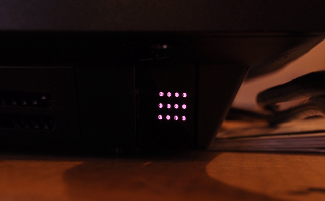

Guys here is the sound of the HW50 buzzing...
I will say given how load the fans are in the recording this noise is probably a bit exaggerated, although if using the emitter eliminates it I may go that route.
It is strange to thing the that the emitter is doing this and quite possibly is a defect.
Here is the link:
http://soundcloud.com/tj-demonte/hw50-buzzing

Originally Posted by shadow39 View Post
Just wanted to report a quick fix if you have the buzzing sound when in 3D mode on the HW50, I have found the source of the buzz and its coming from the integrated 3D sensor on the projector. Since I have the HW30 as well here is a quick fix, take the external sensor that comes with the HW30 and plug it into the HW50 and that seems to bypass the sensor on the HW50 and eliminates the buzzing. It's a band aid approach but does show a faulty sensor is the problem on the HW50. I have recorded the noise but not sure how to attach it to the post so if someone could let me know I can add that as well. I can also now report this to Sony and hopefully they can find a fix a lot quicker so I hope this helps everyone who has a HW50.
Does the internal sensor still work when you have the external sensor plugged in?
Here is the link:
Nasty sound with odd harmonics. Not only high frequency.
Sony must fix before i consider buying.
I think when I plugged the external sensor in the internal was not active but I will have to double check to make sure Jason. It was weird because when I even pushed the cat5 end into the projector even just half way the buzzing sound stopped instantly.
shadow39 is offline
Yes that's the sensor, TMR PJ1 3D emitter, I was working with very little sleep so forgot to say the model number so thanks for adding the link and all, I also recorded the buzzing on my iPhone 5 and sent it to tehotaone and he says he will provide a link so anyone can hear it.
Perhaps if the internal sensor stays on, Sony can send us a little dongle to plug into the port that eliminates the sound. Better yet, they should fix it at the factory or through a Firmware update. (Do these things even have user upgrade-able firmwares?) Guess its a good thing my room is not finished and I told Mike to hold off on shipping my pre-order.

it took me a minute to find the sensor when I first unpacked the HW50.
The IR seem's powerful, I can go pretty far without losing sync.
zombie10k is online now
Thanks for the info. I'll let you guys know if I hear it on this particular HW50.
How noticeable is it from a few feet away?
Well hopefully your doesn't have this problem, it sucks cause convergence is excellent as well as focus across the whole screen is great too. Call me crazy but I'm a little disappointed in the brightness as it doesn't seem much brighter than my HW30 and I'm using a 1.7 gain screen.
As far as the buzzing sound you can detect it from over 10 feet away so it's something that shouldn't be there.

I jumped up two support levels at Sony and they acknowledged the buzz and are working on it. Not sure I believe it but they think they can fix it with a firmware update. I'm going to give them a week and then call back.

I posted this earlier today in the other two Sony threads:
Okay, here is the scoop on the buzzing. The noise is caused by the vibrating of two capacitors. There are two solutions. You can reduce the IR output strength in the service mode or use an external IR emitter. Sony will furnish an external IR emitter to those that have this issue once Sony verifies the serial number on your projector. Not all units will have this problem and that is why Sony will need to verify the serial number. Customers that have purchased from us that have this issue, please get in touch with us.
mjgarrett100@gmail.com
Where does the external emitter go? Can I plug it into the back and then sit it on the top (bottom actually since the unit is on my ceiling upside down)? Or does it have to be cabled to the front of the room?
thanks!
thanks!
Yes, it plugs into the back and you can place it on the projector.
Nice to hear Sony stepping up and providing customers with the external emitter.

FWIW I received an external emitter from Sony last night. Have not tried it yet. They sent it no charge in response to my complaint about the buzz.

Anyone received their extra lamp? I haven't. I did receive the external emitter though.
Any update from Sony on an actual fix for the buzz in the projector itself?
