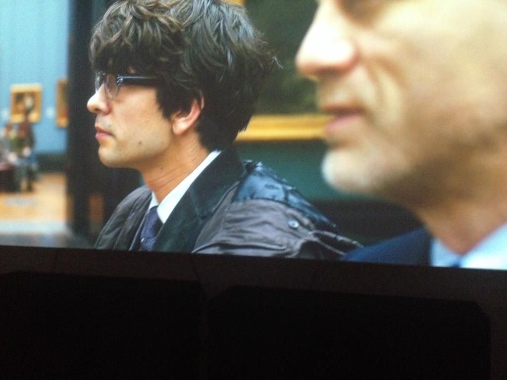

I am having an issue that I wonder if anyone knows how to deal with. I put on a 2.35:1 movie Skyfall and the projector goes to the settings that I saved. Then I put on another 2.35:1 movie MI2 and it processes and does not fit in the screen like Skyfall did. The same thing happens with 16:9 movies. And it always seems the movies extend below the screen, never above. See pics below
Skyfall
MI2

Depends on the source and the mastering.
You should calculate a small spare, when you set up the screen settings for automatic lens memory.
For example:
If you fit up the screen settings for an 1:2.39 or 1:2.40 movie. A 1:2.35 movie does not fit.
If you fit up the screen for 1:1.85 movie - the next 16:9 (1:1.78) movie does also not fit.
Otherwise you could set up the settings for the most important screen formats, and switch manually to the right format which is saved in Lens Memory.
You should do it for: 1:2.35, 1:2.40, 1:1.85, 1:1.78. Optional for 1:2.20, 1:2.50. For the old 1.1.33 format you can use the 1:1.78(16:9) setting.
Additional you should use the blanking function.
For example:
What is the blanking function???
Claybe is offline
Old 07-10-2014, 05:52 PM
cinema1fan's Avatar
Join Date: Mar 2014
Posts: 29
Please look at your manual (page 76 - Lens control menue - masking area).
A blank mask set the bars arround the picture to deep black.
For example:
1. Configure the lens for an 1:2.40 movie exactly to your screen
2. Use the upper and lower masking area to blank out the bars.
3. Save the screen settings and use it for automatic 1:2.35 lens memory
If the movie is now 1:2.35, the black bars are smaller. So you will lost in this settings some lines, but the picture is fit to your screen.
I set my CinemaScope to 1:2.35 for automatic lens switching, and blank a little bit more for extra wide movies.
The function is also very useful to blank the left/right bars for 16:9 or 4:3 movies.

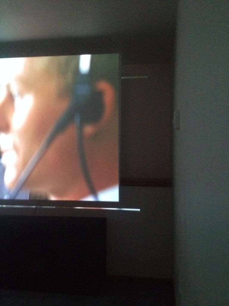

Hey everyone,
I have an issue with my new projector that I haven't been able to find much info on. I have a blue tinted streak/area along the left side of my screen when zoomed out for 16:9 projection. This streak completely disappears when zoomed in for scope viewing. It is very noticeable during dark scenes.
I tried manually zooming in to expand the picture little by little, and there is an exact spot shortly after expanding past the top and bottom of my scope screen where the blue tinted area completely disappears. While zooming back out to shrink the screen to fit the 16:9 area, the blue tint returns at the same exact position every time. This happens before actually reaching the final 16:9 image size.
Also, I'm having issues with the focus. I save the settings for my different aspects, but after a day I will return and the same setting will be out of focus. Not only that, but it is almost impossible to get even focus all around when using my HTPC or even with DirecTv.
I did see something mentioned about the focus a few pages back so I'll re-read those posts.
After spending so much money and time setting everything up, this is a bit disappointing and slightly overwhelming just to think about having to deal with repair.
Sorry for the grainy picture, but I think you'll be able to see what I'm talking about. I also shot a video of the bar appearing after zooming but am struggling a bit to get it uploaded.
Thanks everyone

Originally Posted by S Russ View Post
Hey everyone,
Thanks everyone
The picture you made is grainy and ugly. You should use a better cam. Sorry.
Ok, back now to your blue tinted streak problem - this is not ok - I think. Is your PJ in warrenty?
If you need a picture to comparing yours, give me some movie examples like Gravity, I will look for a dark scene and send the screenshoot to you. May be we could handle this with PM.
Ps: Focus issue in automatic lens memory? - I have no long time experience with the (6000) / 8000 about this, because the the new one is not fixed installed (build a new beamer rack). But I can say for a couple of days - it works fine. You know, the pana beamer is not really flexible, because it has no motorized lens shift. Read only about some problems for beamers with automatic lens shift. But also nothing about focus, more like to bring the screen to the last 16:9 / 1:2.39 memory position.
