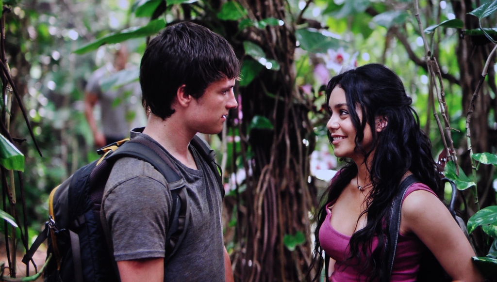

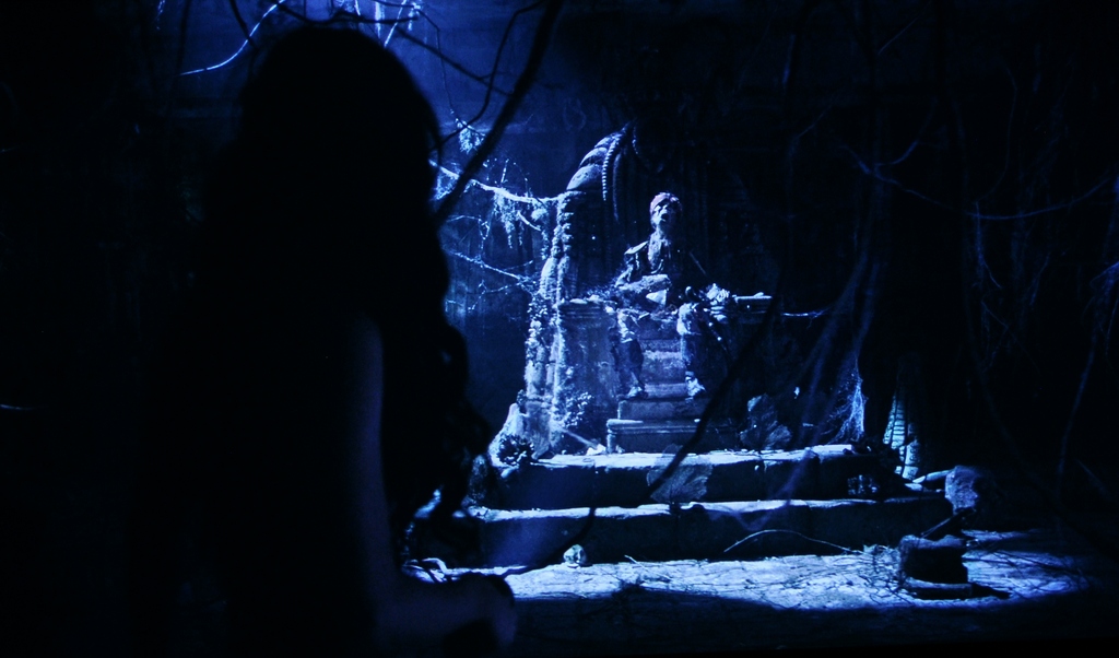

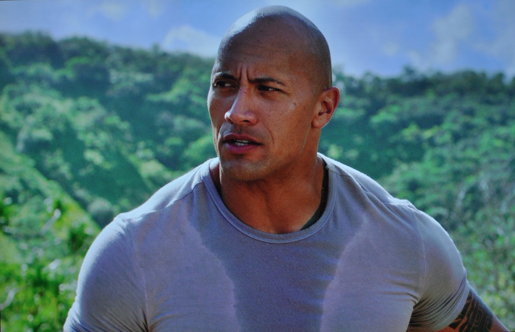

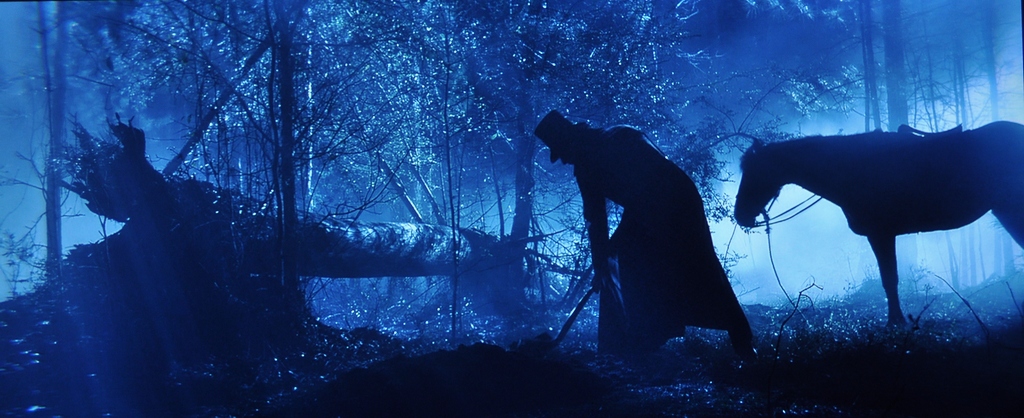

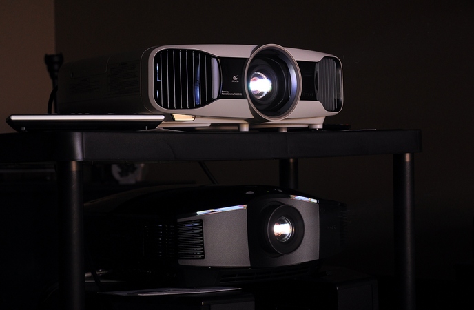

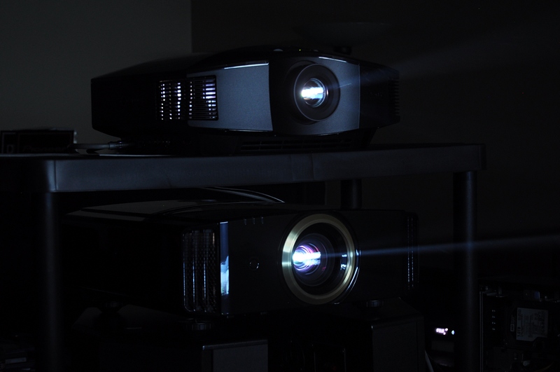

I spent about 6 hours tonight going back and forth between the HW50 and 5020 in 2D and 3D.
A few notes to keep in mind:
  • neither projector is calibrated in 3D yet behind the glasses, these are out of the box settings. The HW50 is set to Cinema mode and the 5020 is on Cinema1.
  • Even though the 5020 is sitting 12+ inches above the HW50, it appears a 'notch' brighter than the HW50. This makes sense since the HW50 measured ~1064 lumens in this mode and the 5020 is ~1400 x the 2.8HP, so there is a bit of difference here.
  • On the 5020 in 3D mode, super-resolution is not available. I used the Darbee set @ 40% on the Epson 5020 photos to see if we can match the Reality Creation processing.
  • For DV- I don't see a big deal about the 5020 iris in 3D mode, I haven't seen any scenes where it makes a noticeable difference. By all accounts of quick A/B swaps between both projectors, these are very similar in appearance during low light scenes, despite the 5020 being a bit brighter.
  • all 3D photos are through the left eye.

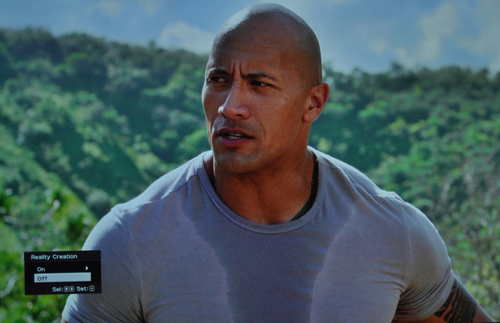

Sony HW50 - RC = OFF
Sony HW50 - RC = ON, Resolution = 40%, MPEG = low - RC does a nice job here bringing out details in the 3D animations

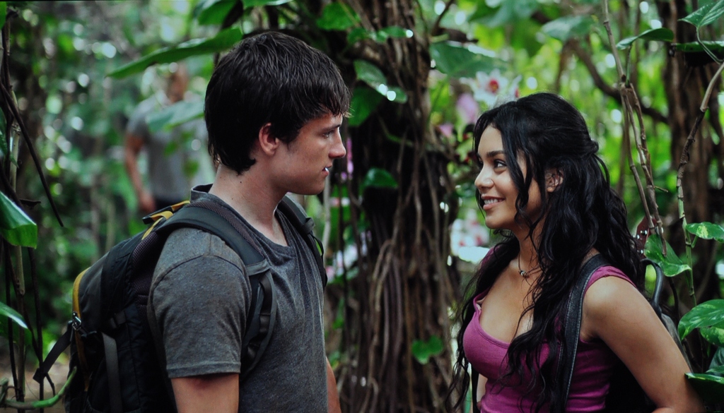

Epson 5020 - Darbee = 40%

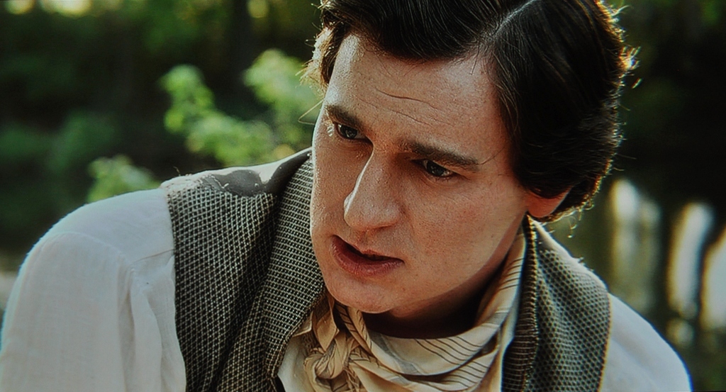

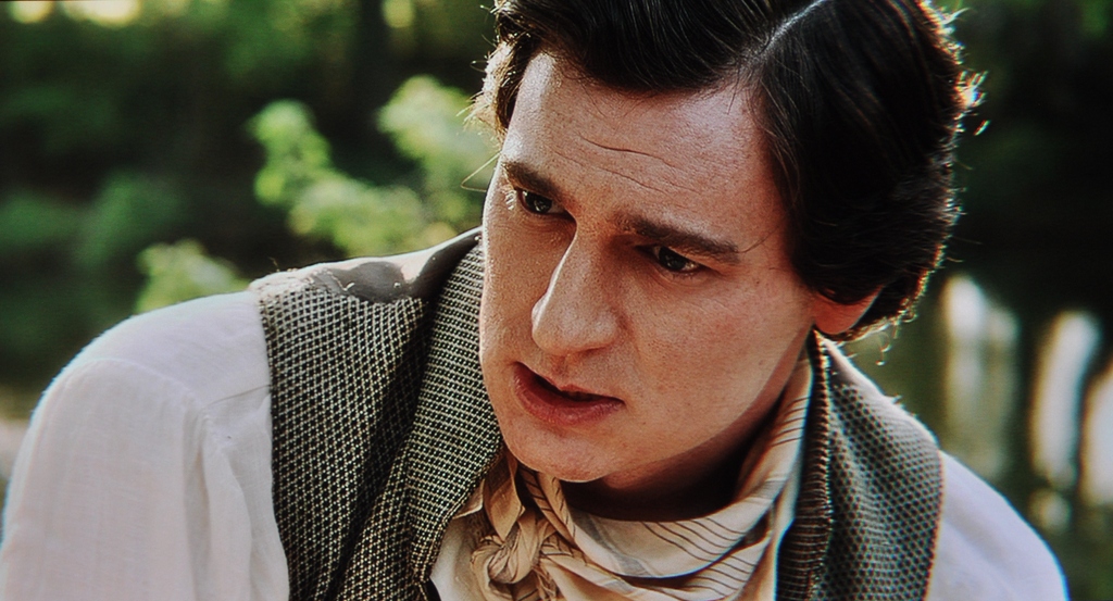

HW50 - Abraham Lincoln Vampire Slayer - great movie!!
Epson 5020 - Darbee @ 40%
Sony HW50 - RC = ON, Resolution = 40%, MPEG=low

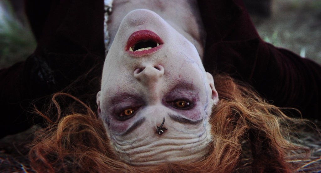

Sony HW50 - RC = ON, Resolution = 40%, MPEG=low - this vampire is a hair out of focus, but a great scene with good detail under the eyes.
Epson 5020 - Darbee = 40% - this combo looks good in this scene.

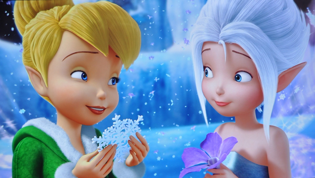

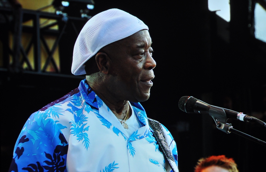

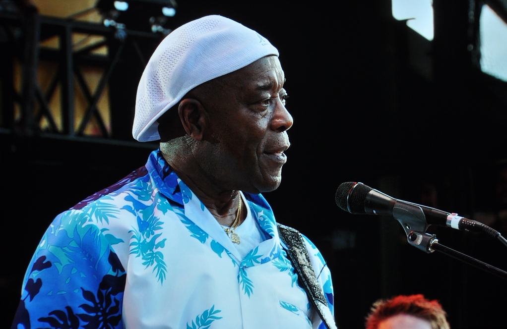

Sony HW50 - RC = ON, Resolution = minimum, MPEG=low - Buddy Guy!
Epson 5020 - Super Resolution = 3
Epson 5020 - Super Resolution = 3, Darbee = 30%

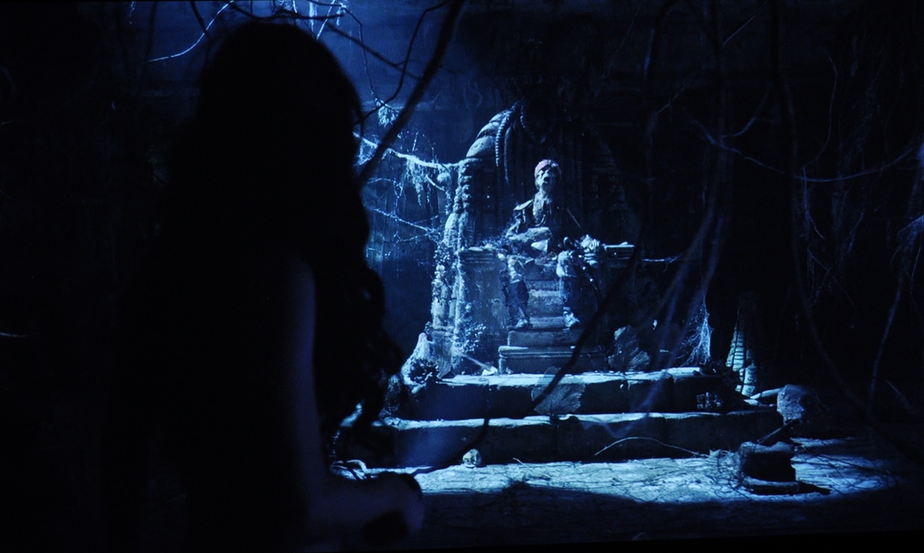

Sony HW50 - RC = ON, Resolution =40%, MPEG = LOW

Zombie thanks so much for the screenshots!
This kind of confirms my observations that the Sony is a bit too soft, and really does require RC to bring it back to a level of sharpness that I can live with. The same may be true for the Epson though, I cannot tell for sure as I never have spent enough time with one in person.
Would love a screenshot of Sony vs Epson *without* any sharpening enhancement to be able to judge native sharpness. Also macro shot of pixel substructure would be immensely helpful to understand what the pixel fill rates look like.
Some things I noticed from your shots:
-RC is better than Super Resolution at bringing out detail (but possibly RC adds more noise to solid colors?)
-In Dark scenes Epson's bright areas are brighter, while blacks are maintained.
-Overall more pop on the Epson on average scenes. (whites are whiter/brighter, while blacks maintained)
-Color much better on the Sony, very clearly seen on the last shot with boy and girl in the jungle. Skin tones! Epson with blue push? Surely this can be calibrated / tweaked.
