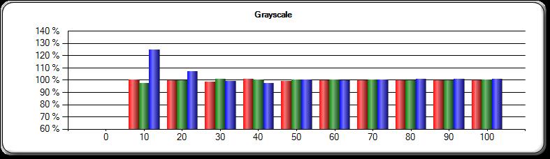

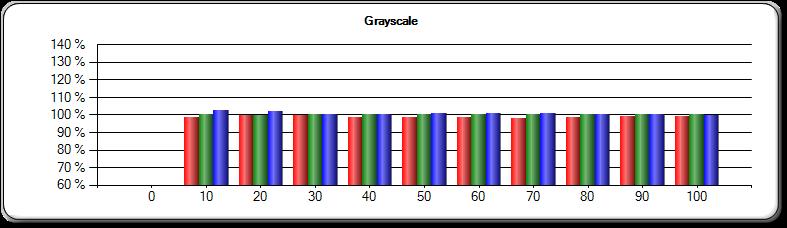

Quick D65 / Gamma calibration on the HW50 and Epson 5020.

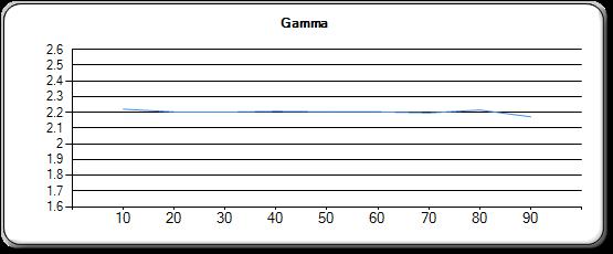

The HW50 @ 2.2 gamma, at least on this sample, is excellent
This HW50 had a strong blue push that needed to be tamed. Once corrected, the colors track well.

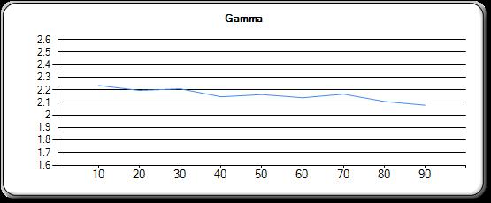

Epson 5020 - 2.2 setting

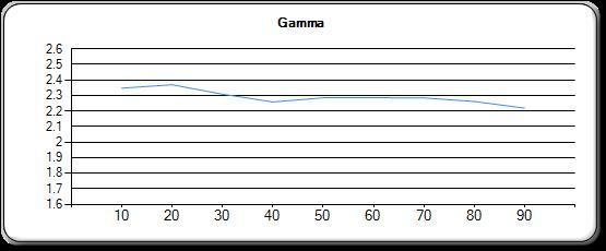

Epson 5020 - 2.1 setting - gamma is going to need a custom tune to get it a little closer to expectations
Epson 5020 - post calibration - I can see the blue push @ 10% and it levels out a bit @ 20%. I have to play with this further to see if I can match the HW50 from 10-100.
