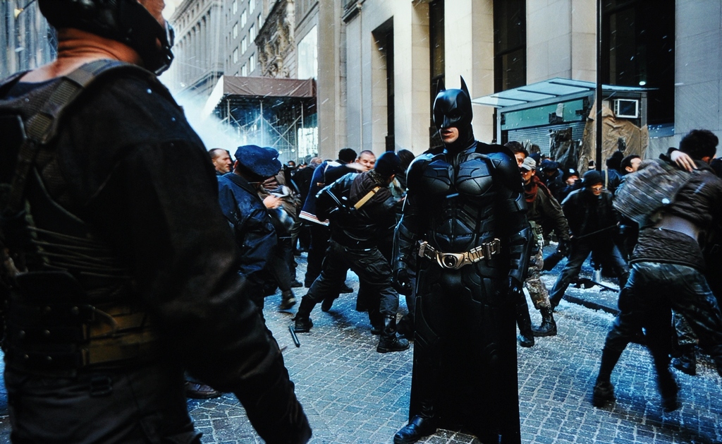

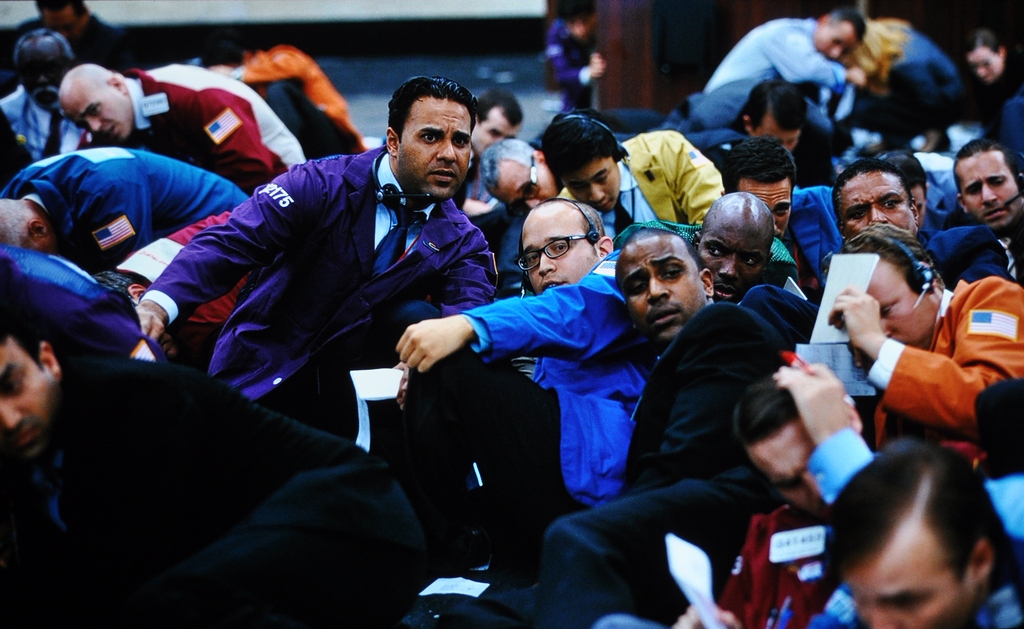

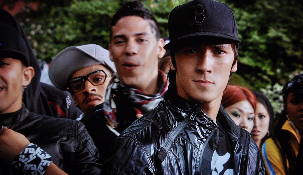

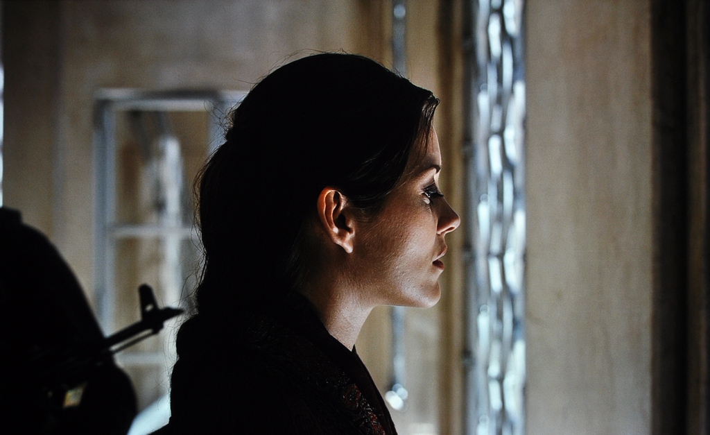

One of my favorite 3D demo disks (with real people) is Step up 3D. I don't know what camera they used to film this, but the 3D is crystal clear in this movie. There's a number of 'battle' scenes I used now as a reference since the 3D director was very creative overall. It's also a good disk for testing flesh tones after a 3D calibration behind the glasses.
Some through the glasses shots of the 5020, post 3D calibration.

The HW50 is not going to look soft. If you get it, turn the Reality controls down to either 10 or minimum depending on your preferences. The 4810 has e-shift which is a similar enhancement tech to compete with reality creation.
With 3D, you need as much initial brightness as possible because the 3D glasses use up nearly 80% of the light. The HW50 is brighter than the RS46 and nearly 2x brighter than the 4810.
HW50, 3D left eye on my 142" screen
2D - Reality creation @ minimum setting
