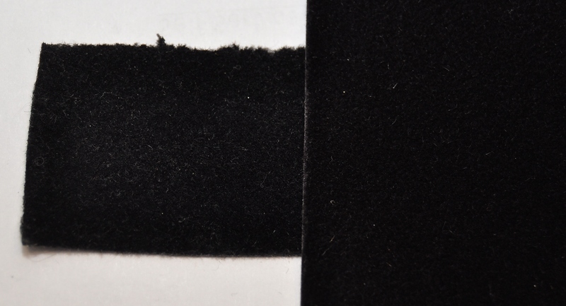

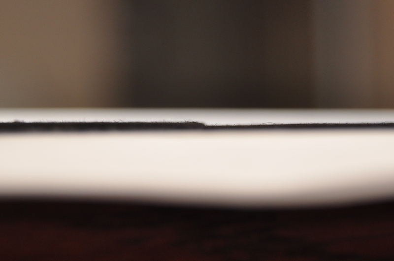

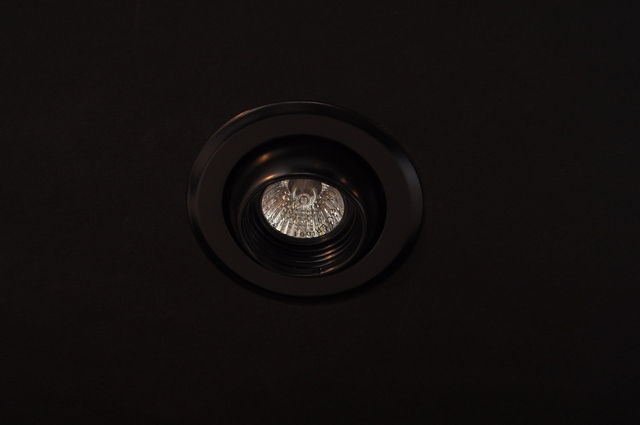

for those following my blackout project, I received a small truckload of the black 'ProtoStar' material that is often talked about in the HT build threads.
http://www.protostar.biz/flock.htm
I have a ton of the Dalite 'Pro-trim' which is an excellent material used to cover the Cinema Contour frames. I was saving this for making masks for my 16:9 Dalite CC. I tried some of it on my white ceiling grid, but the problem is it's too 'thick'. So it stands out a bit vs. blending in with the new flat tiles I am using.
The good news is, the ProtoStar material is just as black and also thinner as well. Plus it's significantly cheaper.
This is a direct flash photo, so you can see some of the texture. This stuff is about as black as it gets.
Dalite trim on left, ProtoStar on right.
Thinner = better for my particular need to black out the grid.
almost done.. everything is coming out better than I expected.. very classy looking. cool.gif

Beautiful Zombie! cool.gif That protostar is great stuff. I have a sheet of it here from about 5-6 years ago that I am finally going to put to use below my screen to cover up the red flash from the 7000. It looks like it will be just dark enough from my tests to do the trick.
