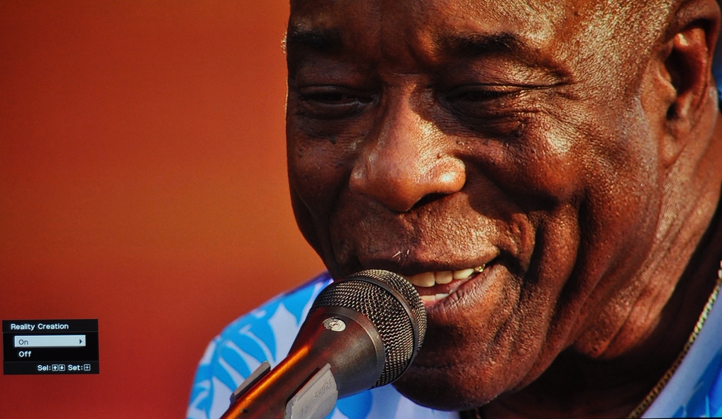

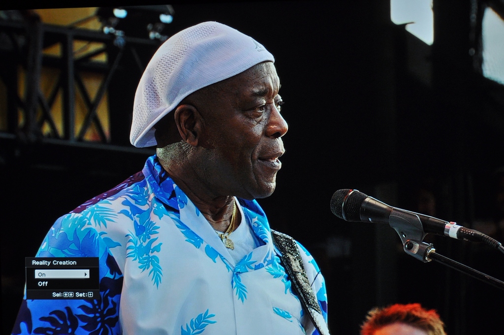

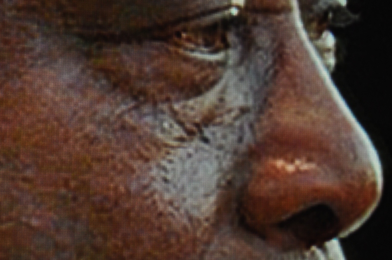

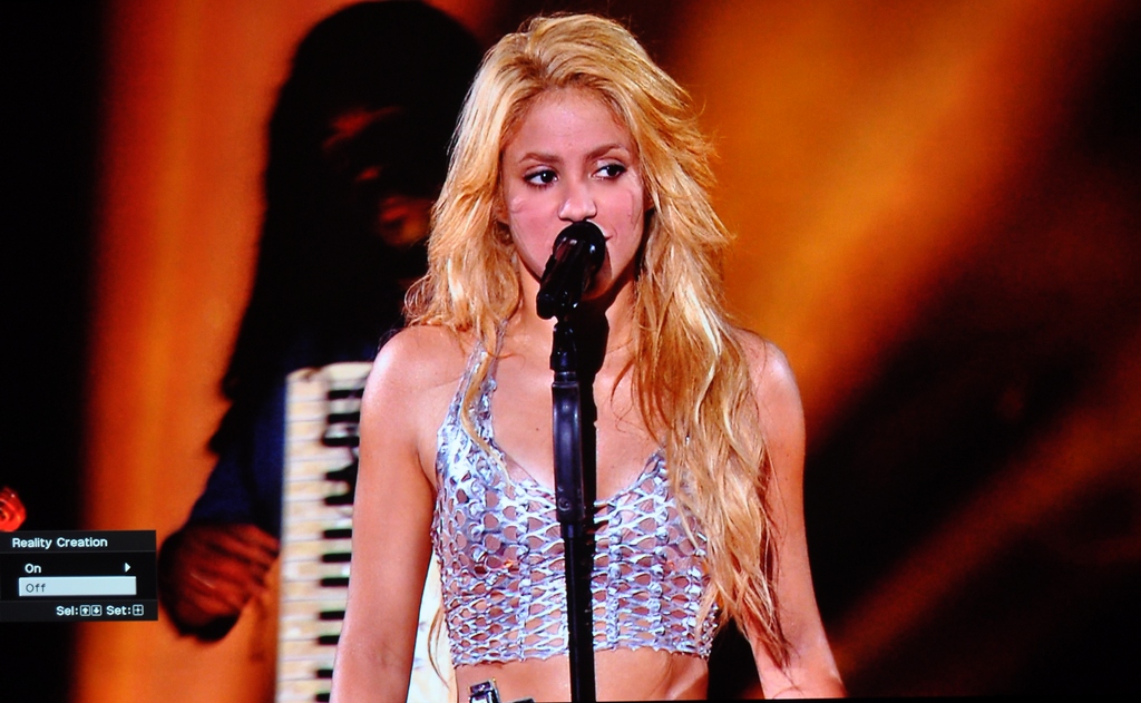

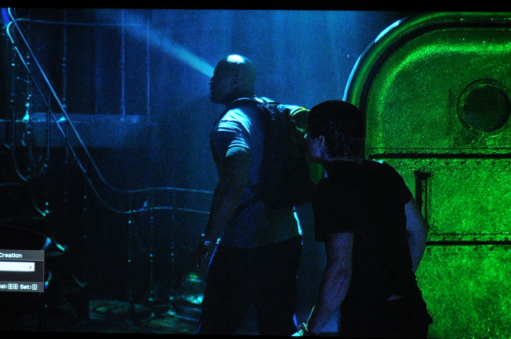

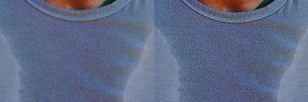

Some initial observations of the RC.
1. With the RC turned off, the HW50 appears very similar in PQ to the HW30.
2. Pixel structure clarity is about the same as it was with the HW30.
3. IMO, the vast majority of the PQ differences between the 30 and 50 is the RC sharpening process. It's a bit overcooked out of the box, but has a number of options to adjust the settings.
4. RC and Darbee processing are quite different when inspected close up. There are some examples in the photos below.
5. (off topic but relevant, color looks very good out of the box!)
The difference is striking at first with RC=ON, it's much more drastic than the Darbee @ 50%. It looks good at first glance, but it can do a number on the noise in the background. Most eyes are going to be drawn to the noticeable increase in perceived sharpness, but the sharpening is taking effect on the entire image, so noise will stand out with the default settings.
Next I want to experiment with various settings of the RC. Like the Darbee, when used in moderation, can add to the overall PQ. I can see plenty of potential with the RC sharpening process and will post more when I find a good balance of the RC + Darbee on the 142" @ 1.25 sw.

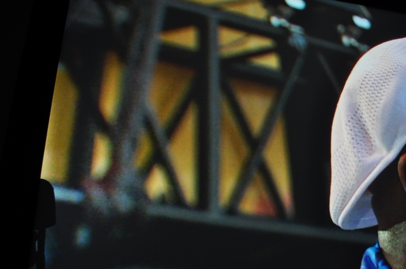

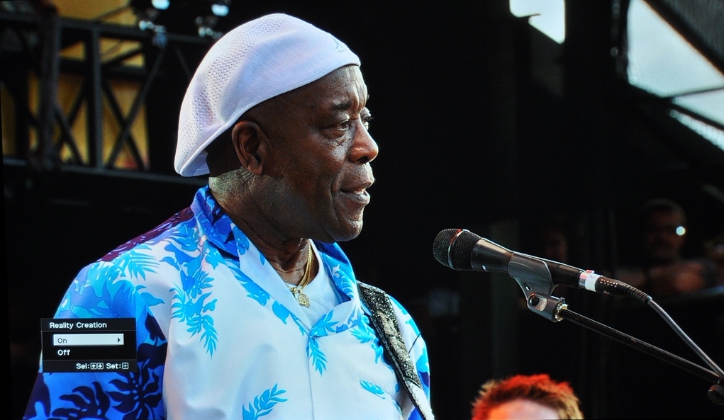

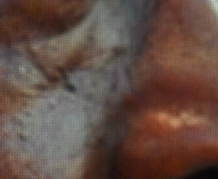

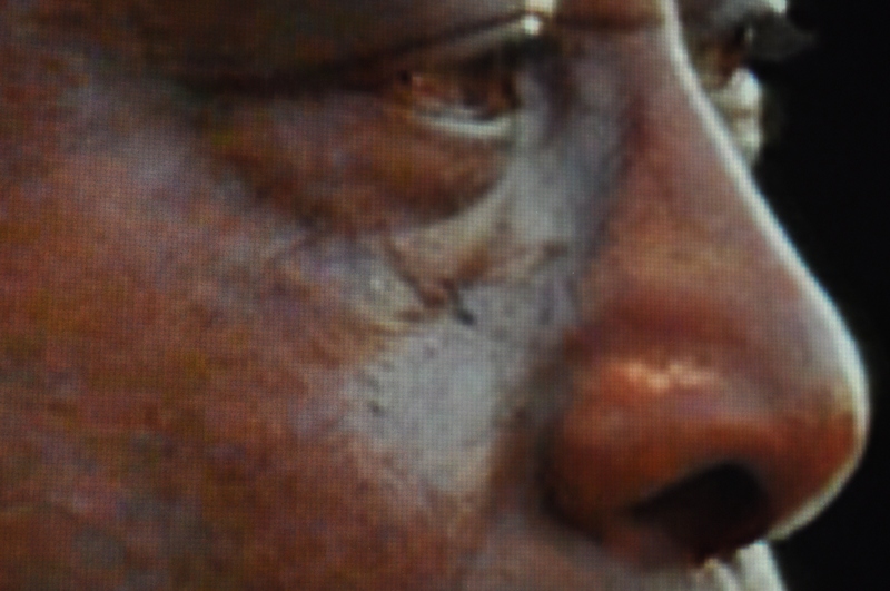

The camera is quite close to the screen for the first set up closeups:
Pixel Structure:
Sony HW50, RC = OFF, Darbee = OFF
Sony HW50, RC = OFF, Darbee = ON @ 50%
Sony HW50, RC = ON (Default settings), Darbee = OFF
Sony HW50, RC = ON (Default Settings), Darbee = 30%
Sony HW50, RC = ON (Default settings), Darbee = OFF - The default RC settings can make background noise noticeable.

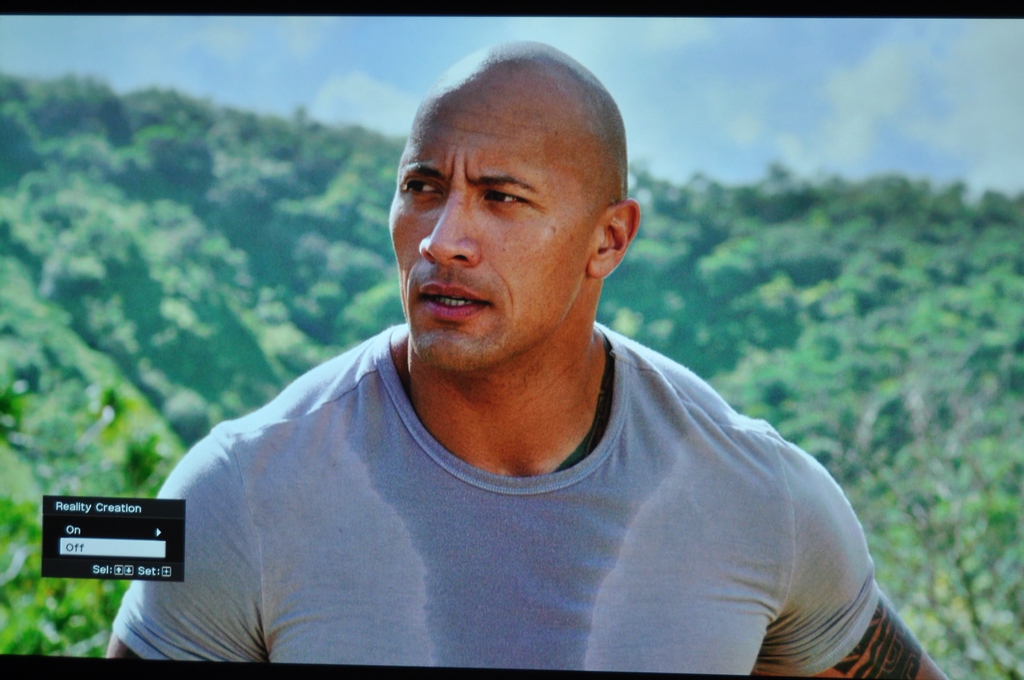

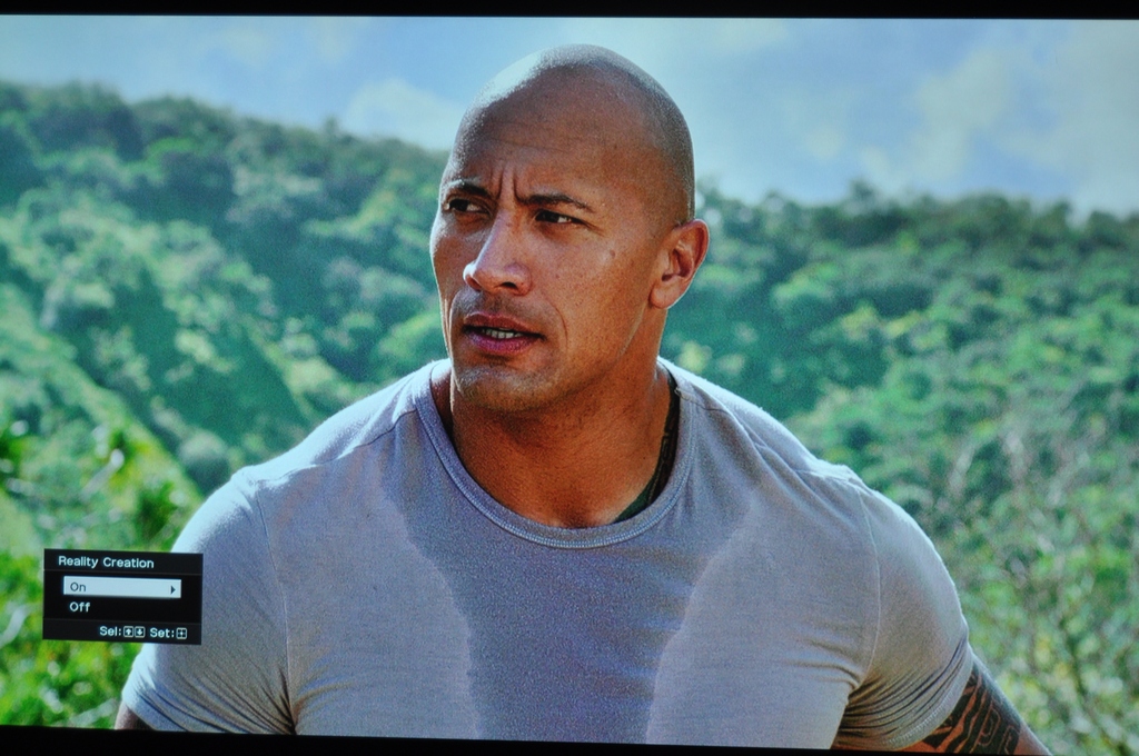

edit: back to the RC for a few minutes. I turned the RESOLUTION setting all the way to minimum. MUCH better now.. it adds just enough sharpness to appreciate the difference but not overdoing it in the background or making it look overly sharp.
Overall, out of the box PQ looks very good (provided the RC resolution is turned down a bit). Based on first impressions, I would prefer the HW50 with the RC over the HW30 with the Darbee.
RC=OFF, Darbee = OFF
RC=ON, Resolution = Minimum, Darbee = OFF. This looks very good without being overdone. There's an increase in perceived sharpness & detail in the face, hair, etc. The noise is reasonably controlled in the background with this setting

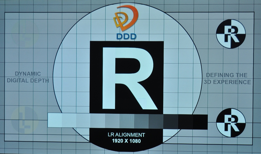

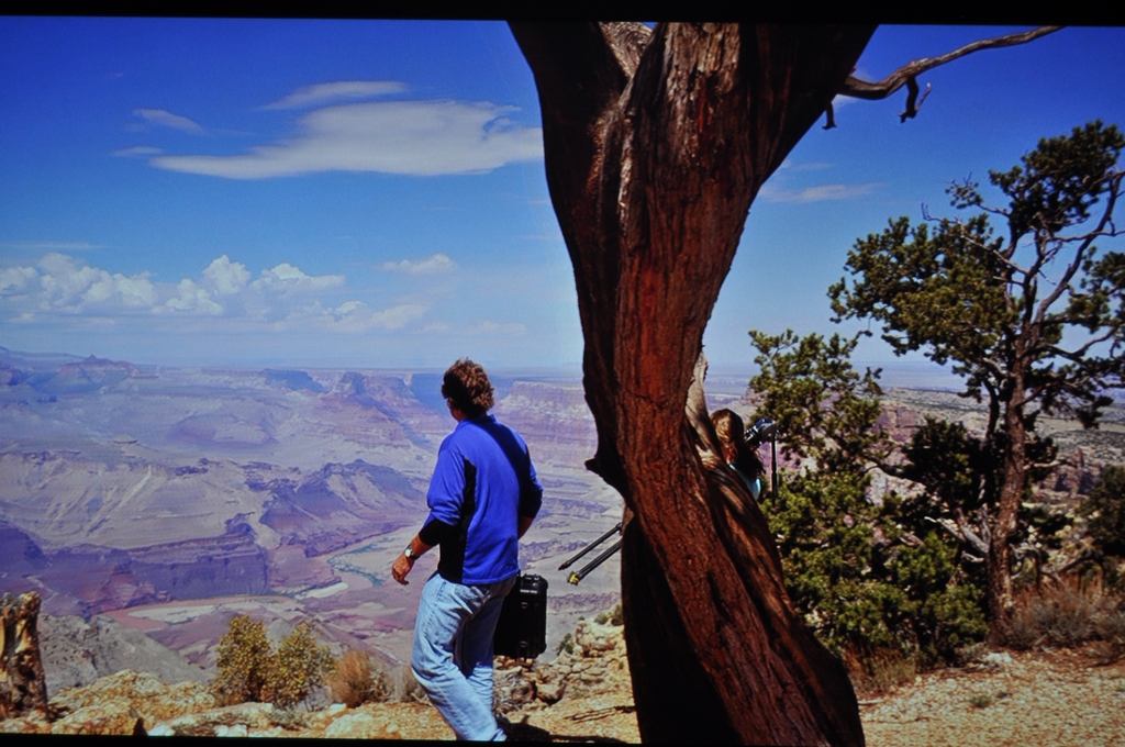

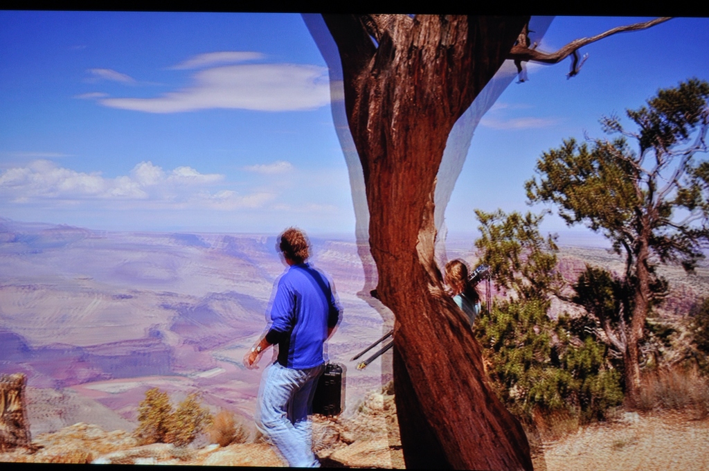

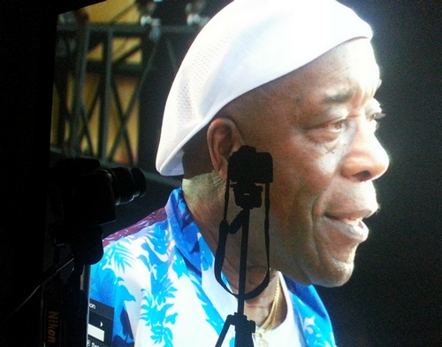

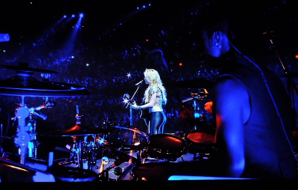

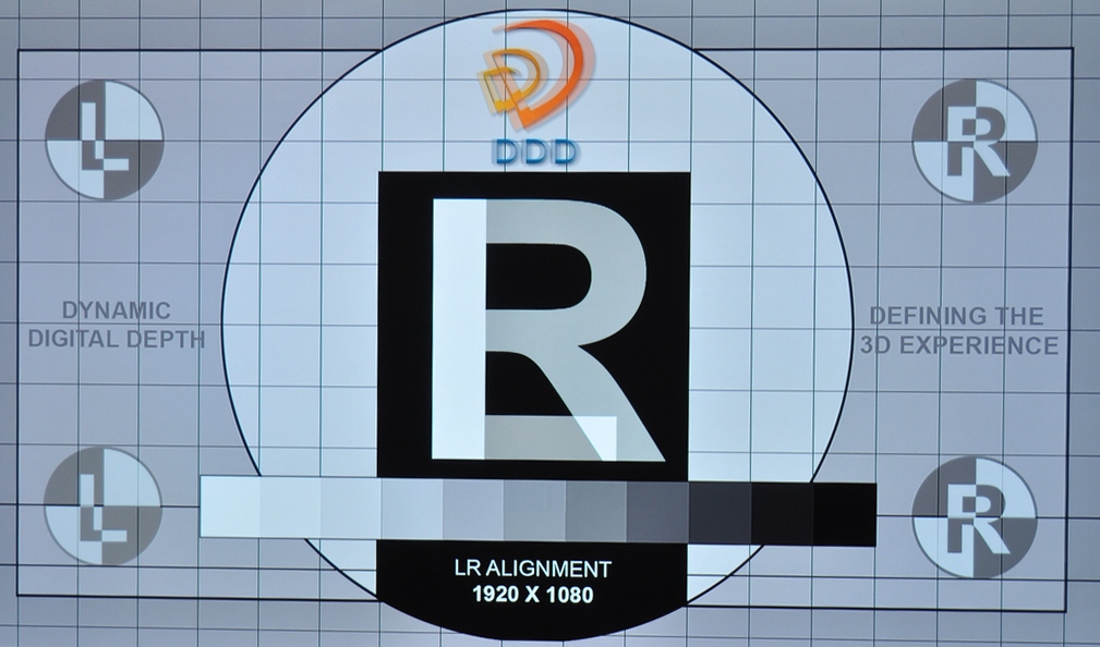

edit- adding several 3D shots through the glasses.
Factory glasses, left eye, brightness set to 3. 3D crosstalk performance is near identical to the HW30. I haven't had a chance to re-tune the MV3D's yet, I'll get a chance to do that soon and will report back.
Observations:
  • we can see the faint outline along the side of the tree in Grand Canyon. it's subtle and stands out a bit more with the RC turned on, but overall very good 3D performance in this tough scene. Only the DLP's can reproduce this scene with zero errors.
  • The RC was set to 50 Resolution in 3D mode and I thought it was a little overcooked, so I lowered it to ~40. It looks good, but started to notice some artifacts when watching Journey to the Mysterious Island 2. Look at 'The Rock''s shirt. The increase in noise is replicated in 3D, so there is a bit of strange pattern that my eyes are following since it's now in 'stereo'.
The W7000 with the Darbee @ 30% is very sharp and clean. I have to do an A/B with the HW50 and W7000 on this specific scene (and the night scene as well) to get a better understanding of the effect RC has on the background noise. I also have to experiment with tweaking the noise filter. I wanted to give an idea of what it looks like 'out of the box'.

FINALLY! I have some time to fire up the HW50.
Taking a first impression of the RC. I heard it comes from the DNA of Gods. smile.gif
Stay tuned for some RC off, RC off + Darby, RC + Darby, etc.

Some initial impressions on the RC vs. Darbee on Post #2. It's getting late, but have to check out some 3D first. cool.gif
