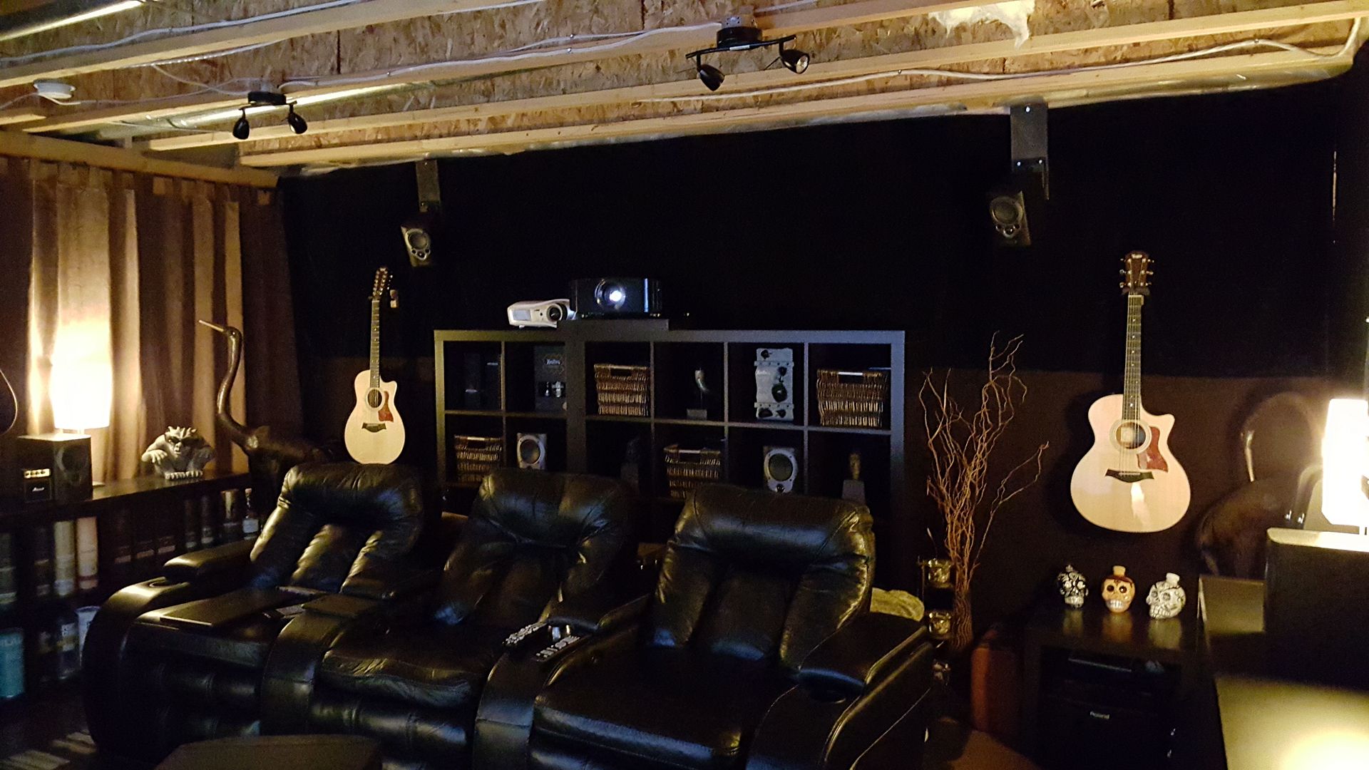

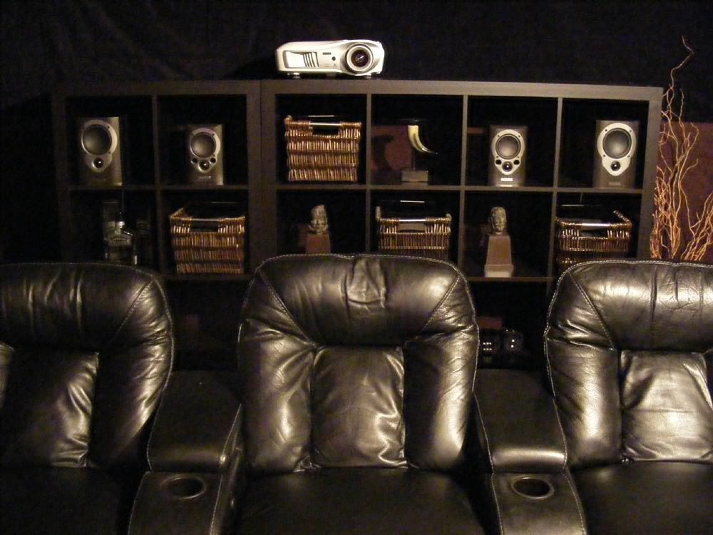

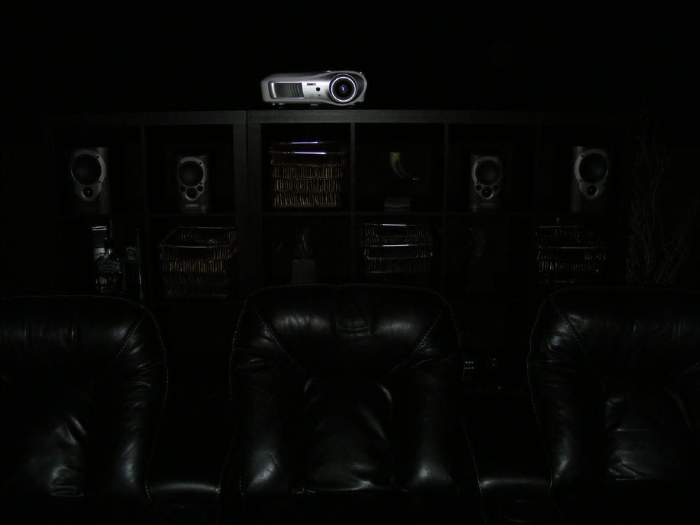

It was just supposed to be a temporary fix to make an otherwise unused basement storage area into a make-shift man-cave,
it's since become the favorite room in the house and has remained basically unchanged for over 4 years now.
It's near impossible to get good pic's of a totally blacked-out bat cave. My camera's flash just gets absorbed by the Black Velvet sponge!
I have to bring in additional lighting just to snap a decent photo
Amazing Video/Audio improvement, and all I needed was a staple gun and a discount card for Fabric Land.
Since I have no drywall at all, there are no sound reflections, and my entire room acts as a bass trap.
I went with a rich deep black velvet on top half of the room, brown on the lower half, then added just enough textures and accent colors,
that were pulled from the border stripes of the area rugs making the room feel a little warmer with a mix of chocolate brown and dark moss green earth tones.
some before/after shots...
Screen wall just before insulation and velvet
Dark Moss Green Velvet screen wall...
Even with a couple strategically placed lamps turned on the image is pretty good because the side/rear walls don't bounce the light back onto the screen...
lights out and my 120" pops like a giant plasma... ( PJ is a 4 y/o Epson 1080UB, screen is 4 y/o motorized 1.3 gain I found on ebay new for $250 shipped)
What are the four speakers in the back for?
Two of them have since moved up the ceiling for Rear Height,
the other Two are Surround Back speakers ....(Atmos 7.4.4 setup)
I've also since swapped out the Epson for a new JVC X750(RS500)
just need to button up that ceiling now
more details in my build page (link in sig line)
