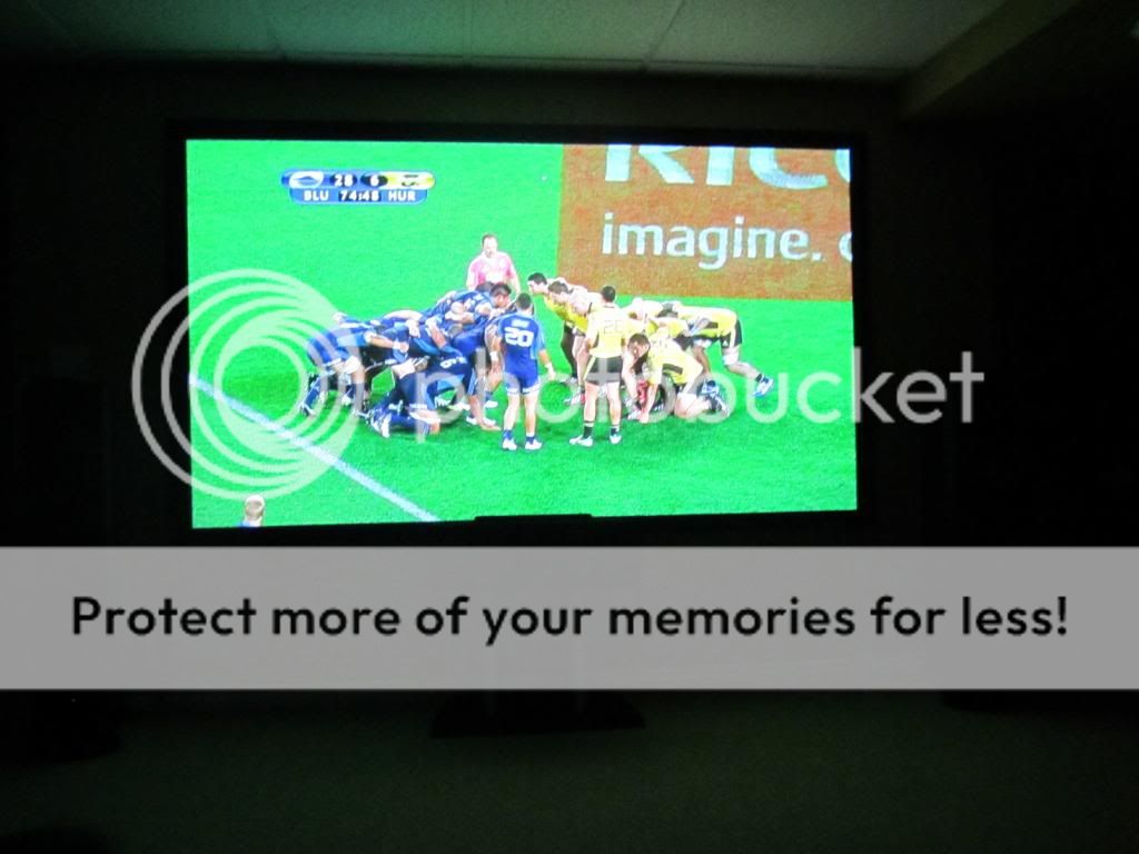

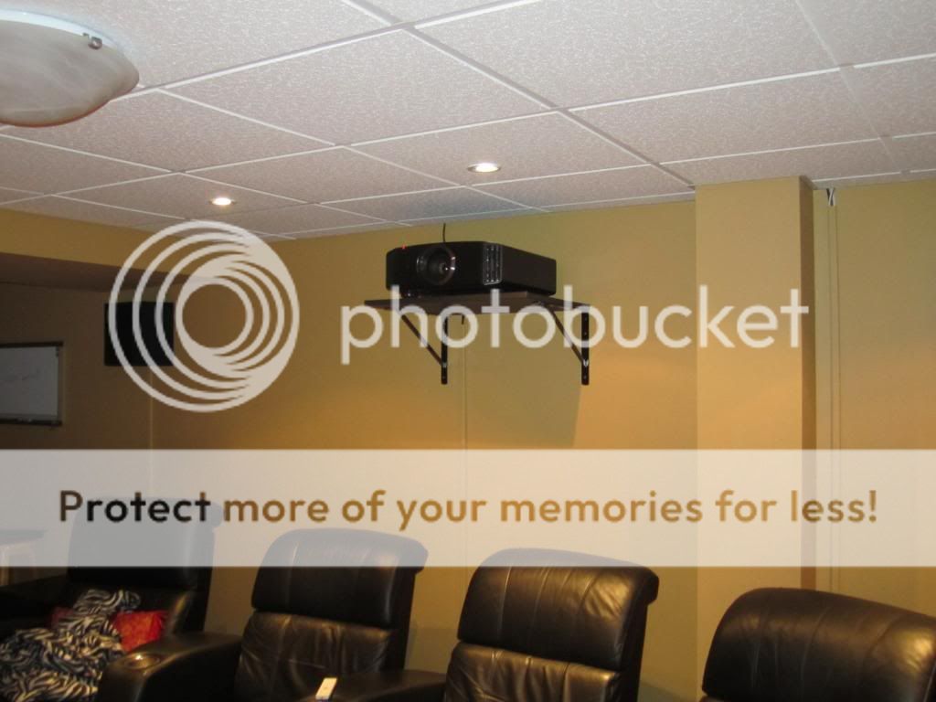

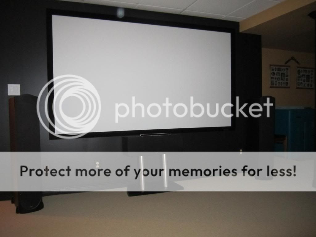

Painting the Ceiling Grid
Well, I've started to fall into the rabbits hole and I'm preparing to add a bit of black to my HT.
I started with painting the screen wall black, wow what a difference, added the painting of the telepost covers and I'm now moving onto building a couple of wing walls and covering them in black velvet. The wing walls will be placed on either side of the screen just past the speakers in an attempt to reduce reflection.
Here's what it looks like at present.
Now as you can see, I need to change my ceiling and I've purchased 2' X 4' Armstrong black ceiling tiles.
The question of the day is whether to buy black ceiling grid, use the light trap tape on the existing grid or spray paint the existing grid.
Has anybody painted their grid?

painting the grid is a bit of a pain and the flat paint will still be more reflective than the protostar flocking material.
I wrapped my entire grid with the protostar flocking material. it's easy to cut and already has the adhesive on it. It takes some time but the results are great.
http://www.fpi-protostar.com/flock.htm

No need to cut. It comes in tape form now - http://www.fpi-protostar.com/hitack.htm
My wife and I had the entire grid finished in a short time.

I almost did, turned out I like it unpainted. Reminds me of the (a) Holodeck.
I think the real trick was to paint the tiles Black bar black (dark grey/black).
