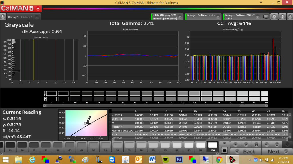

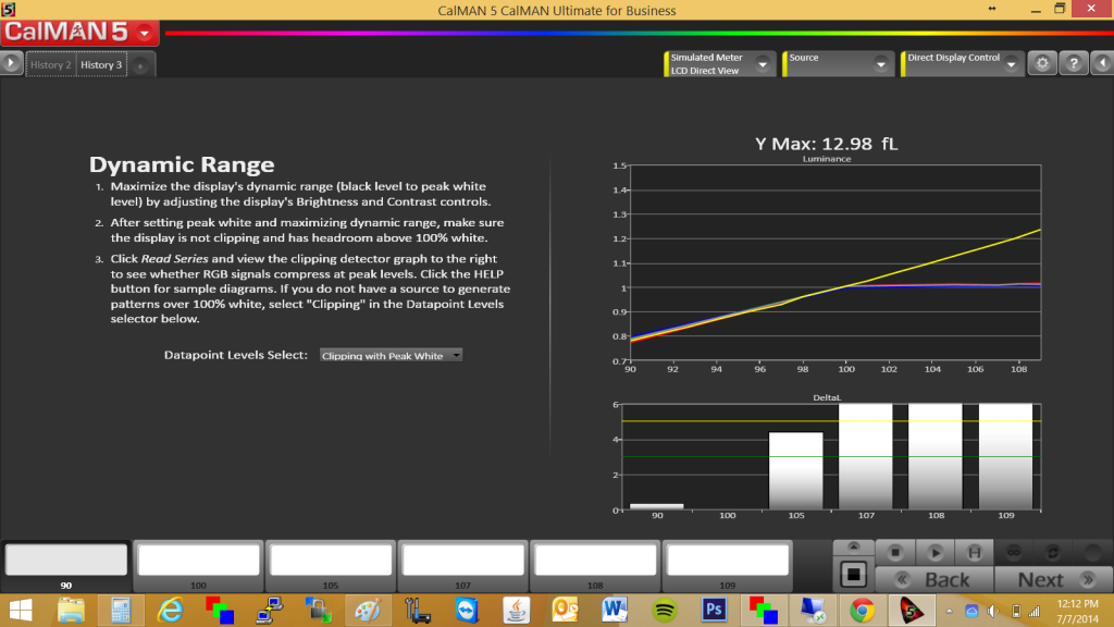

Unable to achieve proper BT.1886 gamma curve.
I believe its my meter as I recall reading somewhere that if you read 0 for black you end of with essentially 2.4 power gamma??
I'm using a gamma correction of 2.6 with dark level set at 3.
BTW I did try other correction but all had a significant dip throughout most of the middle of the range.
As you see in the before measurements the red spike was not there prior to 3DLUT.
This could be a result of a higher contrast setting -1 as I do see slight red discoloration at the top end of the white clipping pattern both pre & post calibration??
However the dynamic range measurements look good both pre & post calibration.
Grayscale & Gamma with 21 point Autocal but prior to 3Dlut
Grayscale & Gamma with 21 point Autocal and after 3Dlut
Dynamic Range with 100ire calibration but before any autocal
Dynamic Range after complete calibration
trans_lux is offline

If you know your black level (or can estimate it) you can enter it manually in the options in Calman, but with an X500 you should just aim for power 2.4, especially if you activate the DI after calibration.
Ignore any spike or dips at 85-95 unless you can see artifacts on screen, it's usually the bulb which isn't stable (it's normal, they all do that). Chances are that if you measure 95% in continuous mode you'll see it dancing around.
Manni01 is online now

post #1850 of 6013 Old 07-07-2014, 01:53 PM
trans_lux's Avatar
Location: In my theater
Posts: 1,033
Quoted: 119 Post(s)
Liked: 164
Originally Posted by Manni01 View Post
If you know your black level (or can estimate it) you can enter it manually in the options in Calman, but with an X500 you should just aim for power 2.4, especially if you activate the DI after calibration. Ignore any spike or dips at 85-95 unless you can see artifacts on screen, it's usually the bulb which isn't stable (it's normal, they all do that). Chances are that if you measure 95% in continuous mode you'll see it dancing around.
Thanks Manni. Not using the DI. I see no visible artifacts at the top end. However I do see what looks like and very well could be compression artifacts or posterization in very dark scenes. I see it primarily on Satellite and downloaded content-both of which are usually highly compressed. Does anyone know of a good pattern for posterization evaluation?
Yes I see fluctuations in the 80-95 range. Recently I have a couple major lamp flickering instances. Makes it impossible to calibrate. Tried a bunch of things to resolve. Only thing that worked was to leave it off for a couple hours. Also light output varies greatly from use to use. 12.7 flt one time then 13.8 another. 280 hours on the lamp-time for a new lamp or bad power supply
Originally Posted by curlyjive View Post
Kris,
I followed your advice and used HDMI Standard and set contrast to 0. However, using either Spears and Munsil or the AVS disc, bars 230-234 look pinkish when flashing. Lowering contrast to -2 corrects that, but then I've adjusted contrast as you recommended not to.
Any advice here?
I see the same thing. To be completely devoid of color I need to be at negative -3. Balancing the gains can help a bit.
Originally Posted by jstach500 View Post
Trans_lux, I was having a similar issue and ended up setting the JVC gamma to 2.2. The Lumagen was then better able to achieve the BT.1886 curve through its adjustments. I'm sure there is some tradeoff doing it that way, but that setting worked better than any other for me.
Thanks jstach. I did try this but it was with a previous version of Calman. I'll try again and see what happens.
Kris,
Any advice here?
I do have a meter and will be calibrating it. I always had thought a color shift in contrast meant to dial it back.
Would you say start my calibration with contrast at 0 and see if the pink is gone after? I'd guess after adjusting the gains I'd know?
That's exactly what I'd do. I have never needed to touch contrast yet, but every pj is a little different and hours make a difference.
If the bulb flickers visibly, try to use it for a while in high lamp if you're using normal, or normal if you're using high. It doesn't always "burn" evenly and switching to the other mode for a couple hours usually sets it straight for a while. There shouldn't be any reason to replace the bulb after so few hours, or if you have to it should be under warranty. The fluctuation in the upper part of the greyscale as measured by the meter at 85-95% white is usually not visible by eye, but it does show when calibrating. I just ignore it.
Correcting greyscale did remove the pink discoloration from the contrast pattern. Getting good greyscale tracking was pretty easy.
Wondering if it is better to set brightness at 0 since I'm calibrating it, or if +1 is still fine.
Gamma is not ideal. Both 2.3 and 2.4 end up around 2 in the upper mid range. Have you had any success using the Picture tone, bright, and dark gamma controls? Or do they do more harm than good?
Have you tried different default values to start for gamma? That is what if suggest. How may hours are on your bulb? I use the dark level adjustment to bring up the bottom end a bit but that's it. I have a Radiance 2041 so most of my calibration is done through that with little adjusted on the projector itself.
Kris Deering is online now
post #1860 of 6013 Old 07-08-2014, 06:39 AM
curlyjive's Avatar
Join Date: May 2004
Location: Abington, PA
Posts: 1,903
Quoted: 534 Post(s)
Liked: 246
I've tried 2.3 and 2.4. They tend to slope to lower gamma values as the IRE increase. It's a brand new unit, so the lamp break in may resolve some of this. I know i'll have to re-calibrate anyway. But I wanted to see what I could get with just the greyscale correction. I will say these are WAY better OOTB. I would even say watchable, and I'm pretty critical...hence why I calibrate right away and just redo it after break in.
I did mess with the gamma controls. They are tricky because of a lot of overlap. I ended up with a flatter response, but since I had to pull the Tone control down ti bring the midrange to 2.3, it's hard not to end up at 2.4 at the low end. In actual viewing, I'm not sure I like it better than just a 2.4 custom value.
