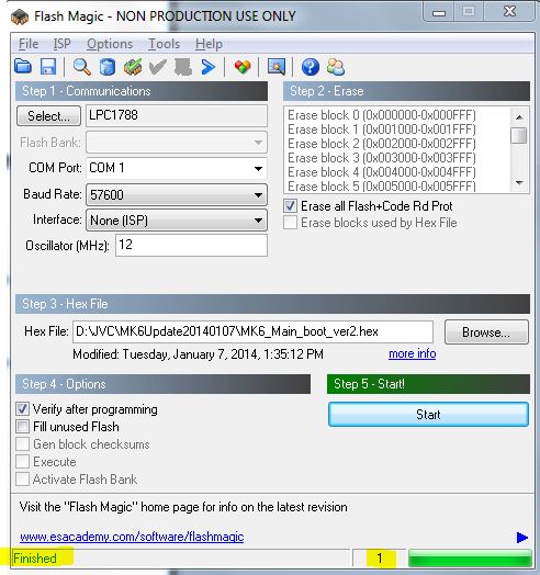

I spent some more time with the prolific USB -> serial cable that I use for my Cisco gear, the lumagen and previously flashing the JVC. changing different baud rates and tried this work-around as well without success:
http://forum.flashmagictool.com/index.php?topic=4149.0
same error with the autobaud error. It might be something with this particular application.
I decided to switch over to my Dell Optiplex 755 w/ Win 7 which has several serial ports built in. it worked perfect using the instructions.
zombie10k is online now
post #182 of 903 Old 01-14-2014, 07:57 PM
zombie10k's Avatar
Posts: 10,953
Mentioned: 71 Post(s)
Quoted: 3033 Post(s)
Liked: 3119
2nd process ran fine, the projector booted fine afterwards. I didn't realize my mede8ter was on a still frame in MvA 3D so it went right into 3D mode. I pulled the HDMI cable out (guaranteed to lock it up before), screen went blue, plugged it back in, back to the 3D image. looks like a good start. once I test the mede8ter i'll check out the lumagen 2041 I was having issues with before.
it looks like YMMV with the USB -> serial adapters, I've used this for countless setups before including flashing the JVC RS55. for some reason this particular flash software is not pleased with this adapter.
the old school serial port on my Optiplex 755 saved the day.

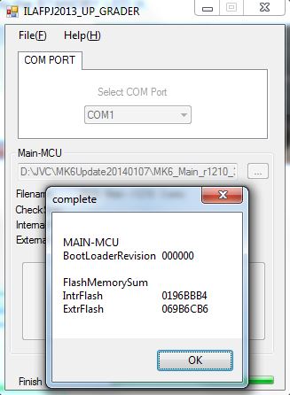

I finally managed to do the update in my X700.
Prolific USB 2 RS232 + null model cable which I use for my Lumagen didn't work so I used an old PC with a serial port (with the same cable).
As mentioned before, when I tried the update with the Prolific (Win 8.1 64bit) I got the message ''cannot send data'' (not the ''autobaud'' one) and the PJ remained in programming mode (and couldn't get out even with power reset).
When I tried with the other PC I got the ''autobaud'' error and I freaked out.
I then tried to do again the procedure which gets JVC in programming mode (although it seemed to be already in programming mode / stucked in it actually - as mentioned above) - (power cable off - input button - power cable on) and magicflash ''waked up'' and performed the flash.
2nd stage flash, was the easy one.
I run some tests @ 24 - 60p with no problems (I haven't tried anything with the original firmware).
I didn't have the time to do 3D check.

a failed update could leave the projector in a disabled state. It worked perfect with my serial port built into my Dell desktop but after the issues I had with the serial converter (that previously worked fine w/ my RS55), I would be hesitant to try any combo that JVC didn't specifically list in the update document.
imo, a real serial port is the best guarantee to make it work, worry free.

Liked: 1115
Success!
I got my Tripp-Lite Keyspan USB-to-serial adapter (the one JVC recommends) and a Tripp-Lite null modem cable from Amazon today. I used them with my 2012 15" retina MacBook Pro running Windows 7 x64 through Boot Camp and the upgrade finally went off without a hitch.
Things of note:
1. The Startech adapter that's been recommended a few times did NOT work with my configuration. It might work with yours but it's easier to avoid headaches and buy the one JVC recommends.
2. Make sure you know what COM port your adapter is using; you'll need to know this for the first part of the update. You can see this by expanding the entry under Control Panel > Device Manager > Ports (COM & LPT). Mine was COM4 FWIW.
3. Make sure the baud rate that the first firmware update program uses (57600 specified by JVC) and the baud rate specified by your adapter's settings match. Again, go to Control Panel > Device Manager > Ports (COM & LPT), expand the tree, right-click on your device, click "Properties," click the "Port Settings" tab, then select 57600 from the "Bits per second" drop down (thanks Seegs!).
4. Don't forget to install the drivers for your adapter!
Other than that it was easy. In fact, if you have a good adapter, you shouldn't have any trouble. IMHO don't waste your time with the Startech adapter.
Schwa is online now
