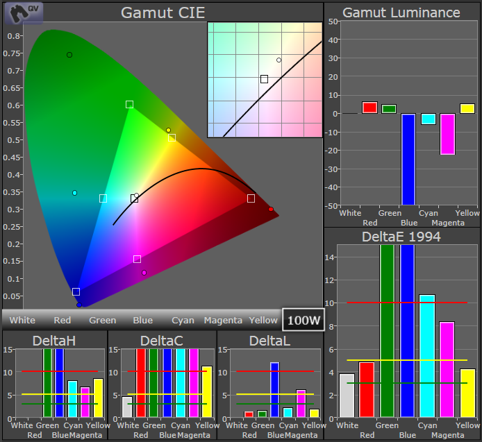

Currently I have an LS-100D and this is it's native gamut:
I'd say it is highly oversaturated and Rec 709 content looks cartoonish when viewed. So even if this were true, no one would actually want to view the content like this to gain a relatively small amount of contrast.

Originally Posted by Debonaire View Post
TI makes the drivers and has a color remaping algorithm for use with LED. TI is very much at "fault." Their draconian business model only allows certain configurations that you must design around.
To make it simple, TI researched(outsourced) how we perceive color in order to expand color beyond what REC 709 define in order to fake cinema gamut. They then use a table of values which goes beyond what you did by over saturating alone.
The result isn't small. LED has about a quarter brightness lost in the spectrum outside the REC gamut.
The only thing that making the primaries brighter would do is increase on/off contrast ratio on the high end (white), not the lower end. Ultimately I think most people would rather have their on/off contrast increased by lowering the black floor. This is also the problem with a white room. Yes, a white room with no lights has no effect on on/off contrast ratio as it will raise both white and black equally BUT this in turn DOES raise the black floor which is what you want to avoid to get the rich contrasty image most people want. A white room will also destroy simultaneous contrast (though an improperly setup black room can as well) as Mark has already pointed out. Mark and I have a ST100 screen which is fantastic, but it also creates its own problems in regards to ANSI or simultaneous contrast due to its inability to reject light from different angles. You better be VERY sure you have exceptional light control if you want to use a screen like this.
