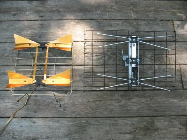

Philips MANT510 gain on high in North facing corner window
2.1 (R 50) = 40
4.1 (R 34) = 0
5.1 (R 47) = 0
16.1 (R 44) = 33
24.1 (R 40) = 40
36.1 (R 35) = 30
DB2 in North facing window
2.1 (R 50) = 22
4.1 (R 34) = 10
5.1 (R 47) = 10
16.1 (R 44) = 12
24.1 (R 40) = 20

DB2 with Motorola BDA S1, 15db amp at @2.5db noise max
2.1 (R 50) = 44
4.1 (R 34) = 19
5.1 (R 47) = 21
16.1 (R 44) = 20
24.1 (R 40) = 42

We can see the interaction of the antenna elements and amplifiers in the above numbers.
You have to capture a minumum amount of signal with the antenna elements before the amplifiers can work to boost and stabilize your signal.

For the record, the ANT110 brought in 3 channels weakly.
The MANT510 brought in 4 channels strongly.
The DB2 unamped brought in all channels but some rather weakly.
The DB2 amped was topped only by the CM4220 on the roof witht he CM7777 amp.

Hooked up the RS 15-1634 to the Vizio tuner.....which is an amplified omni-directional unit. It is a UHF only antenna....which did not pick up any VHF channels at my location.
It performed similarly to the DB2 unamplified. Locking all stations with video but breakups on my 2 weakest stations.

Radio Shack 15-624 Double Bow Tie
This one is an excellent performer on UHF. Its a bit bigger than I imagined. As you can see the bows are a bit damaged....they seem to be somewhat fragile not brittle but bendable, however it still performs great with the bent bows.
I mentioned its quick performance check earlier. Here is the blurb...
I hooked up the RS Double Bow to the Vizio and set it on the not so hot spot, Oppo, and it picked up everything except my weakest station. With heavy breakups on my 2nd weakest. Excellent.
Here it is next to the DB2 for comparison.
I read somewhere, that you could improve performance by cutting off the twin lead wire and directly attaching a 75ohm matching transformer balun to the feed lines(where the twin lead attached to the antenna).
EDIT: Here it is, tigerbangs at the High Def forum.....Radio Shack 15-624 indoor UHF antenna
PS - Sorry about the shameless self promotion. [embarassed]
EDIT 2: I also heard you could make the bows bigger with aluminum foil to increase performance.

EV, I saw on the first page or so of this thread you gave a big thumbs up to the old-school Radio shack bowtie antenna like the kind that you would clip onto a dipole.
I've seen other threads on this forum talking about making your own antenna and so I was wondering if a couple of those RS bowties could be daisy chained (just connecting their wires together directly) and backed with an aluminum foil covered board reflector to form a homemade high power antenna? Would connecting/twisting their wires together work or would something more have to be done?
I would probably start off small with just 2 to mimick the two bay ones but if it did ok I might go bigger. I just dont wanna go buying all this stuff if it has little chance of working...especially when I could shell out a little more cash and get one that's professionally designed.
Since there's wire mesh behind my walls (plaster)...i wonder if i could just tack up some of those bowties on my wall (assuming the wall is facing the right direction) and have the wall itself work like a reflector?
