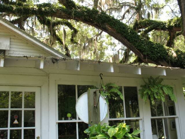

Here is a pic of the tiny DB2 (pointed North-East at the Charleston tower cluster at 45 miles) mounted on the chimney between the giant tin roof reflector and the giant oak tree.
EDIT: Sorry about the pic, the DB2 is barely visible just to the left of center on the chimney breaking the roofline. Ill take a better pic and post it below. Its a good pic to get your evironmental bearings of the location though.
And a pic of My First Attempt at a Coat Hanger Antenna.
