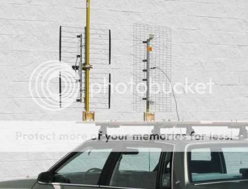

I did some tests to compare the original stock 4221 with the stock 4221HD. The 4221 did quite well compared to the 4221HD, but with a few simple modifications, the 4221HD did much better:
Here is the post with more information:
http://www.digitalhome.ca/forum/showpost.php?p=1167870&postcount=221
In order to see all of the photos (like the balun position and the two antennas on my car) in that post, it is necessary to login and refresh(F5).
If you can not measure it, you can not improve it.
Lord Kelvin, 1883

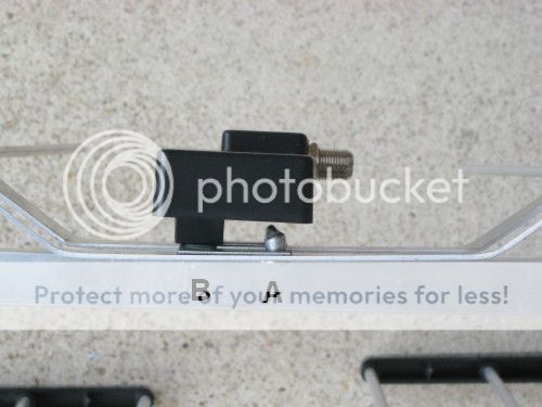

Your link takes me to page 2 of that thread; you must mean post #18. His photos do indeed show aluminum as a gold color. It must be a problem with the color balance of his camera. His 3rd photo shows the phasing line strips flattened to move the balun away from the square support tube. CM bent the strips down so that the antenna would fit in the box, but it makes the coupling between the strips and the support tube bad enough to harm the performance of the antenna. His photos do not show the spacers. I suggested the spacers in my post #221 because I noticed that while the balun was mounted at the midpoint between the two inner bays, its electrical connection was NOT at the midpoint, which meant that the two inner bays were not being fed in phase.
The link that I gave above takes you to my post #221, but you must login to that forum and hit Refresh (F5) to see all of the photos, including the balun, which I find to be a troublesome quirk of that forum.

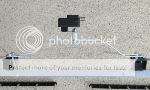

I examined how the balun box was attached to the strips and noticed that although the rivets that attach the balun to the strips were centered between the two inner bays (point A), the effective electrical connection was not centered (point B). This meant that the two inner bays were not being fed in phase, and therefore all four bays were out of phase, which would reduce the gain.
I added nylon spacers between the strips and the lugs on the balun box using the 8-32 hardware that I had, moving the balun to the front. To duplicate the mfg method, you could use metal spacers and long aluminum pop rivets. If you decide to use the spacers, flat strips would probably be OK, but I haven't made measurements. I left the strips in their bent form and just turned them over for the tests so that I could return the antenna to it stock condition for further tests, but the balun sticks out too far to suit me. Inserting a thin insulating strip between the balun tabs and the feedlines WOULD NOT work, because it would act like a coupling capacitor at UHF:
TEST CONDITIONS:
OTA signals are constantly changing in strength, so I knew that I wouldn't get reliable readings if I made measurements before and after modifications. And, I don't have a constant level output signal generator to make antenna range tests like mclapp, so I decided to make rapid A/B comparisons between my 4221 as a standard antenna and the 4221HD as the test antenna.
Recently, I made some quick comparisons between the 4221HD and the DB4e. The modified 4221HD and the DB4e have about the same gain, but further testing would be needed for better accuracy.

In my "CM4221HD Hacked" 4nec2 model, I included the Nylon Spacers between the Feedlines and the Balun, where i presumed a length of 0.5-inch (and shouldn't make any significant difference if 3/4 or 1-inch long)....as shown in SECOND picture you posted above.
So "CM4221HD Flip Balun" (YELLOW) has the insulating tape installed between the Balun and the FLIPPED Feedlines, whereas 'CCM4221HD Spacers" (CYAN) uses a (0.5-inch??) Nylon Spacer instead and appears to be the (PREFERRED) configuration I modeled, rather than "CM4221HD Flipped Balu"n (CYAN).
Only remaining confusion I have is the FIRST picture above shows some insulating tape between the Feedlines and the Balun....which appears to have been applied to an UNMODIFIED CM4221HD. Am i correct in presuming that this prototype configuration was NOT included in the reported OTA test???
"Flip balun" is like shown in post #95 on that thread. The bent feedlines are now bowed out, but the balun is now inside the lines. I did each of the modifications as suggested by the OP, one-at-a-time, to see what difference each modification made. I did not make the reflector smaller; I didn't think that was a good idea, and it would make it impossible to restore the antenna to it original stock condition.
There is NO insulating tape between the balun and the feedlines; it wasn't suggested by the OP to my knowledge. It wouldn't do any good because you would have capacitive coupling between the metal tabs on the bottom of the balun box and the feedlines, which would still maintain the off-center feed at point B.
The purpose of the spacers is to get the balun away from the feedlines so that the capacitive coupling would be minimized and the feed point would be at point A. Using the spacers is my idea that I added to the OP's mods to feed the two inner bays in phase, so I feel that it is a preferred additional mod, not an alternative to the mods suggested by the OP. "Flip balun" is probably an ambiguous misnomer; better to call it "flip feedlines" so that they are moved away from the square support tube. After that mod, I decided to move the balun out to the front to make it easier to connect the coax, and finally I added the spacers.
