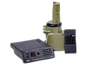

Does anyone know if there is a cheap wireless rotator for an attic antenna? I've searched but cannot find one.
This would basically be a one-time use device in order to adjust the antenna without having to keep running up & down stairs & crawling in the attic. I could rotate for maximum signal strength & then forget about it. Battery powered or AC makes no difference.

Maybe this one, seems reasonably priced
http://www.walmart.com/ip/14554636?w...599990&veh=sem

I wonder if Mike99 means no wire between the controller and the rotor itself, as opposed to no wire between the remote and the controller?

One of these might be cheaper: http://www.amazon.com/b?ie=UTF8&node=979930011

Correct. I guess I should have been more clear. I would like wireless all the way around in order to make installation easy. I have power in the attic so the rotor could be powered from the attic. Sending power & control signals up the coax might be feasible. Fishing a separate cable from the first floor through the second floor & then to the attic would be a nightmare to do.

Get one of the IR-remote controlled rotators above, then get a set of wireless IR remote extenders to relay the remote commands up to the attic.
