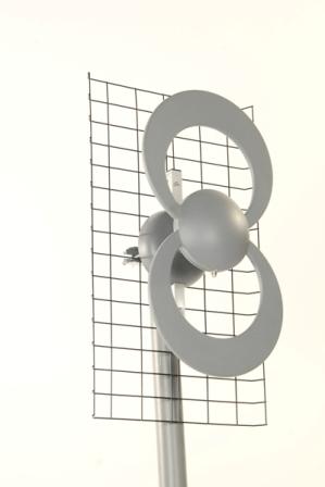

Antennas Direct’s Clearstream2 Antenna Available for Pre-Order
St. Louis-based antennas maker Antennas Direct announced its new, ultra-efficient, compact, digital TV antenna, ClearStream2, will arrive June 30. Orders are being taken now.
ClearStream2 is Antennas Direct’s latest model of digital TV antennas, which are optimized specifically for the 2009 digital conversion.
“The ClearStream2, which is the first in a series of ClearStream DTV antennas, is unmatched in size and performance,” said Antennas Direct President Richard Schneider. “Demand for ClearStream2 is high because of its strength, reliability and small form.”
The first DTV antenna created with the latest simulation software and test equipment, the ClearStream2 is designed to receive digital, over-the-air broadcasts, with a range up to 50 miles. Its wide, 70-degree beam width allows it to capture signal from towers spaced far apart, and its patented, tapered-loop design is 50 percent smaller than previous models.

post #8346 of 16739 Old 06-17-2008, 12:47 PM
johnied's Avatar
Posts: 232
Originally Posted by EscapeVelocity View Post
Goodness thats one UGLY antenna. :P
On a serious note I sure would like to see the innards of those loops.
I bet they are similar to Winegards SS 2000 with its fractal elements.
Just thinking out loud.
John
John
Heh, it was probably designed for motorhomes whose owners are big NASCAR fans of car #8 (or buy 2 for#88).
I bet its just stacked uhf loops with a preamplifier. Up to 50 miles ? Yeah sure, during a good troposphere event.
300ohm is offline
How does an new model of antenna that is only in the pre-order stage already have a reputation for reliability?
Tobias Ziegler is offline
post #8352 of 16739 Old 06-17-2008, 10:59 PM
300ohm's Avatar
Join Date: May 2008
Location: Somewhere in Delaware
Posts: 1,804
Well, maybe it doesnt even have an amplifier in it. Two small steel hoops and a piece of fencing and a metal pole IS pretty strong, reliable and small .
They could also claim its non-allergeric.
300ohm is offline
post #8353 of 16739 Old 06-18-2008, 07:45 AM
nybbler's Avatar
Posts: 690
I bet it's not; I bet what you see is what you get. It's similar to a biquad design (common at 2.4Ghz) but with round loops instead of squares. A biquad has pretty narrow bandwidth, maybe the fancy tapered loops increase it... or maybe they don't and their "patent" is a design patent.
nybbler is offline
