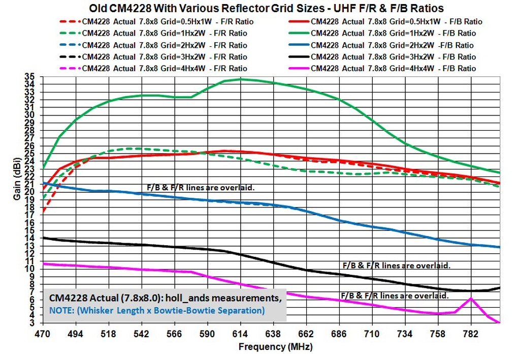

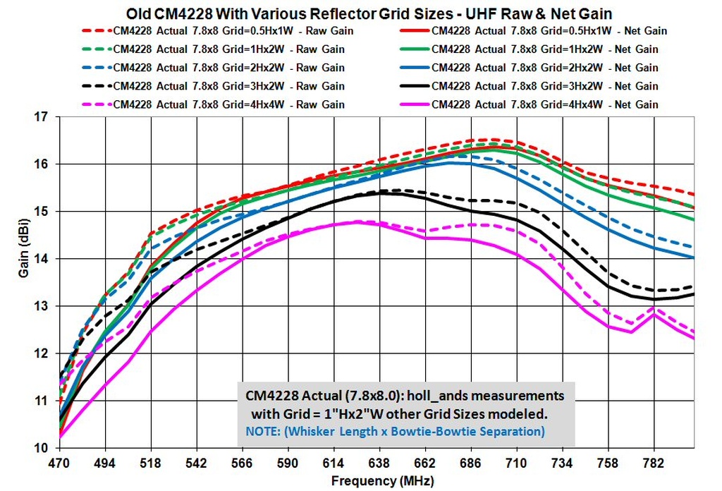

CM4228 Analyzed to Determine the Screen Reflector's Grid Size Effectiveness:
I wondered what was the most effective Gird Size in a Screen Grid Reflector, esp. given that the Wind Resistance
was HALF as much if the Height and Width were both doubled in size. The fol. results "should" be typical for
many other 4-Bay and 8-Bay Antennas....
So I added Grid Size Effectiveness Charts for 0.5"Hx1"W, 1"Hx2"W, 2"Hx2"W and 4"Hx4"W:
http://imageevent.com/holl_ands/multibay/8bayrefl/oldcm4228wrefl
ERRATA: Finally found suspected error in above Chart for F/B Ratio with 0.5"Hx1"W Grid size....
When I copied Raw Gain Spread Sheet for F/B & F/R, it was still pointing to Net Gain vice F/B Ratio data column.
Updated Charts are shown below. 4nec2 Charts are NOT affected.
Also added 3"Hx2"W....which nicely fits in-between plots for 2"Hx2"W and 4"Hx4"w.
Plots for 1"Hx1"W and 2"Hx4"W are not included, since they were within a few tenths of a dB of 1"Hx2"W and 2"Hx2"W respectively.
The spacing of the HORIZONTAL wires primarily determine performance, since Vertical Wires have only minimal effect on Horizontally Polarized signals.
REVISED NARRATIVE:
Added Grid Size Effectiveness Charts for 0.5"Hx1"W, 1"Hx2"W, 2"Hx2"W, 3"Hx2"W and 4"Hx4"W.
Raw Gain was about the SAME, except (as expected) some loss with and about 1-2 dB LOSS for 4"Hx4"W.
Front/Back Ratio was much better with 1"Hx2"W than 0.5"Hx1"W and progressively lower for 2"Hx2"W, 3"Hx2"W and 4"Hx4"W.
Front/Rear Ratio was about the SAME with 1"Hx2"W and 0.5"Hx1"W and progressively lower for 2"Hx2"W, 3"Hx2"W and 4"Hx4"W.
Old%20CM4228%20with%20Var%20Refl%20Grid%20Sizes%20-%20UHF%20Raw%20and%20Net%20Gain.jpg
Old%20CM4228%20with%20Var%20Refl%20Grid%20Sizes%20-%20UHF%20F_R%20and%20F_B%20Ratios.jpg

ERRATA to Post #16205 above: Finally found suspected error in above Chart for F/B Ratio with 0.5"Hx1"W Grid size....
Updated Charts are shown above. 4nec2 Charts are NOT affected.

Originally Posted by rdcollns View Post
Would a change in the gauge of the grid bars affect this?
Wire Size for Screen Grid Reflector isn't very important as long as it's in the "realistic" range of AWG18 to say AWG8.
And FYI for other Antennas Modelers: Surface Patch (alternative option) doesn't even HAVE an entry for the solid surface thickness....
