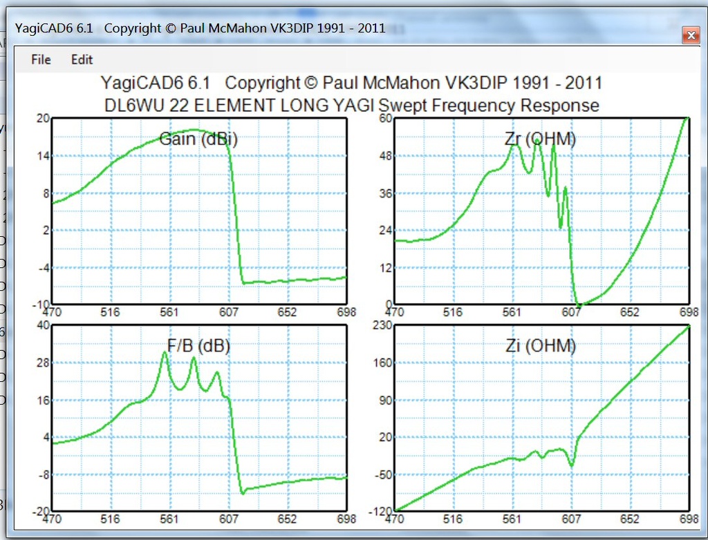

NO.....see above explanation....even a long Yagi or Corner Yagi will provide -3 dB bandwidth of about 5-6+ channels, with significant interference at twice that bandwidth, i.e. 5-6 channels away from Ch30.
Fol. example shows the extent of the problem, Rescaling DL6WU 22-Element Long Yagi from 432 MHz (Ham Band) to 569 MHz (Ch30). [Using a FOLDED Dipole and Re-optimizing would yield a 300-ohm Antenna.] Although it is very common for Yagi's to experience a rapid frequency roll-off on the high frequencies, they typically have a fairly slow roll-off on the lower frequencies:
Technical Info re Yagi's designed per DL6WU's formulas and look-up-tables can be found here, bearing in mind that they are for 50-ohm or 200-ohm (with 4:1 Balun) Antennas typically used in the Ham Radio Bands and hence are NOT Optimum for TV Bands:
http://dpmc.unige.ch/dubus/9102-4.pdf
http://www.qsl.net/vk2kfj/DL6WU.html
DL6WU's empirically derived design charts have been embedded into numerous on-line (e.g.K7MEM) and downloadable Yagi Calculators, including (FREEWARE) YagiCAD, which I used to generate the results shown above, after selecting one of the higher Gain Examples that came with the program.
I have a Ch30 "Single Channel" Optimization running overnight for a big Corner Yagi....based on a Rescale of it's Ch14 cousin, it might not have as rapid a roll-off on the high frequencies....
