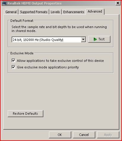

Awesome! Can you post a picture of the front of your receiver or the menu with the Khz you are receiving. Here are some examples of the pictures I would like to see. I wonder if you are getting any different values.
http://www.avsforum.com/avs-vb/showt...4#post14545064
Okay here they come
Attachment 118743
Attachment 118744
I'm very satisfied with the Yamaha RX-V1800
Jesper
jespermart is offline

Originally Posted by jespermart View Post
Okay here they come
Attachment 118743
Attachment 118744
Jesper
Ok this is concrete evidence that the RX-V1800 does not have the EDID bug that the RX-V663 and the RX-V863 have. I bet the RX-V3800 and the new x900 series don't have the bug either.
I think that your only hope of fixing this problem is to buy the Gefen device if you have an RX-V663!
Jespermart,
What operating system are you using? Is it Vista?
It's Vista 64 and Realtek HDMI 2.03
