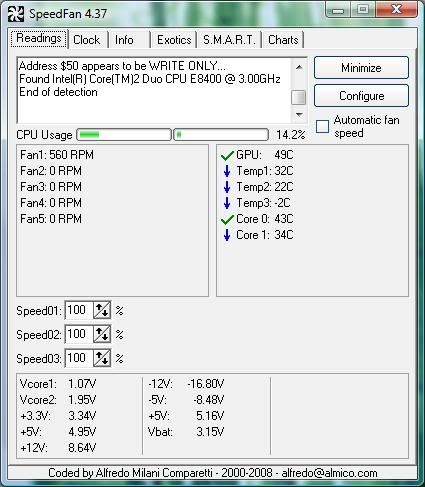

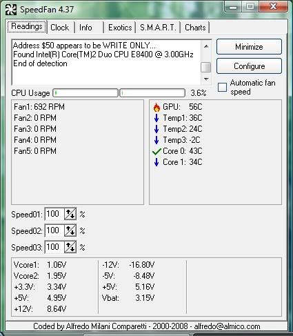

Here's a snap of speedfan running on my e8400 in an Antec Sonata III with the Scythe Shuriken. The case fan in the Sonata was set to the middle position on the fan speed switch.
I also have 5HDD's and a BD-ROM drive in the case.
This reading is under no gpu load, but I was installing applications in the background.
Cheers!

10K, have you tried different temp measuring apps?
See if you get the same readings, with NVIDIA system monitor, and pc wizard 2008.
farbox is offline

Both taken at basically the same time. I was reshaping my raid5 in a linux virtual machine when I took this shot so moderate cpu use on 1 core and some serious disk use across the 4x1.5T disks.
10k is online now

10k,
Your GPU temperature is 10C greater than my GPU temperature and I have my case fan set at "slow". Perhaps I will stay with the stock Intel CPU cooler for my E8400.
FYI - a Speedfan config file for this board can be found in this renethx post:
http://www.avsforum.com/avs-vb/showt...1#post15194481
Does anybody know why this board reports +12V at about 8.7V in the various monitoring applications? Can a calibration factor be applied so it reads the proper voltage? - The voltage is correct when viewed in the BIOS.
Tim
