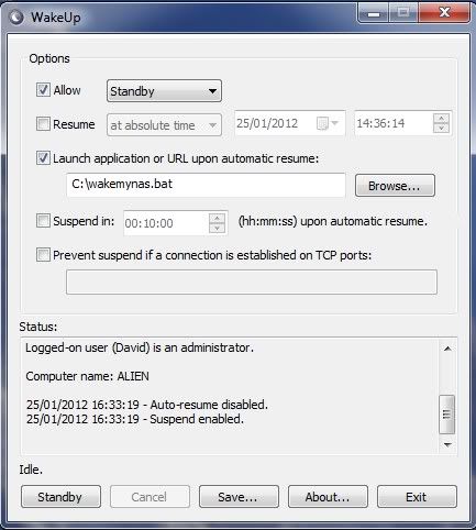

I put the mc-wol.exe in C:\\ along with wakeup.exe. I then created a .bat file containing the following line:
c:\\mc-wol.exe XX:XX:XX:XX:XX:XX
(where the X's are the NAS MAC), called it 'wakemynas.bat' and put it in the same directory as the others. Clicking on the bat file will run mc-wol and send the magic packet. Open WakeUp and tell it to launch the bat file when the HTPC comes out of sleep to trigger the magic packet. Click x to close WakeUp and it will go to the system tray. Right click on the systray icon and check both run and minimise at start-up.
WakeUp 1.7: http://noeld.com/download/wakeup.zip
Wake-on Lan 1.0: http://www.matcode.com/wol.htm
Seems to work seamlessly but I am all ears if anyone has a better suggestion!
