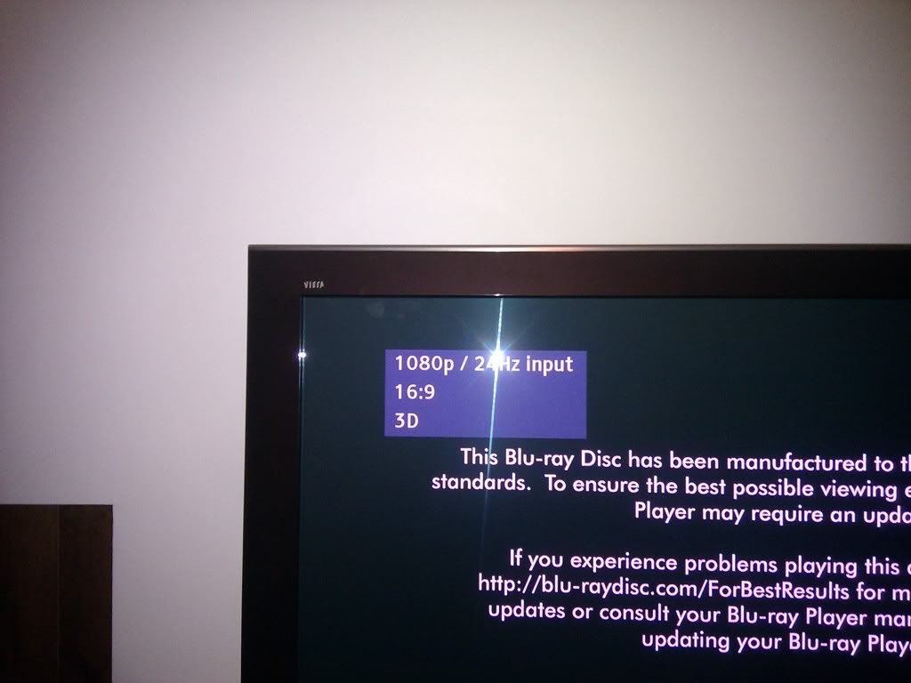

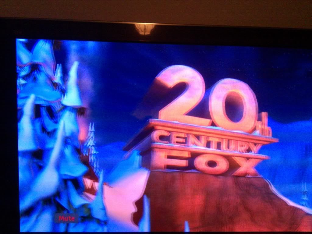

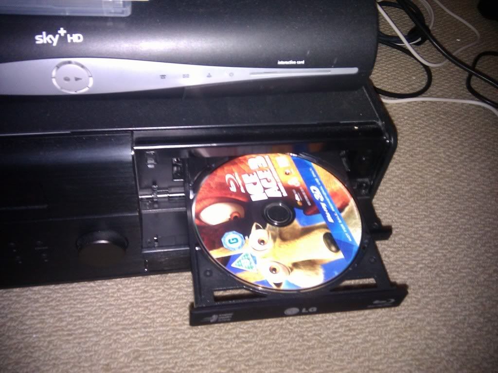

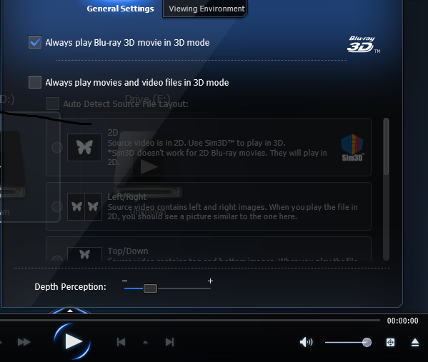

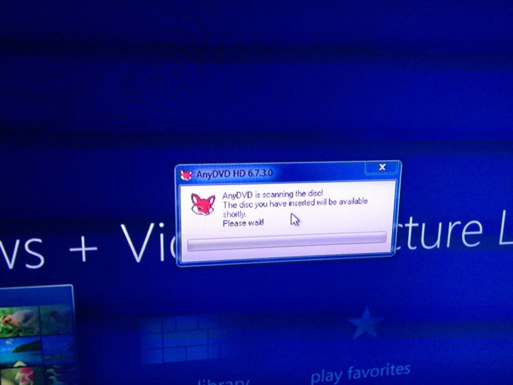

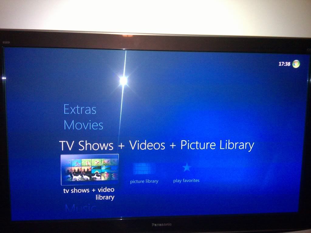

Here is the config on the Nvidia Software. PC is connected to TV via HDMI 1.4 cable:
Driver is 8.17.12.6099 Nvidia GeForce GT 430
Here is the config in the Arcsoft TotalMedia 5 Software:
Start up Media Center:
Put in 3D Blu Ray:
AnyDVD Scans the disk:
TV Switches to 3D Mode automatically:
Select 3D mode on the blu ray and put Panasonic glasses on:
Watch the Film
Hope this helps in some way.
